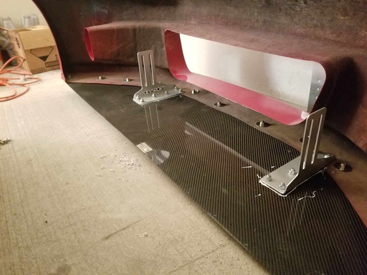

Devsport splitter mount fastened to the splitter and bumper

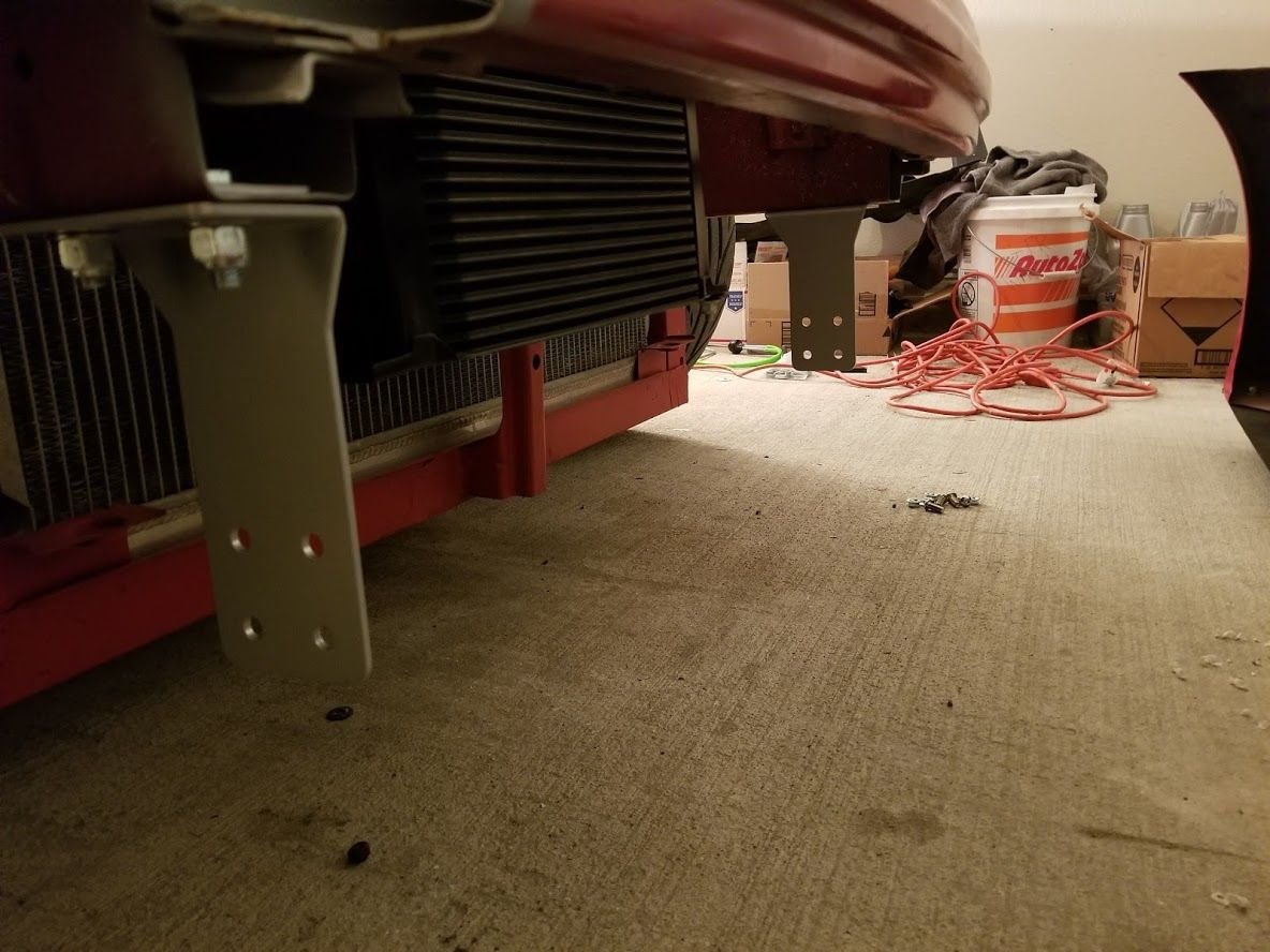

Frame mounts:

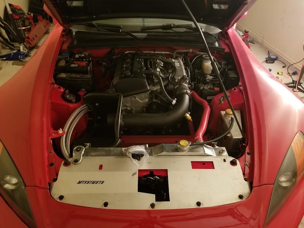

I finished up the oil cooler install and decided to put the engine bay (mostly) back together. I still need to come up with a mount for the K&N filter box.

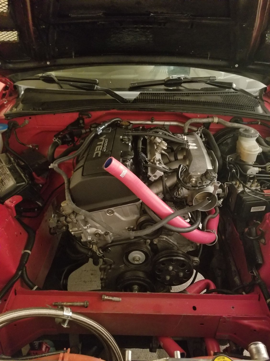

Good news: tail light wiring is corrected and working properly. The bad news is I lost oil in the engine and spun a bearing. I pulled the engine this weekend and it is now being shipped to InlinePro for a fresh rebuild.
Engine about ready to pull

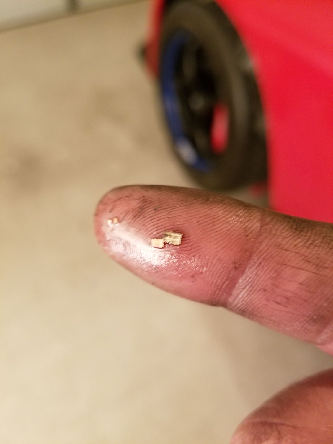

Drained the oil and found this..

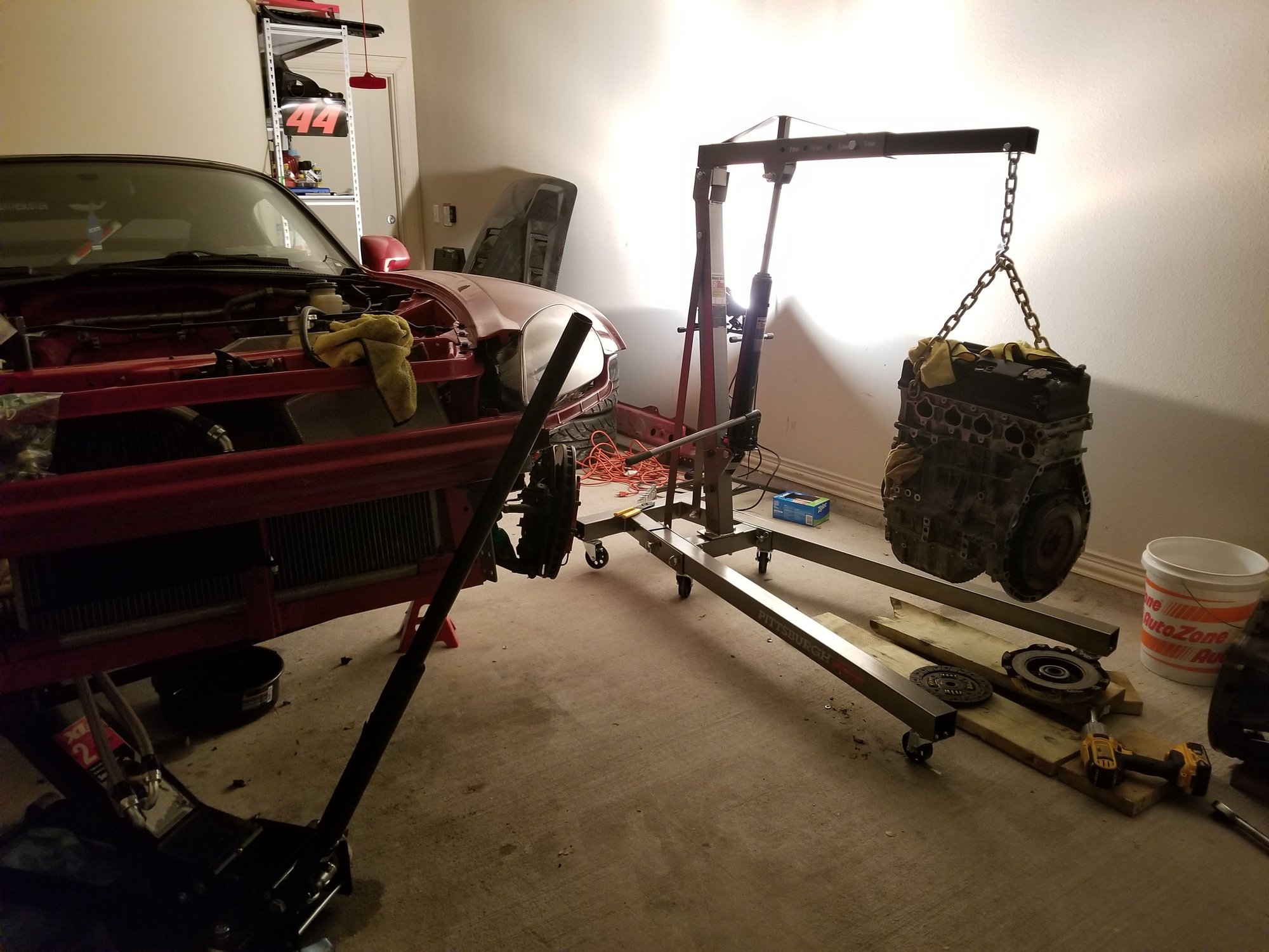

Engine out of the car and stripped down, ready to be loaded on a pallet and shipped out
I dropped the engine and transmission out the bottom with the front subframe. It was quick and painless but I certainly don't want to make a habit of it InlinePro quoted 3-4 weeks turn around, but I do have some things to work on in the interim.

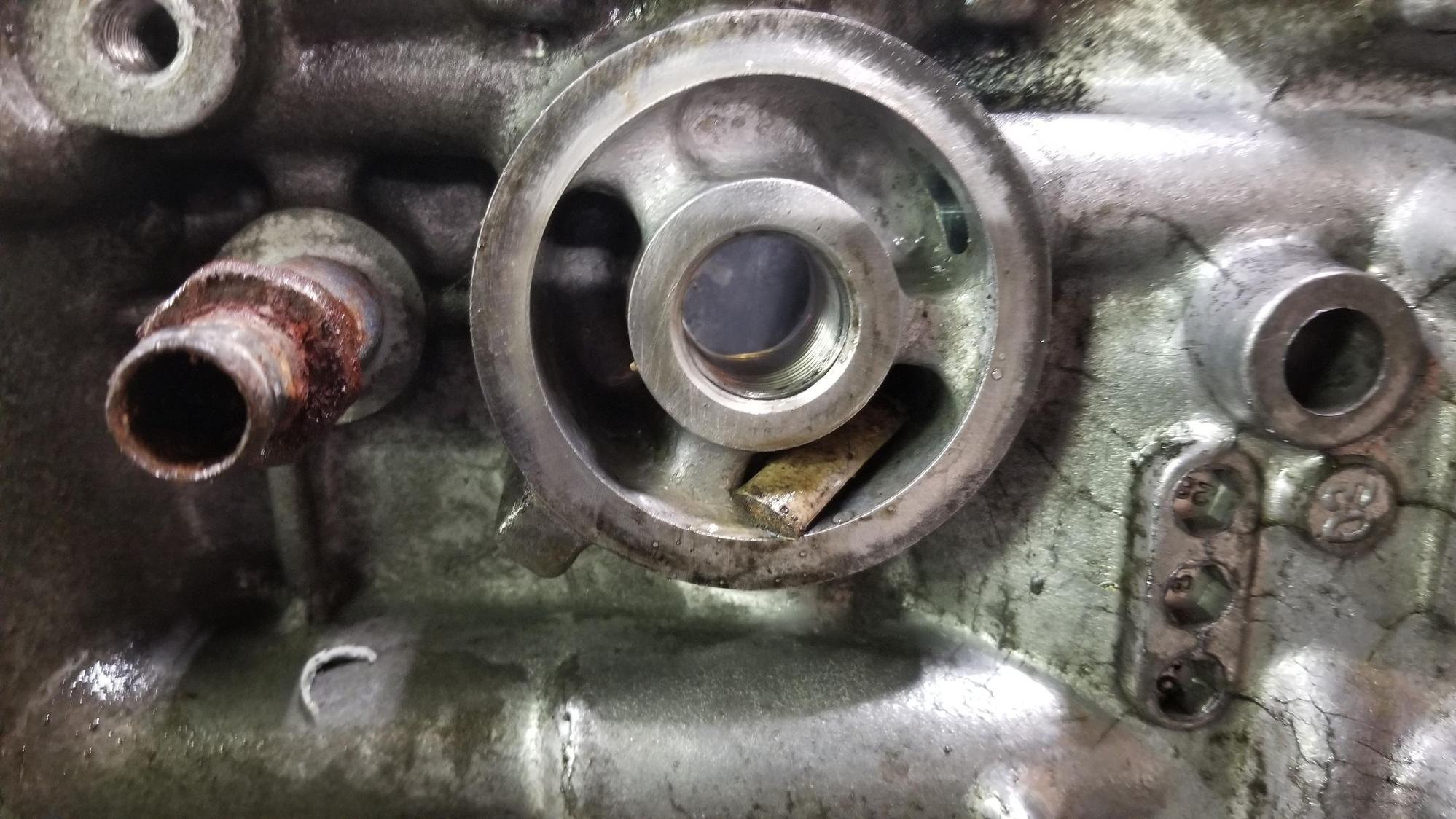

InlinePro have finished tearing down the engine and made some interesting discoveries. To begin, there was a cigarette butt where oil should normally be entering the factory oil cooler.

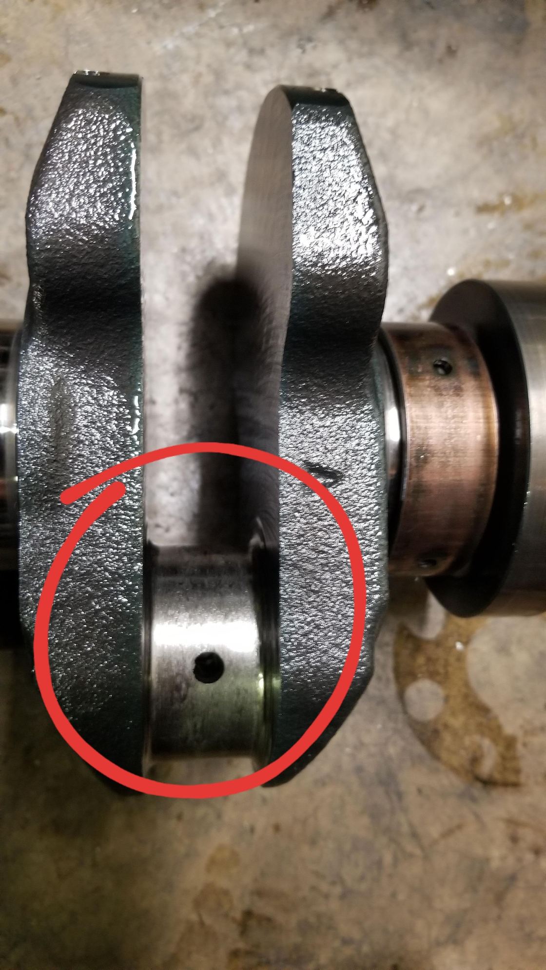

As I suspected, one of the rod bearings had spun.

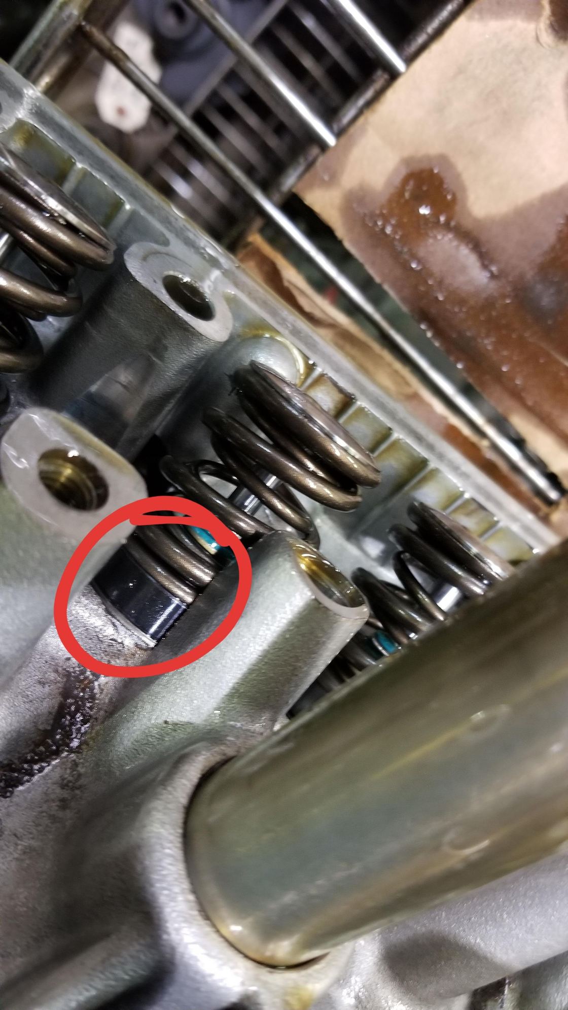

Another interesting discovery: the engine had Ferrea B-series valve springs with spacers on the bottom of them. It also had aftermarket connecting rods but one of those was damaged, so will be going back to stock.
WTF?!?!?! That's definitely a surprising and unexpected discovery - and not at all in the slightest good sort of way.

[QUOTE=mt.nichols;24688424]InlinePro have finished tearing down the engine and made some interesting discoveries. To begin, there was a cigarette butt where oil should normally be entering the factory oil cooler.
IDK, that is strange and make me wonder if it was intentional.
The joys of buying someone else's project
Originally Posted by stock06
Hello Matt,
Real nice looking car!
Michael
Plano TX
I'm confident there's no way a cigarette butt could be in that part of the engine unless it was purposely placed there. Who put it there? Who knows..
