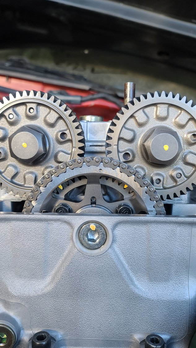

Removed the valve cover to check the timing. This looks like it may be off but if I'm honest, its hard for me to tell..

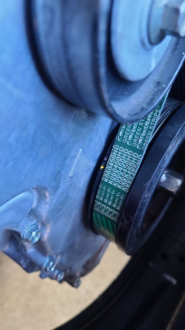

Another angle per @Billman250 's recommendations in another thread.

Was #1 at TDC, when you took the pics? Don't assume that it is just because everything else lines up.
Even if it was off by a tooth, it should run. Try changing the crank and/or cam sensors. Check that the male pins in the sensors/connectors did not get bent over. If it still does not run, then you may have an open or short in the engine wire harness? The electrical service manual gives details on pin configurations and sensor troubleshooting.

I agree. It may be 1 tooth off but it would still run relatively well. The fact it won’t run at all points to some electrical problem that is telling the engine to do the wrong things.
only other thing I could think of. Has the new motor run correctly at all. Did they use the correct cam and crank triggers. If they used the late ap2 trigger wheels they are different than the ap1/ap2. And the exhaust cam trigger is different. Just a thought.

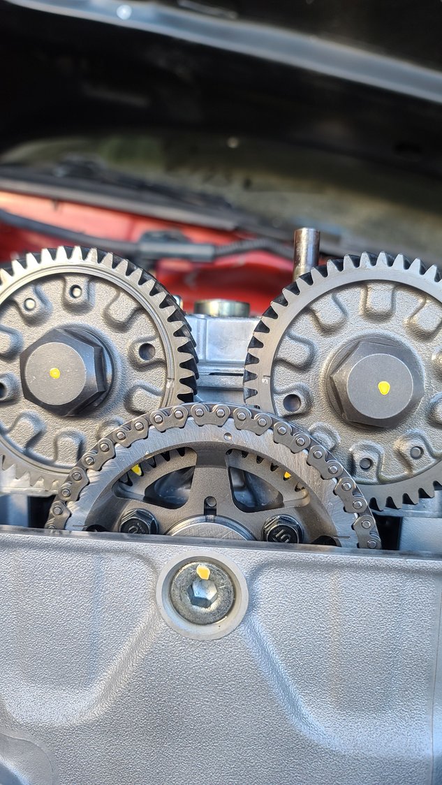

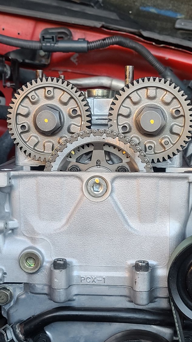

This might be a better angle. I realized the front gear wasn't quite level with the cylinder head when I took that picture.
Both of the cam position sensors are brand new, OEM Honda parts. The only question mark is the pins on the intake camshaft.. the plug is smashed but it still plugs in. It just doesn't "snap."
I've checked the grounds with a multimeter but that's about it. Does anyone have a copy or know where I can get a copy of the ESM?

Are you using an ap1 engine harness with 2 cam sensors and the crank sensor with the lead attached to the sensor
late ap2 has 1 cam sensor and the crank has no lead with plug directly on the sensor.
If it was a late f22 block and they mixed parts or ordered wrong part number cam/crank triggers it would cause what you are experiencing.

InlinePro say the timing looks dead on and that all trigger wheels were reused. I'm going to check the camshaft trigger wheels today to be sure that they are correct and tight. I obviously can't see the crankshaft trigger wheel easily so I'm just going to trust them on that one.
