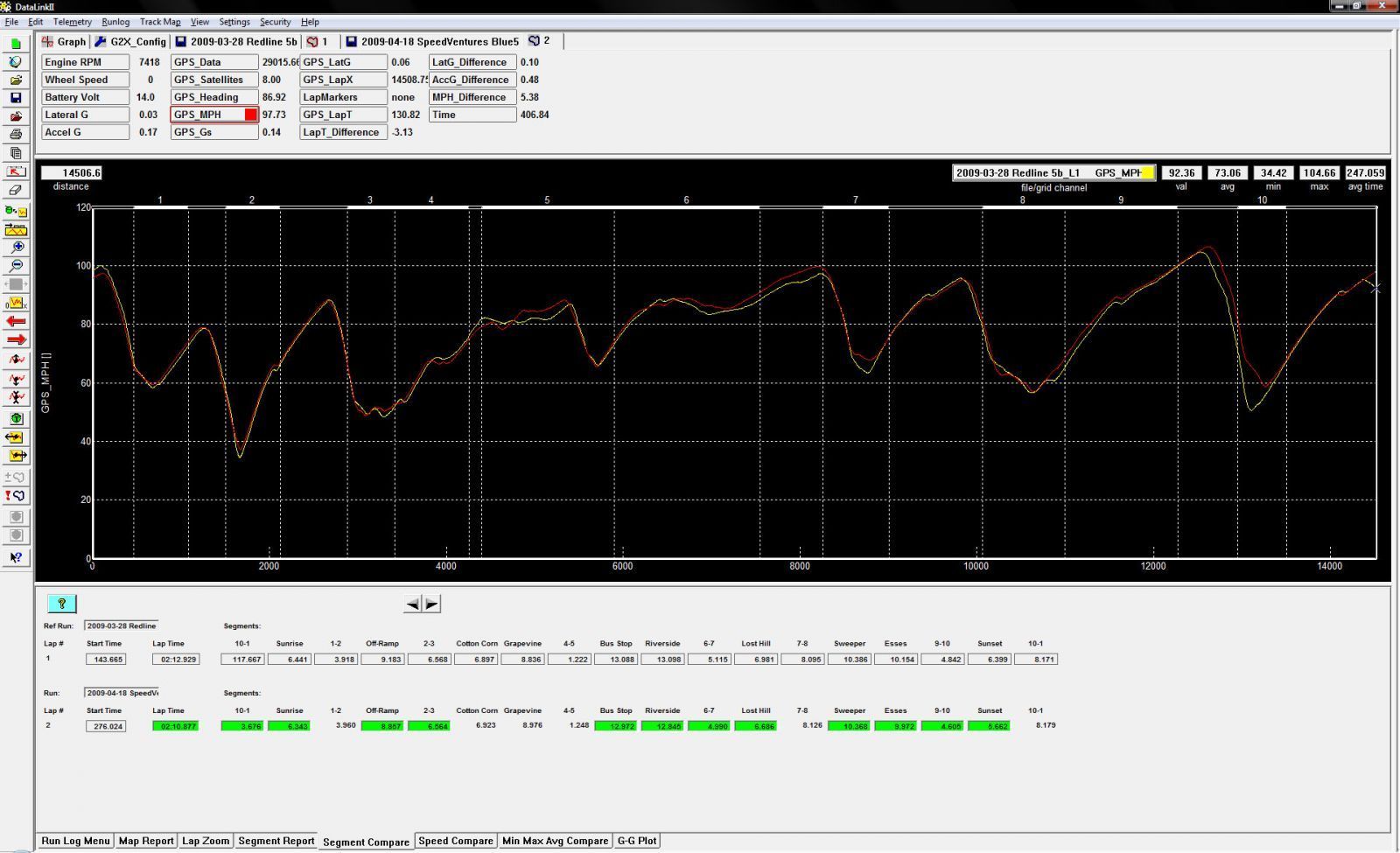

^ I'm not sure if the drag is really appreciable, if you use a modest angle (especially if the wing is not near stall). At Buttonwillow, I didn't see any difference in straight line speed, all the way up to 100+ mph.

^ Tom, I had thought of this, which is why I looked at linear acceleration numbers and not just peak speed. Also, when you look at the MPH graph, you can see that the slope of MPH graph (derivative of velocity is acceleration) remains about the same. If there was appreciable drag, there would be less acceleration, especially at higher speeds. I just didn't see any. Click on the image for full-size.
Red line = with wing
Yellow line = without wing
From what I can see, the wing didn't affect my speeds or acceleration at all...
