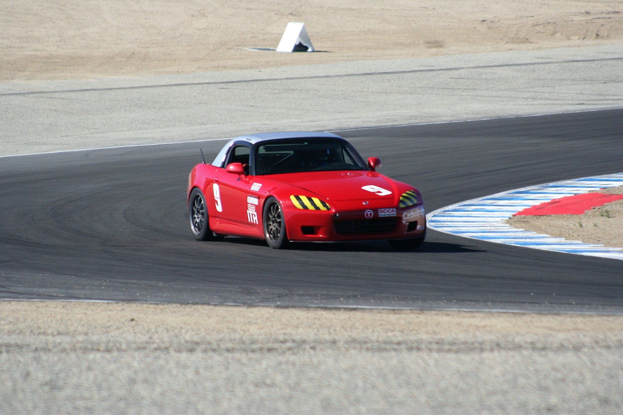

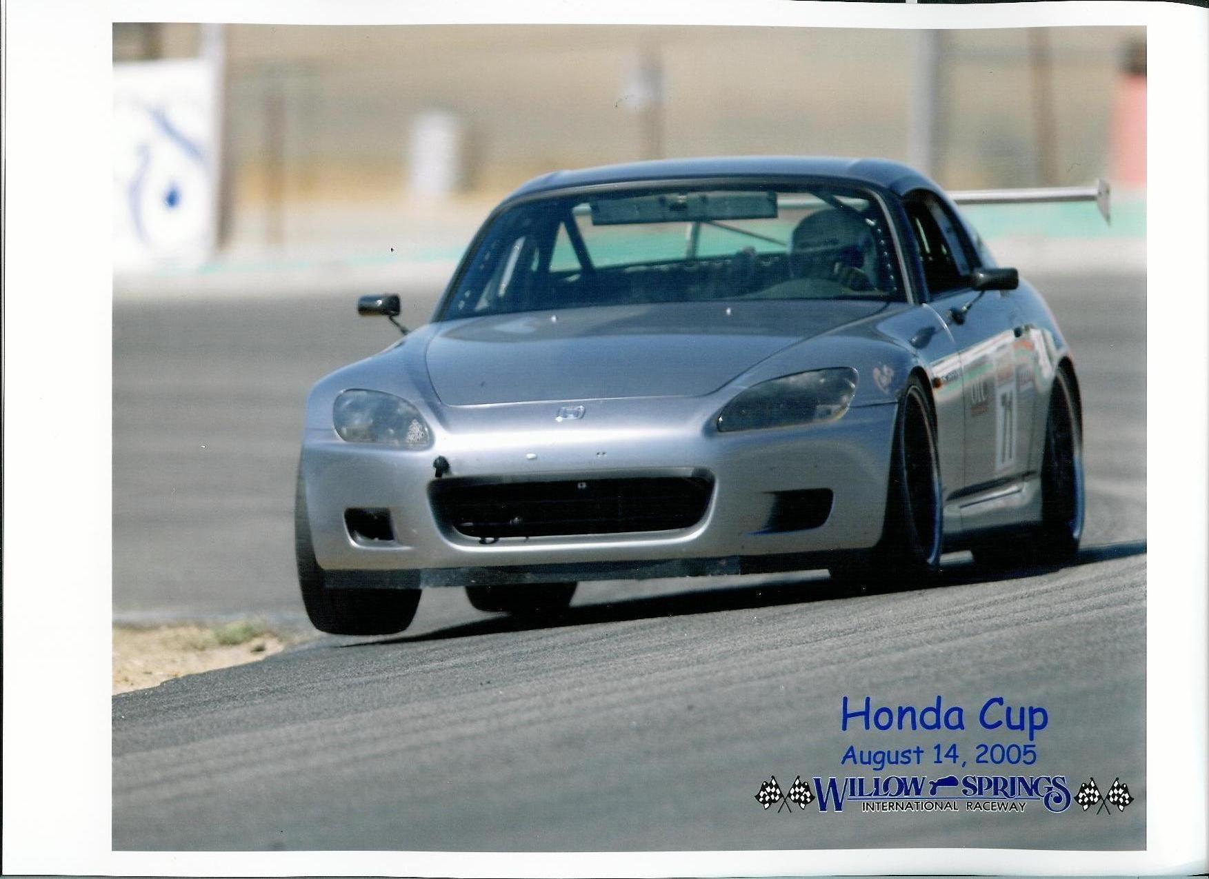

This is a example of what I mean.
in this turn if I had 0 camber the tire would be touching on the outside and not the inside, But with 4 deg of camber it makes the whole tire touch the ground.
(we are talking about the right front tire)
in this picture you can see how the inside tire (right front) is hardly touching.
that is because the camber is so much...also if you look at the outside tire (left front) you can see how stuffed it is in the wheel well and all of it is touching.
End Lesson.
