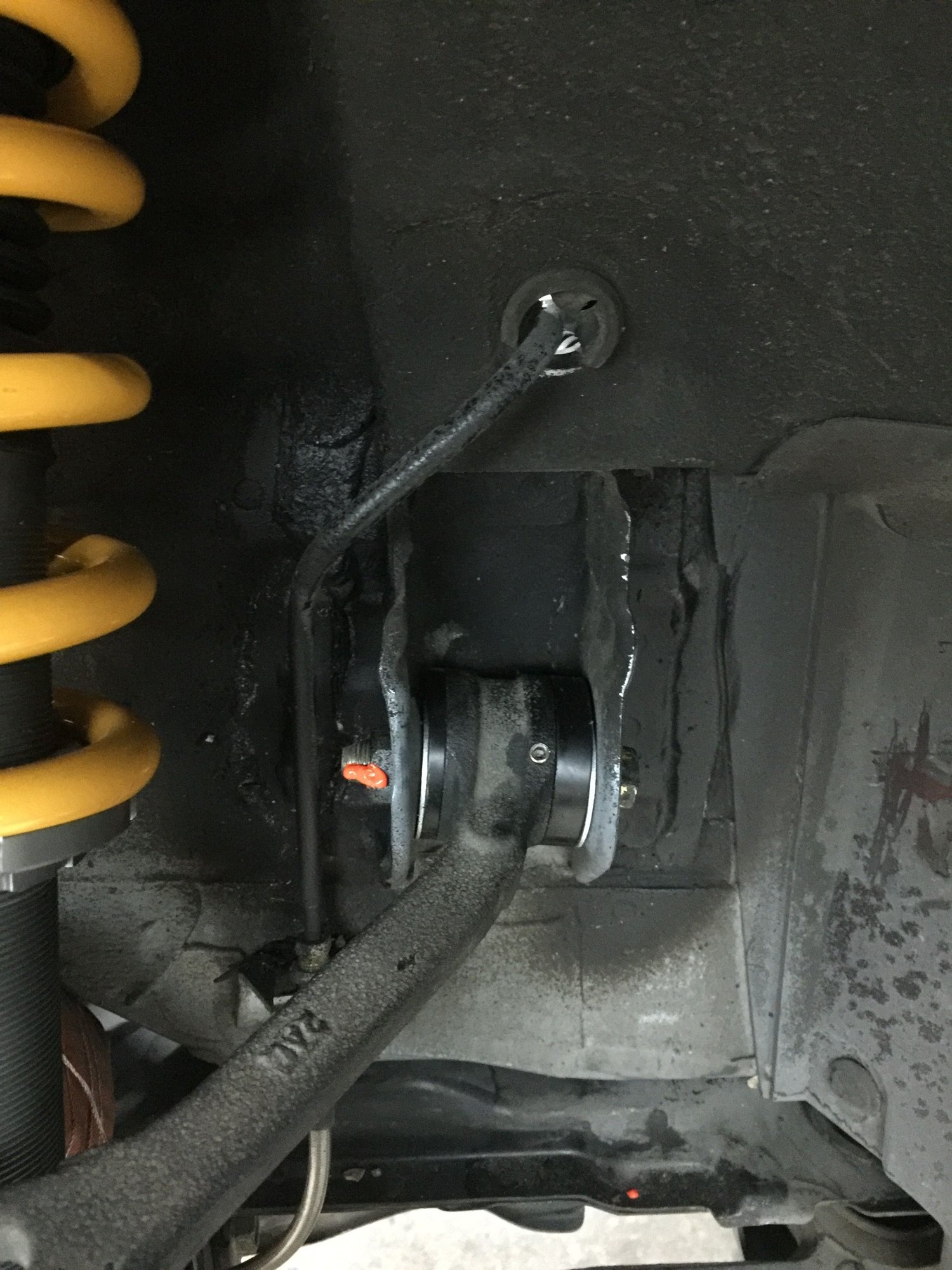

This thread reminded me to adjust the passenger side on my car. I was doing my wheel bearings and reassembled the pass side first and tightened it back up like normal with my calibrated arm. Went to do the drivers side and checked the swing and realized I needed to leave it way looser for freedom of movement. I just checked with my torque wrench and it looks like mine is happy at 21 ft lbs. I use torque mark on many important pieces of hardware these included so a quick visual inspection let’s me know nothing has loosened.

^^^^^ THANKS!!!
I see you used the set screws too.
