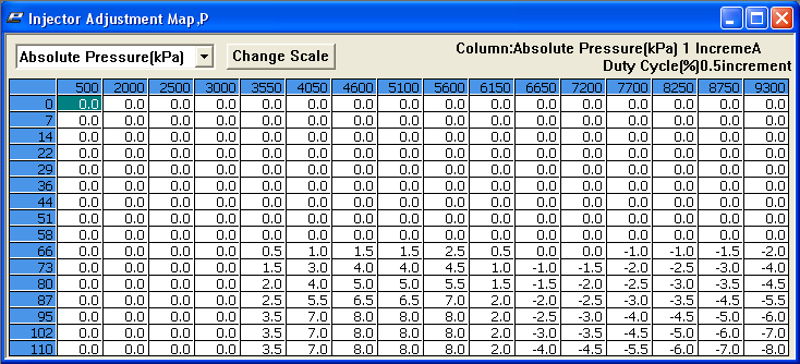

Tuning part throttle with any real piggyback is pointless, as the stock ECU will use a combination of short and long term fuel trims to obtain a stoichiometric A/F ratio. Random1 is referring to a global fuel bias, which affects the open loop AND closed loop portion of the fuel maps.
A global bias just means that you look at what the long term fuel trims are (via an OBD2 scanner) and bias the entire table by the long term fuel correction percentage. So, if my engine is running at a +7% long term fuel trim, I would enter "+7" in every cell of the fuel adjustment map. The actual fuel tuning is still only done in the open-loop area of the map.
If you don't want to do your closed loop tuning from the global bias offset of "+7", you can use the second fuel adjustment map to handle the actual fuel tuning. All of the fueling maps are additive, i.e., your total fuel adjustment = "I/J Map1" + "I/J Map2" + "Ind. Cyl. I/J Map".
Here's an example I just made to better illustrate my point. THESE ARE NOT REAL MAPS, DO NOT USE...I made up the numbers.
Fueling Map 1 - WOT fuel tuning
Fueling Map 2 - Global fuel bias
