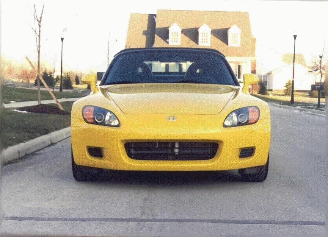

Headlight #1 complete! What a pain in the a%#. Looks great and worth the time. The two parts should be flush since the clips are in place. It was harder putting it back together. Working on #2 now. Will look for bulbs on Friday. My first stop was unsuccessful. Everyone just has the stock clear bulbs.
I will check back when #2 is done.

OK, done with number 2. All I need to do now is just find some amber lights to paint silver. All stores seem to only carry lights by Sylvania in white. Does any one have part #'s from bulbs they used. I will re-assemble the car after I get the new bulbs. This will look great with the JDM clear side markers from Rick's.
A few hints from my experience:
1. The bumper was difficult to remove from the fenders, under the light slid right out. 2002 difference?
2. The lights themselves a tricky to get out.
3. The oven method was the right choice for me but I needed another step. I needed to do 2 heat cycles. 1st was 10 min at 225 then start to separate. Place back in oven for another 5-10 min. The halves then separated very easily. The cracking sound is a little disturbing though. (the lights cool off very quickly.)
4. The glue is the some of the strongest I have ever encountered.
5. Re-assembly of the light is just as difficult as taking dissassembly.
6. If you have never done any kind of work on a car before, this might not be the mod for you.
7. Some owners of MY2002 have had difficulty removing the Honda emblem. With the bumper off, I can verify that it is riveted on. While the bumper is off, it looks like you can take a good pair of side cutters to cut the rivets.
BTW, this mod is worth the time that it takes in my opinion. If any one in the Columbus, OH area needs some pointers, feel free to e-mail me.
I will eventually get a digital camera to post pics.
Good luck to others planning to do this.
