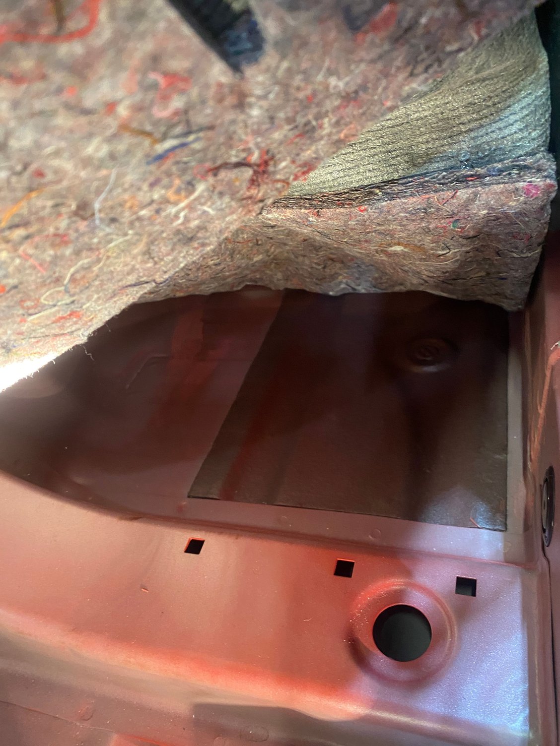

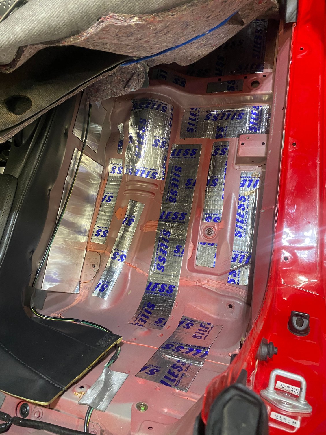

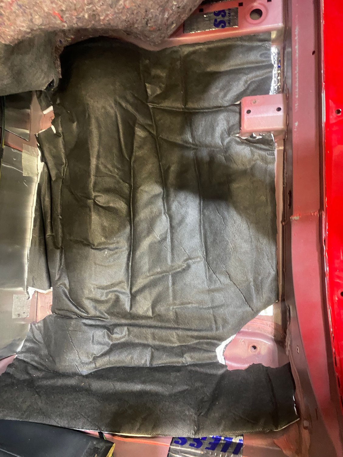

Passenger side is done, driver side after lunch.

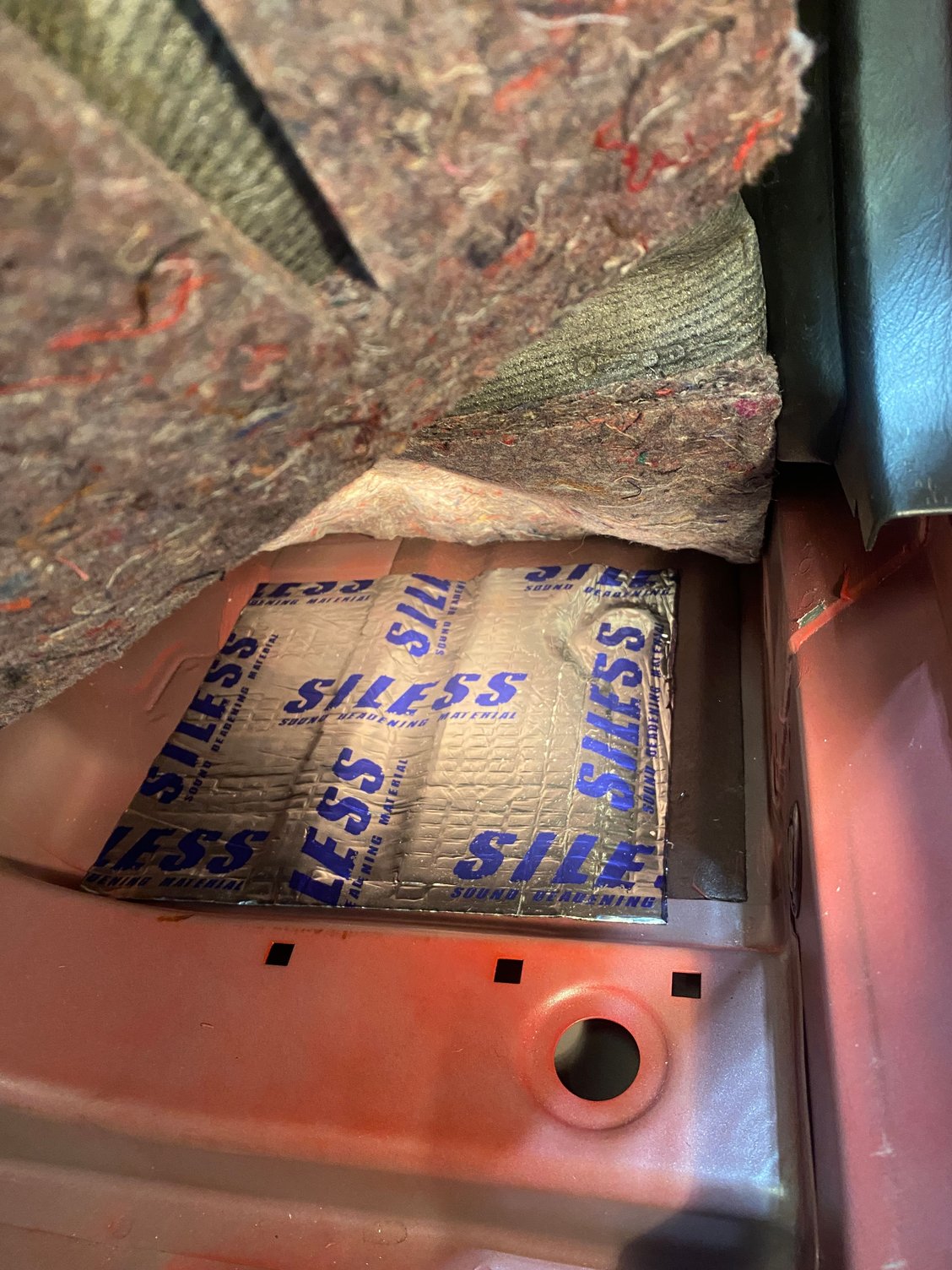

That dark square in front of the "hump" really made a drum sound when knocked on!
So I put a big square of Siless up there.
Going with not full coverage I did do a bit more than 25% coverage though.

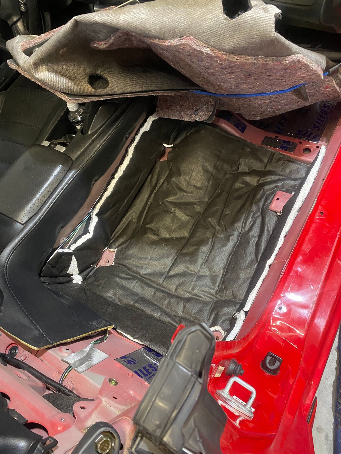

Originally I had the Thinsulate wrapping up on the tunnel and door sill some. (See bottom picture I could not figure out how to edit it and put it here)
That made the carpet not fit however , so I trimmed it back to just cover the flat part of the floor.
Behind the seat there is an open area which leads to the trunk so I put a little piece of insulation in there.

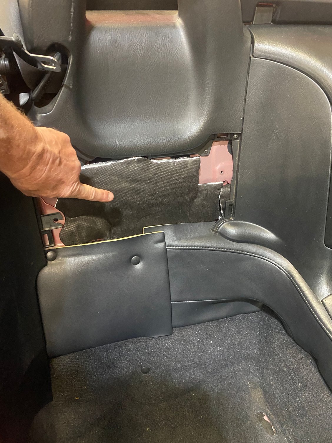

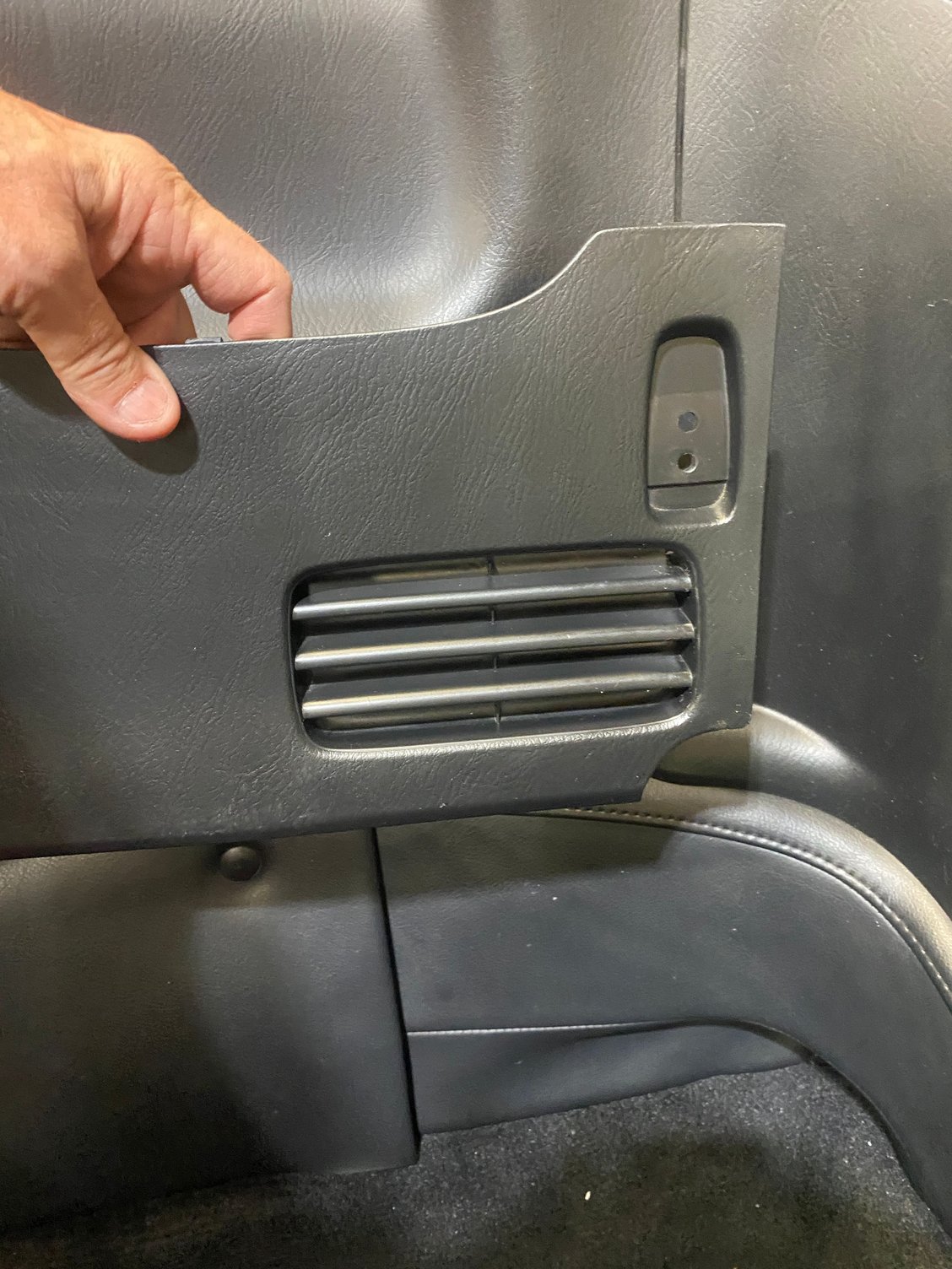

The panel that goes there actually has a vent in it, not sure the purpose of venting it, but if there is good reason to do so that piece is easily removeable... thoughts??

Vents into trunk.
-- Chuck

Ok, I removed that piece of insulation there, left a couple pieces in the voids in there to buffer noise a little though, but will still let air flow through.
Finished doing the floors and didn't seem to do much good, the decibels in the car didn't change much.. In fact it went up a bit!! Music still sounds better..

In addition to being the exit path for top up, fresh air ventilation, those vents behind seats assist when closing doors top up.
With the vents blocked, the top is going to be under more stress as air tries to pop it up as doors shut.

So all in all I think the doors were worth the time, the floors not so much.
