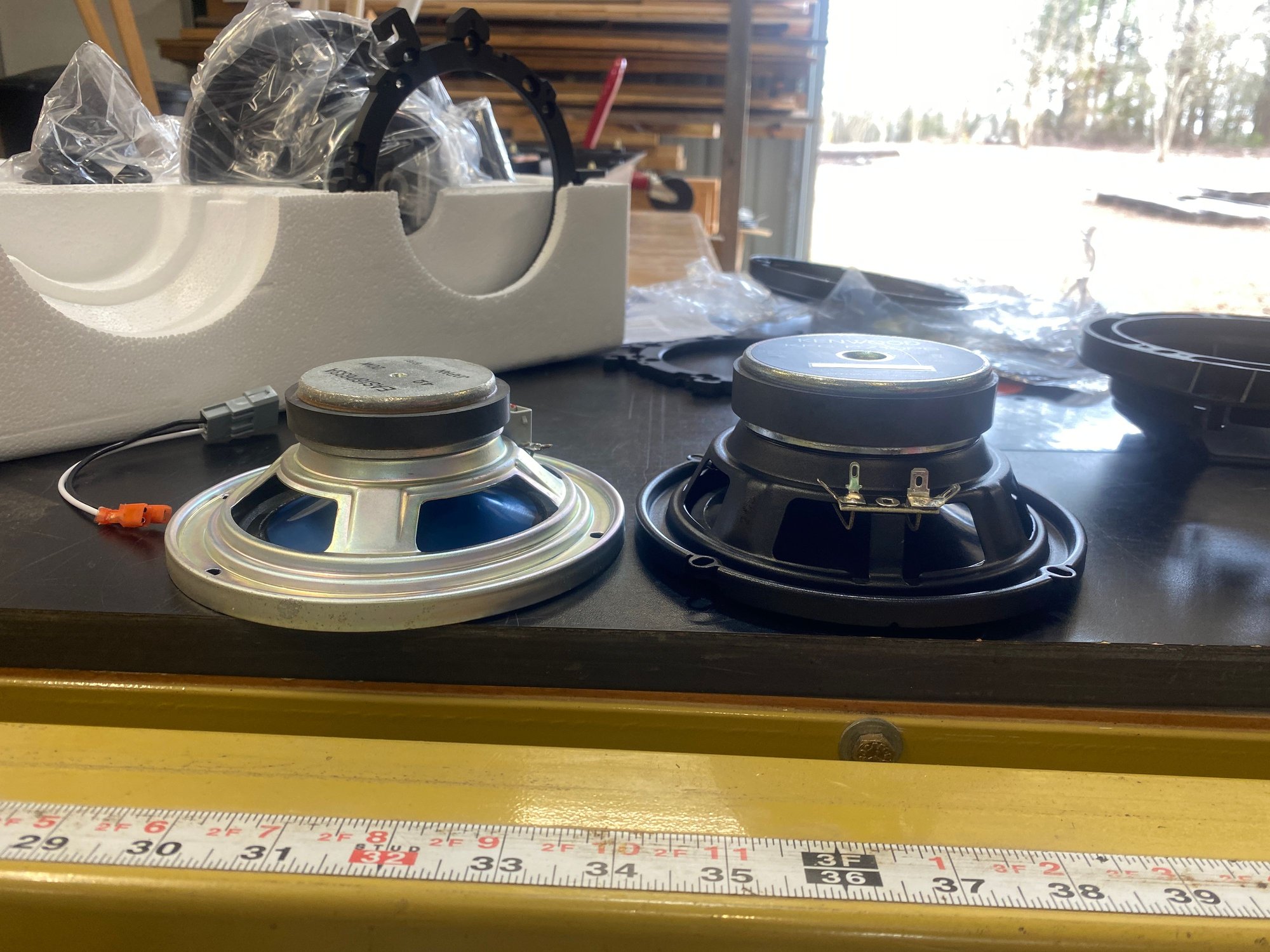

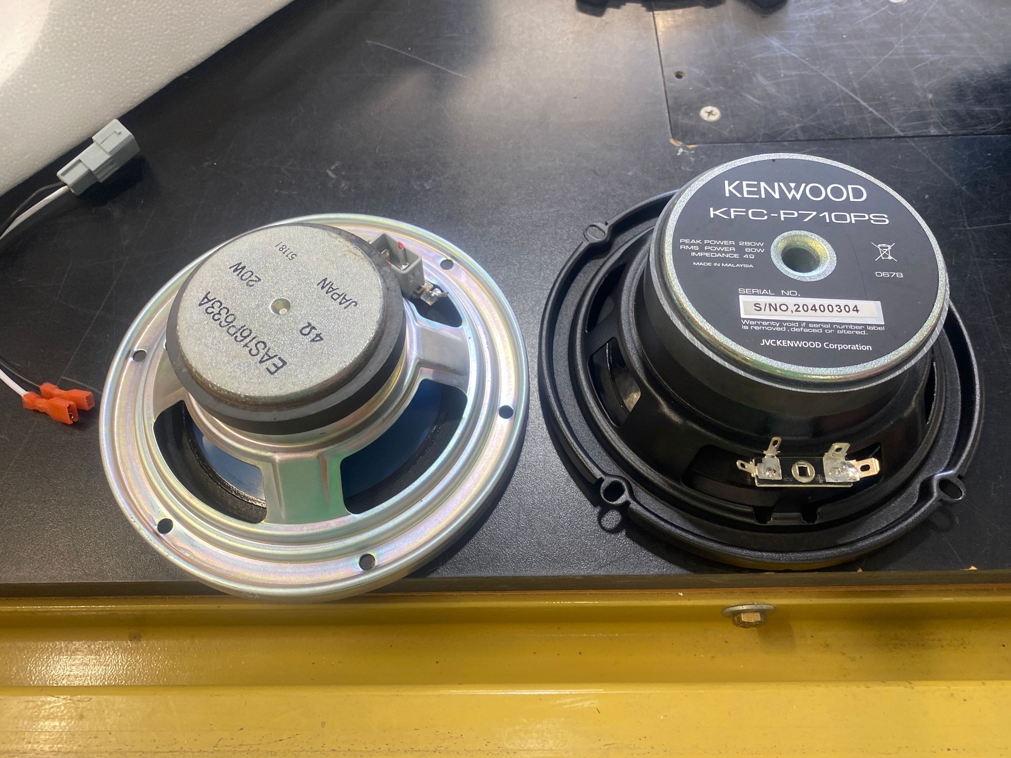

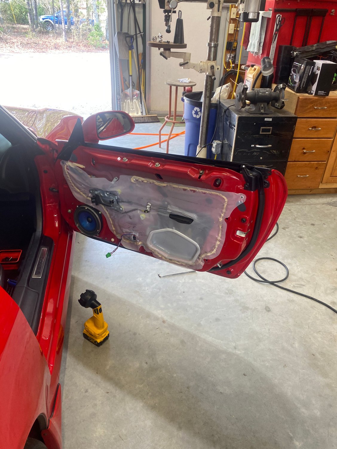

Ok, so update here again... I started exploratory surgery on this thing. I dont know if you remember or know but this all started with me wanting to change the radio and speakers in this car, at that time it was recommended to me to do some sound deadening as long as I was tearing into this thing. Stereo HU has already been replaced and dash controls returned to operating condition, received a set of speakers for Christmas and had been researching products to quiet it down. Got all my materials in hand so I went to have a look at things today, speakers seem to be a problem as they wont fit in the speaker "cups" in the door as they are larger than the stock ones that came in the car. Modifry to the rescue yet again.. Ordering a set of thier speaker rings to make the change easy and neat, so I am on hold till I receive those. To be continued!

I almost pulled the trigger on new speakers and Modifry speaker rings but I wanted to get the NVH job done and not string it out. Actually, with a new HU from Sony and the plug and play stuff from Modifry, I was pleasantly surprised how well the stock 2009 speakers sounded with a lot more power and sound deadening in the doors.

My biggest problem is the passenger side speaker has got a good crackle to it.. need it changed.
