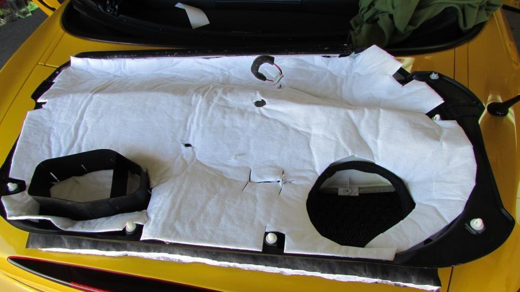

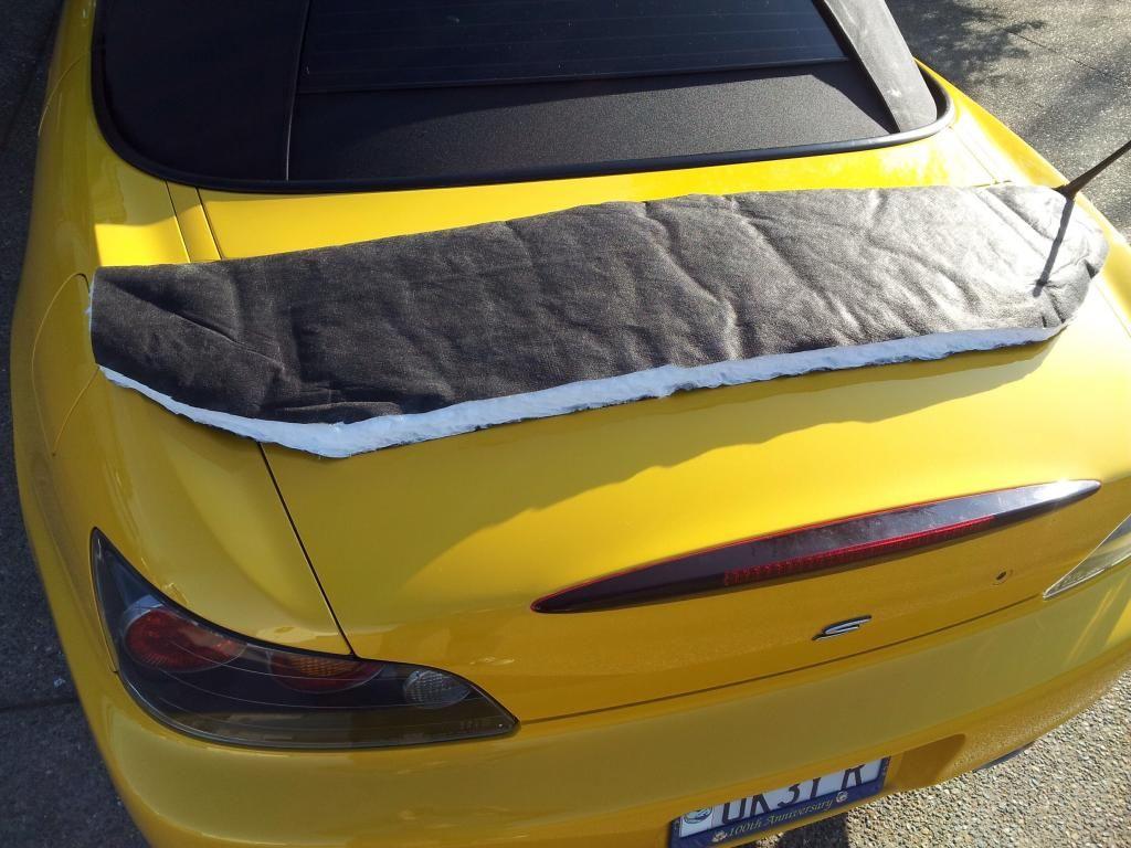

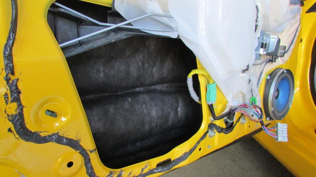

I know the 3M thinsulate is not as easy to obtain and may cost more (mine was free with the promise of a report from me) but there is a reason that product is used by auto manufactures from Honda, Porche and Mercedes (and others): it works. It is hydrophobic, that is, it cannot absorb water and then mildew the way the mixed "rag and foam" stuff Honda used in the S2000. That is why the S2000 has uninsulated doors. In addition the fibers of Thinsulate are a specific lengths to absorb targeted noise frequencies to reduce NVH. It is super lightweight. It is superior to the old school recycled stuff that has been used for some time in older cars just like the S. Thinsulate comes in all kinds of thicknesses and is easy to work with. All of those are winners in the auto industry. Rip out any panel on a newer MDX, Accord or 911 and you will see 3M Thinsulate. I obtained mine from the division that supplies Honda for manufacturing. They shipped samples at no cost to me for evaluation after smoozing with them about the stuff and my car-a Honda!
Doors are a big win along with the floor and trans tunnel. The door insulation with BQuiet and Thinsulate not only stopped a lot of NVH, but made the doors close with a "thunk" and made the speakers sound much better. The trunk can be left alone, really, unless you want to mitigate the heat on trunk contents over a long drive. However, I put a very thick piece of Thinsulate on top of the tray behind the seats (it is loose and just sits there so you can just move it if you want) and find it blocks the noise from the trunk and absorbs sound in the cockpit just like carpet in a house instead of hard floors. The attached pic shows the piece I use to place on the tray.

I have to admit I have not driven with the top up, windows down at 100mph. Windows up, yes but then the wind in the cockpit is zero. I have never noticed the Thinsulate on the tray moving or floating ever. Because it is black I sometimes forget it is there when I toss a hat or something back there.
I might add I do not remove it putting the top down. The top settles to it's proper position and I also have no problem using the tonneau cover either. I use that a fair amount in the summer. I will add I have replaced the elastic straps twice from Modifry.

The shelf measurement was trial and error. I would put a piece in, cut, and re-insert, cut again till I was happy.
The door was not completely filled. Maybe 2/3rds. I put the B Quiet in strips (no pic) running between the supports. I sprayed the adhesive on that and then slipped the Thinsulate in there. Because it was a wave install as it went over the supports and back down the door skin, the piece needed was larger than the area covered. Up to you. I also put some on the door panel. Very thin Thinsulate with some B Quiet. Not a work of art but it is on the backside.
