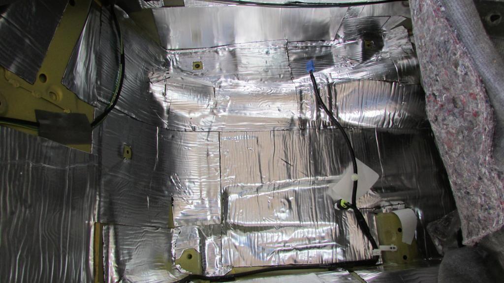

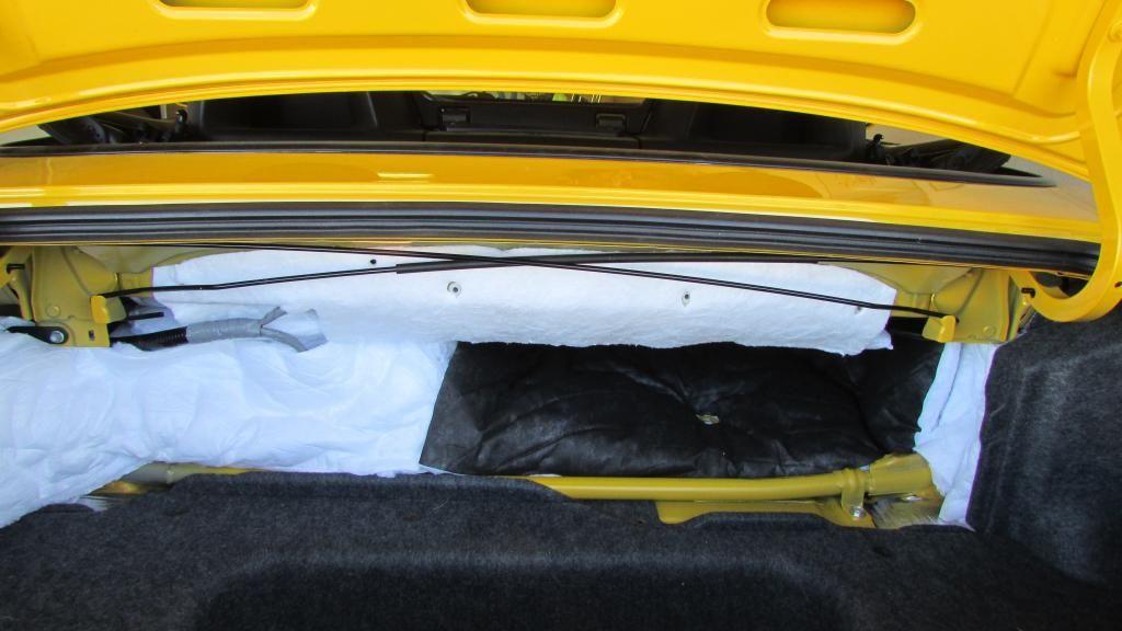

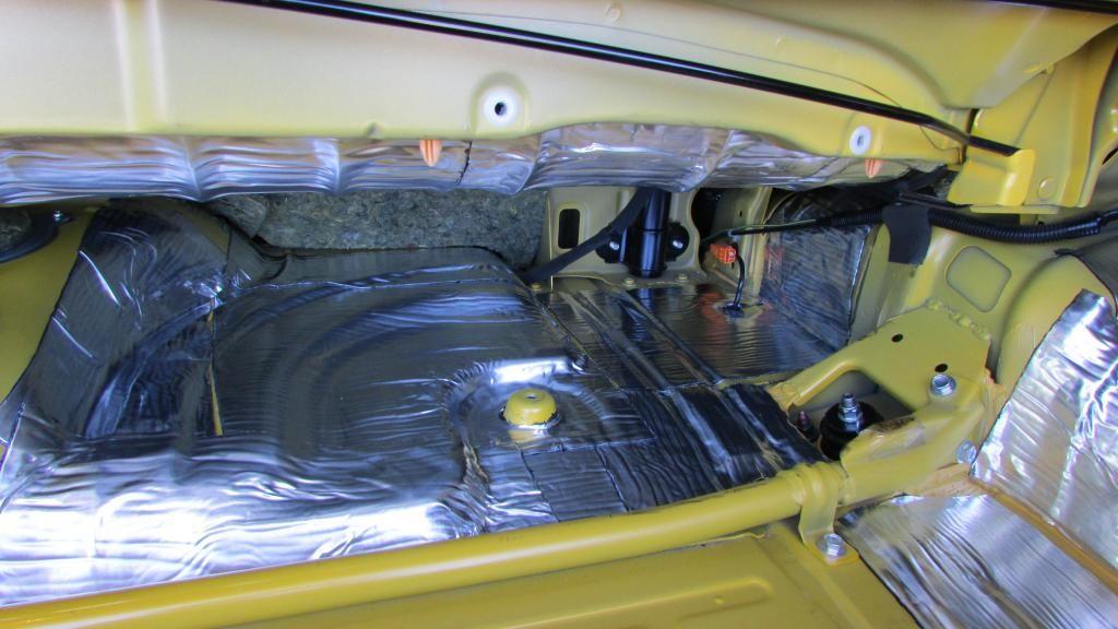

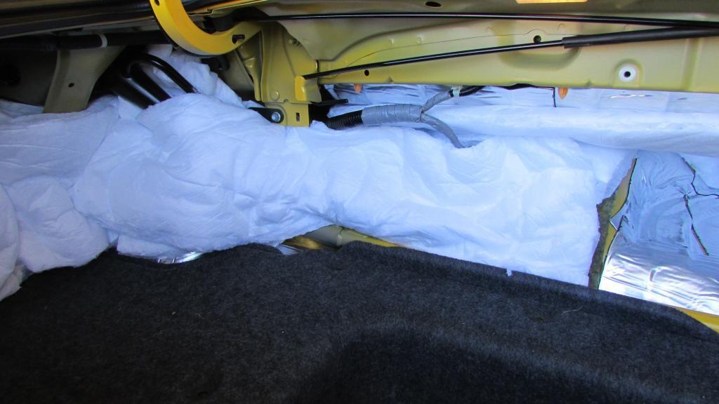

I am attaching some pics of my attack on the upper part of the trunk area. It is a tight fit because of the spare. I stuffed the Thinsulate in a variety of spaces. However, the bulkhead behind the seats and truck was also treated and that seemed to be the best way to isolate the trunk NVH. The piece on top of the tray absorbs NVH in the cabin and I also slipped a piece inside of the top itself where the material makes a flat tube over your head when the top is up.
I stopped adding any insulation once I hit the cross support under the seats. Nothing forward of where the front edge of the seats. No worry about messing around with the dash or pedals or anything up front. The floor/tunnel/ insulation install was working so well I did not want to kill all the engine noise especially winding it up.

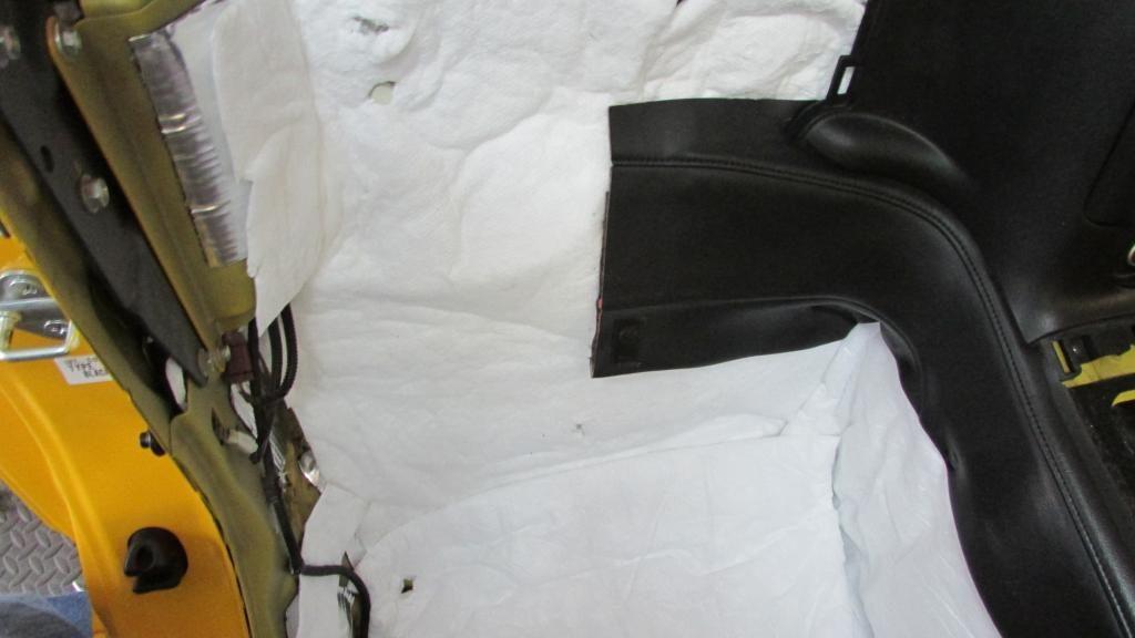

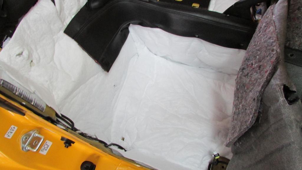

I don't know if it is one piece or two. I didn't remove the clips under the dash and just rolled it up into the floorboard.
These pics are from my install.
I used a very thick spec of the thinsulate and it made re-install of the carpet and seats a challenge. I would recommend keeping it away from the seat bolt holes.

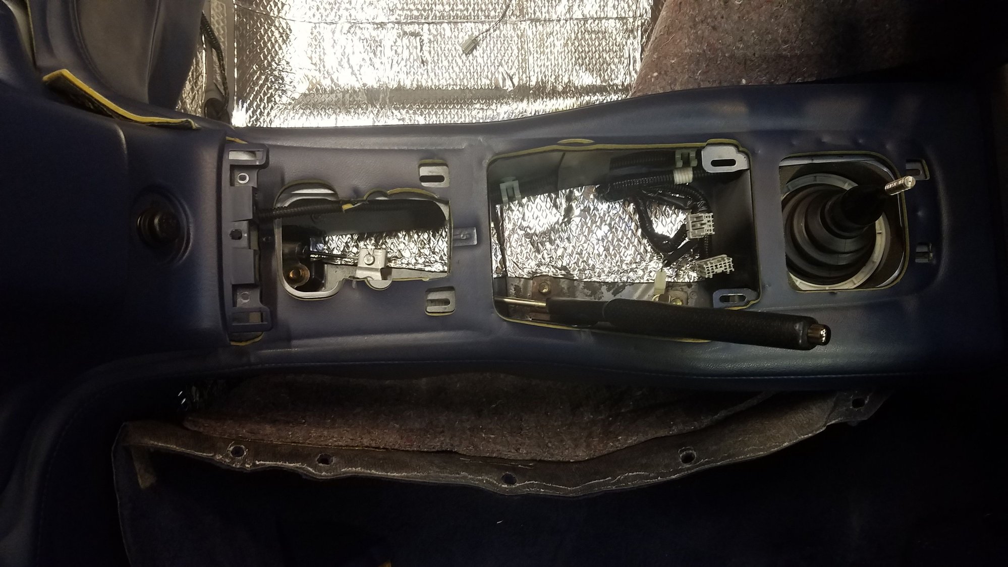

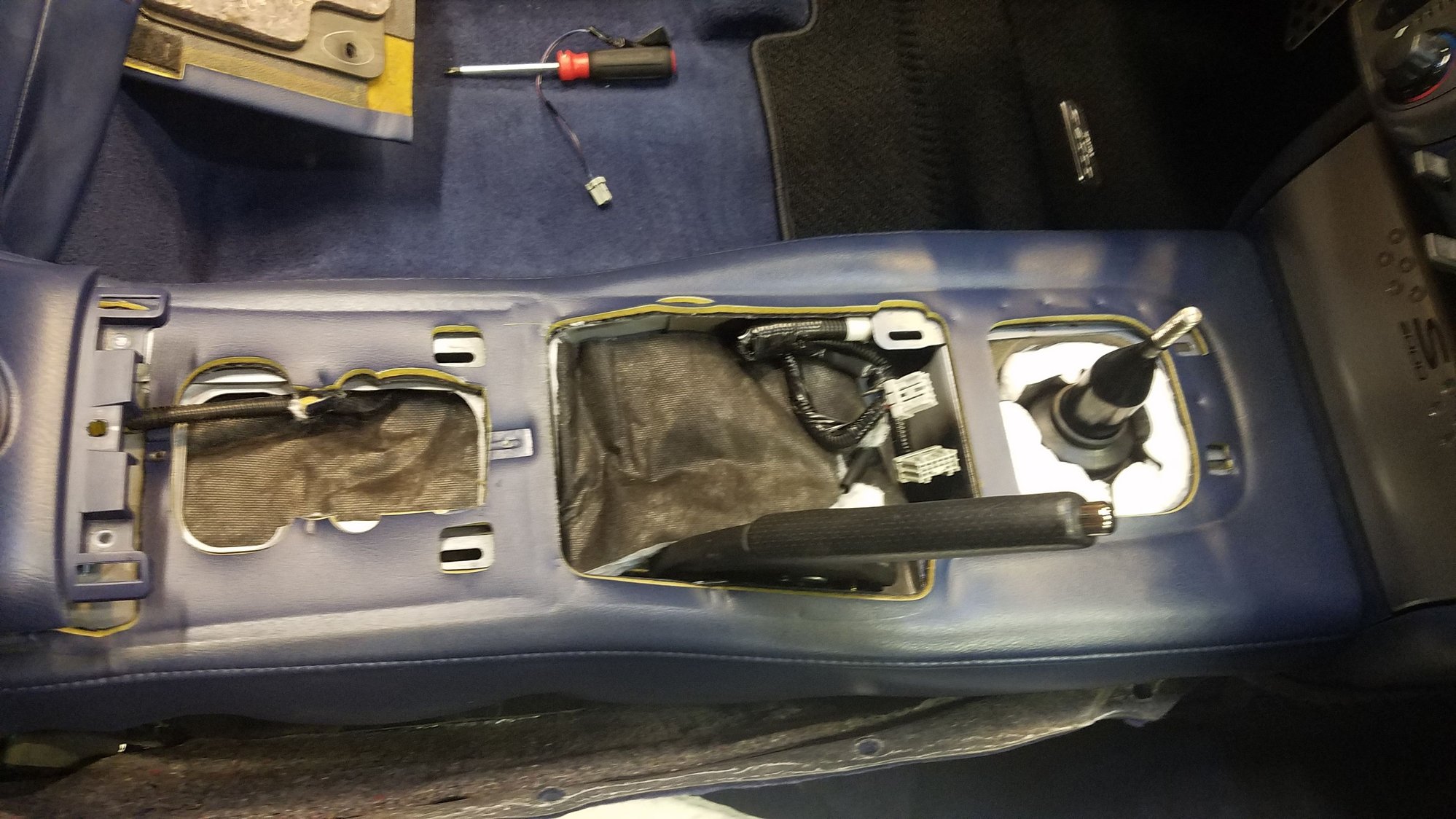

Correct. The carpet is split.
I took off the armrest and plastic console cover (it is just clipped down) so that I could stuff some sound deadening in there. But you don't have to remove the vinyl part.
I also took the two screws out from the bottom of the glove box to get some material behind the vinyl. Here are a couple more pics.
