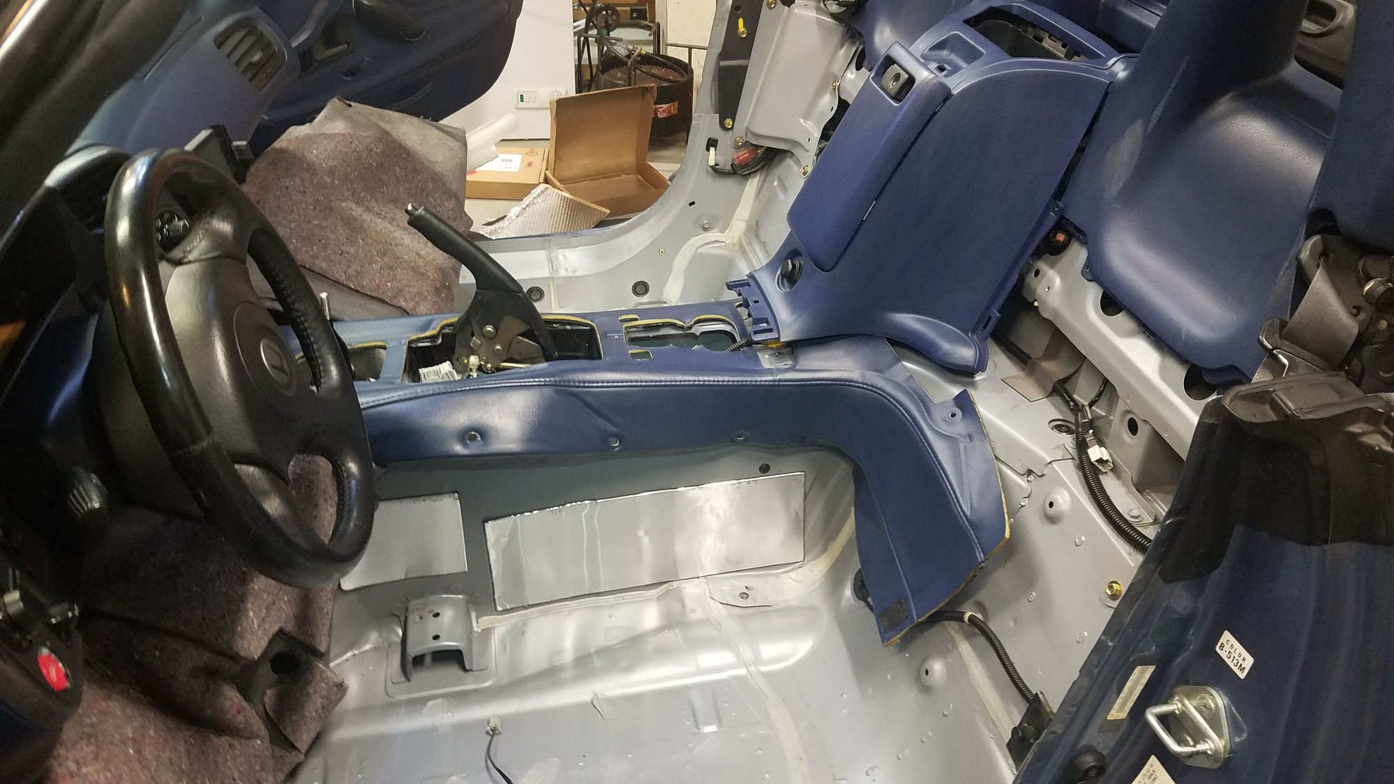

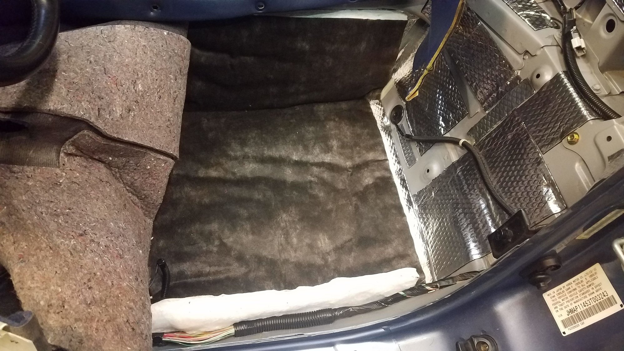

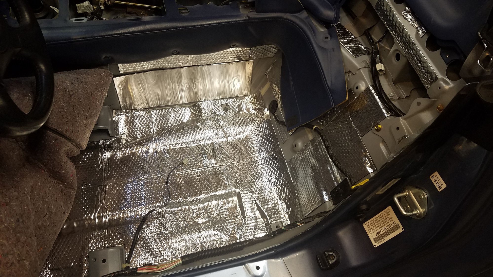

Originally Posted by BrewDay09
I don't know if it is one piece or two. I didn't remove the clips under the dash and just rolled it up into the floorboard.
These pics are from my install.
I can still see the waffle pattern in the nico or dynamat stuff you used. You're supposed to roll it until those lines disappear. That is how you know its adhered properly.
Its not about if it comes off or not, its needed to make it work. It adds mass to damp vibrations by changing resonant frequency. If its not stuck down it won't work.
You also don't need anywhere near that much. Anything more than 25% coverage isn't doing anything except adding weight and taking up space (and costing money).
You apply it to center of large panels. You can divide a larger section into areas, especially areas with reinforcements or beads, and apply to center of each area.
