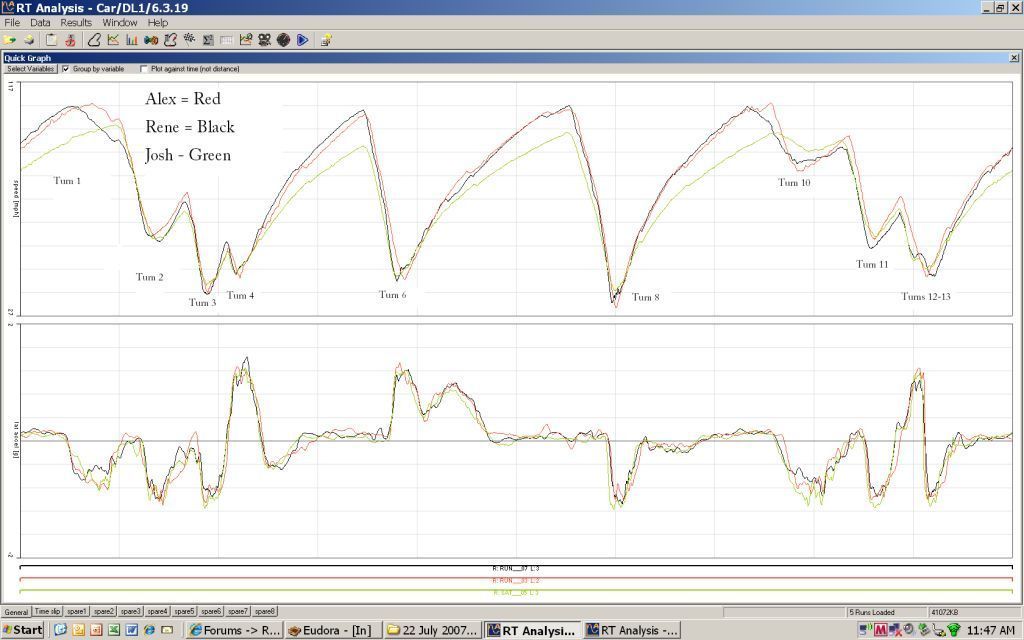

Here's some data from the track day. We put a DL-1 data logger in the M2000 for the afternoon on Sunday and came up with some interesting information.
Alex and Rene were driving the M2000, I was in my Miata
Fastest Laps
Alex = 1:45.59
Rene = 1:47.44
Josh = 1:51.80
Maximum Speed
Alex = 109.79 mph
Rene = 110.06 mph
Josh = 100.64
Maximum Lateral Acceleration
Alex = 1.34 g
Rene = 1.44 g
Josh = 1.29 g
And here is a comparison of our fastest laps in graphical form. It's easy to see where the M2000 just walks away from my Miata in each of the straights. The top graph is speed and the bottom graph is lateral acceleration. It doesn't look so good in the thread - click on the image to bring up the S2Ki viewer, and then click on the image in the viewer to show a larger format.
