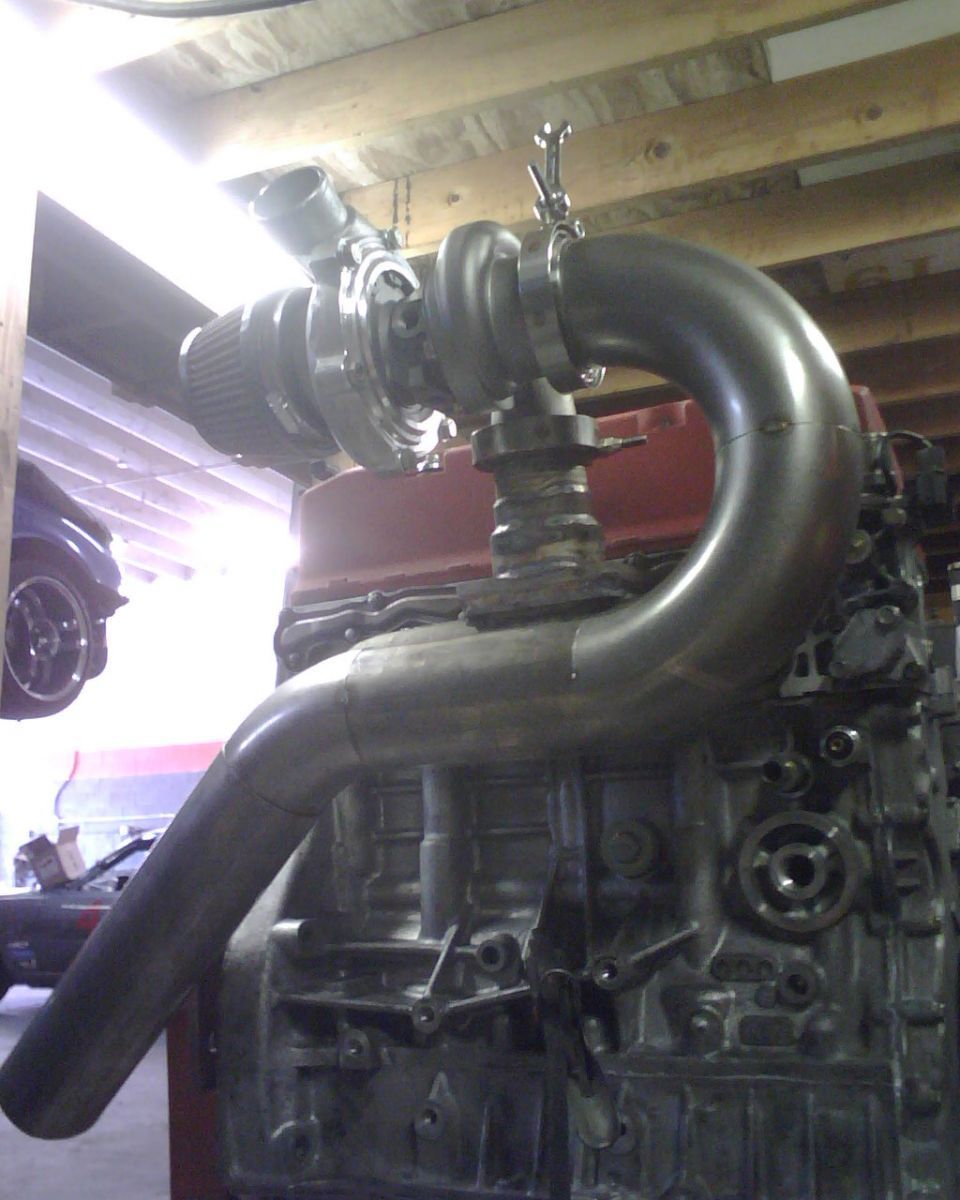

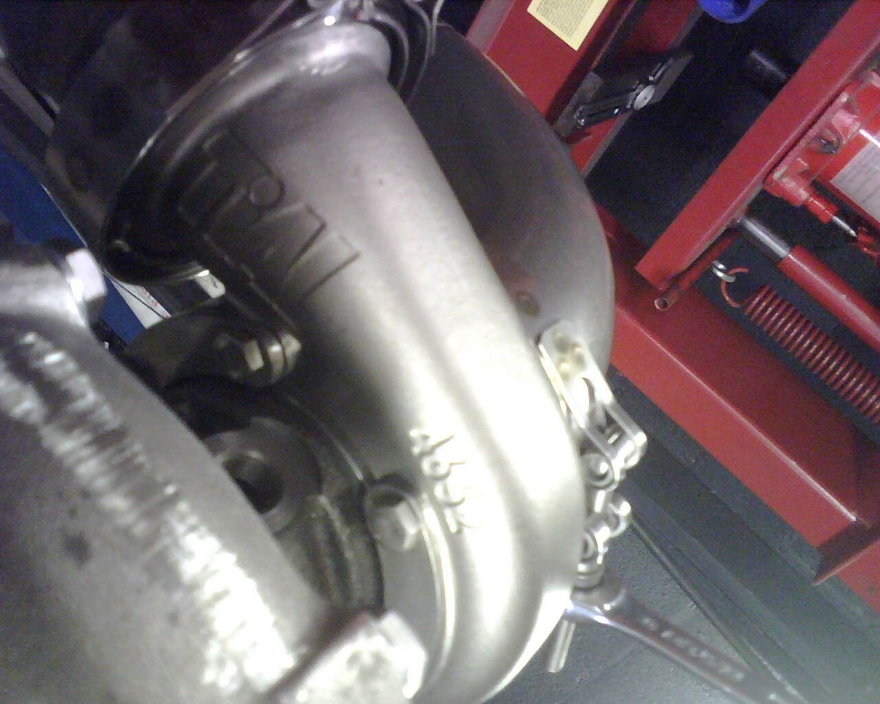

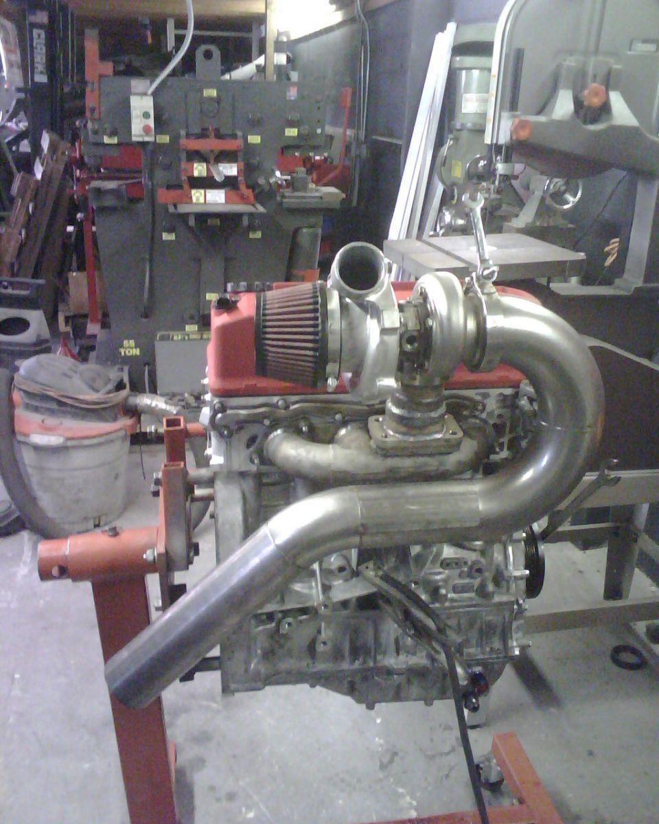

Thanks! Here are some bad cellphone pics of the new turbo setup on the engine stand. The manifold is a modified S2000 bottom mount manifold that we flipped to a top mount and fabricated a flange to V band adapter to mount the turbo. These pics are of the prototype basically, a better tubular manifold may be in the future:
