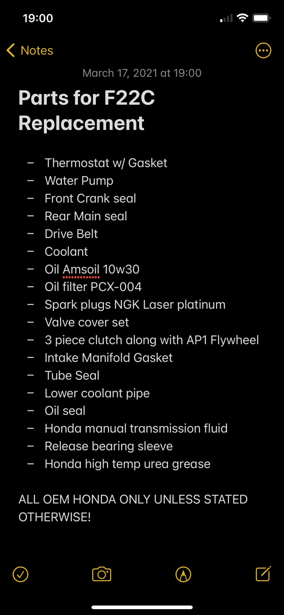

All right guys here is what I’ve bought from what my mechanic has told me and from various other opinions from other people.
- OEM Thermostat with Gasket
- NGK Laser Platinum Spark plugs
- OEM Water Pump
- OEM 3 piece Clutch with AP1 Flywheel
- OEM Front crank oil seal
- OEM Rear crank main seal
- OEM Valve cover gasket set
- OEM Drive belt
- OEM Oil Filter
- OEM Honda Antifreeze
- Amsoil 10w30 Oil
That’s it for now but I’m considering also buying Billman’s TCT. Let me know if there’s anything else you guys recommend while the engine is sitting on a pallet!

Seems to me you are doing the right things. Exciting to see someone take the good advice given here to replace rather than rebuild. Good luck with this. If your mechanic is not s2k experienced, maybe mention to him the conclusions here about difficulties pulling engine from top.
Given that the car was raced, best to give all the other systems a good inspection as well.
