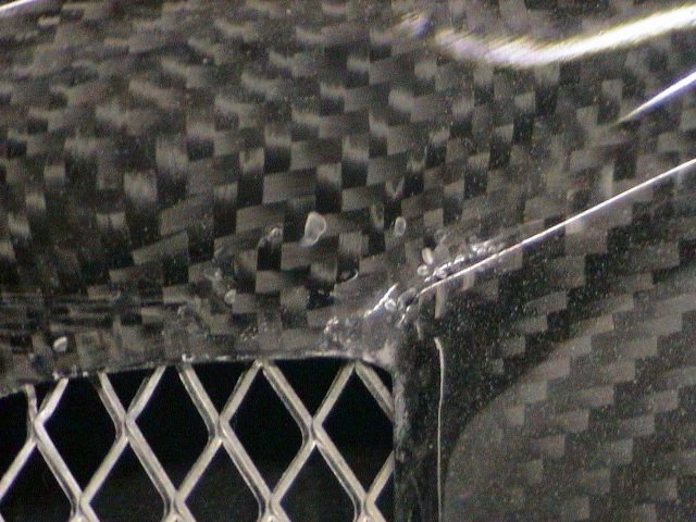

Pete, the clearcoat is wet sanded down till it's smooth and then reapplied. So stripping it might not be the right word I was looking for. It can be done. A few folks have already done it on this board. I guess the proper pics will decide this but I am pretty sure it can be done.

Today I went to the shop and saw the defective hood from Evolution mounted on the car. The top guy from the shop was already gone, but I was free to look at the defective hood, and take photos.
From far away, it looks great.
From up close, it looks like crap.
The finish of the clear coat is terrible, at any price.
There are several chip-like defects in the clear coat that are very deep, and look like they go down to the fibers. There are other scratch-like defects all over the hood (not in the weave), which are about 1/2 inch to 1 inch, and some of them are also very deep. Also, the entire surface of the clear coat is rough.
After examining the defective hood, I understand what the body shop is talking about. In order to correct the really deep defects, the clear coat would have to be sanded completely down to the fibers, then to get the surface level, basically the entire hood would have to be sanded down that far.
The clear coat on the defective hood is not like a coat of paint. It is VERY thick. Also, from what I have read, if the sandpaper just touches the CF threads, the look will be ruined, so the deep defects are risky to repair.
I couldn't get good pics of the defects in the surface of the hood, because of the overhead lighting, but you can see what I am talking about in the first photo. The clear coat is not chipped, those defects just look like chips.

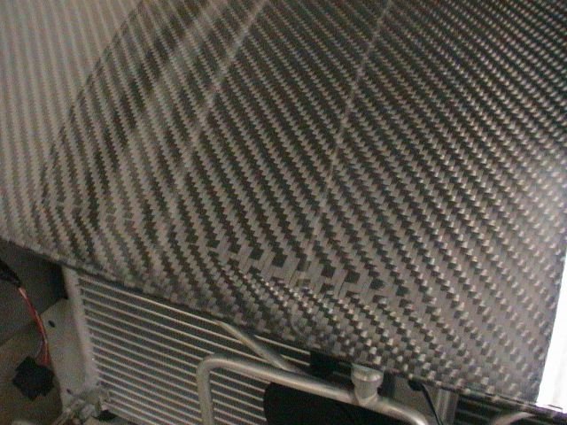

The other big problem for me is the worst of the CF weave defects- which is the big one on the front of the hood. It looks like a big scratch, right in front, basically in the center of the front view of the car. I hate it! It's in the second photo.
At this point, I don't know if this defective hood can be painted properly, or not, or how much it would cost. If it can't be painted I will have to get rid of it.

Good Job, Jeff. Pete, hopefully now this will get resolved to your satisfaction.
Pete, after seeing those pics, I now understand your horror. I think I would have had a heart attack.
