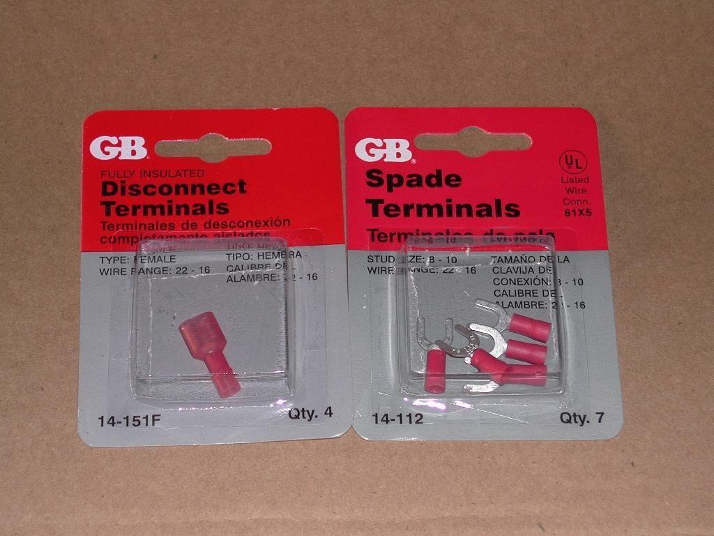

If your Valentine ground wire is anything like mine, you'll find that the spade terminal is a bit too small to fit around the grounding bolt on the car. I installed a set of these during my install & things fit perfectly...
Similar to the ones in the FAQ, but these were actually a better fit for the Valentine wires.
Hope this helps!
Globetro...I just realized you were a So.Bay local. Orchard Supply Hardware carries these particular terminals.
