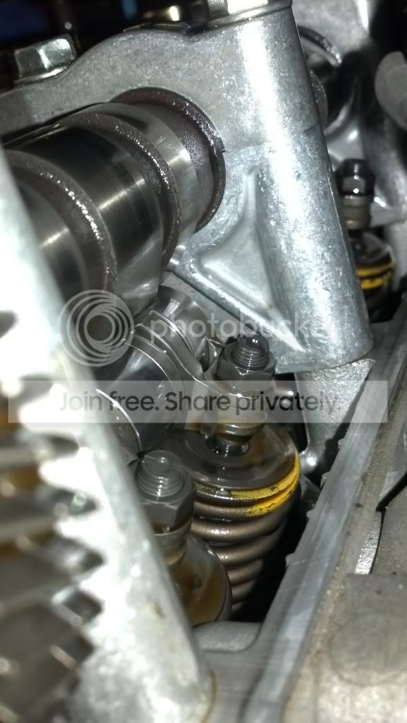

Decided to post up a photo of what I believe to be my worst condition intake side retainers (the rest actually look either similar to these or in some cases better)
Should I be concerned with having any cracked retainers at this time based on this photo of what I believe to be the worst of the intake side?

This thread should become very interesting.
The retainer you are showing appears to be what I can the NEW style AP2 retainer here in the USA, but you say your car is a 2000.

It has me slightly stumped myself, Ducky's photo of his retainers somewhat suggest to me that I should be possibly looking into replacing my retainers in the near future based on how better visible his cotters are, mine are obviously still visible but the inner walls on these two in particular are visible also.
I can't say for sure if they have been replaced or not in the past, I'm going to say that it's unlikely that they have been as nothing in the service records suggest any additional works were carried out outside of the normal service schedule.
All in all, in the last 40,000km since valve clearances were last adjusted I had two exhaust clearances slightly loose outside of spec and two intake cleances tighter than the others but still within spec, just on the tighter side of what's required.
I still have a bit of an engine tick that's still noticeable with the rise and fall of RPM up to around 3000rpm, after which the ticking sound becomes drowned by the rest of the operational noise of the engine/trans etc. I replaced my TCT a few weeks back with a new OEM unit so with less than 300km use I'm ruling that out for now, in my past experience I'm going to see how changing engine oil from the castrol 5w-30 I'm running now to OEM Honda Synthetic FEO 5w-30 and see if that makes any difference.
On my Civic Type-R it made a world of difference noise wise switching from Motul back to OEM Synthetic so fingers crossed the same magic happens twice.

Just posting up another view of another set of retainers found on the 3rd cylinder, I unfortunately didn't take many pics as my camera has a hard time focusing and its fairly awkward in there.
And for the sake of it, these are my exhaust side, all of them practically looked the same as in this in shot;
What do you think Billman? worth me investing in a set of AP2 retainers and cotter/keepers? and should I be considering doing them very shortly or could I possibly leave them go for a little while longer?
