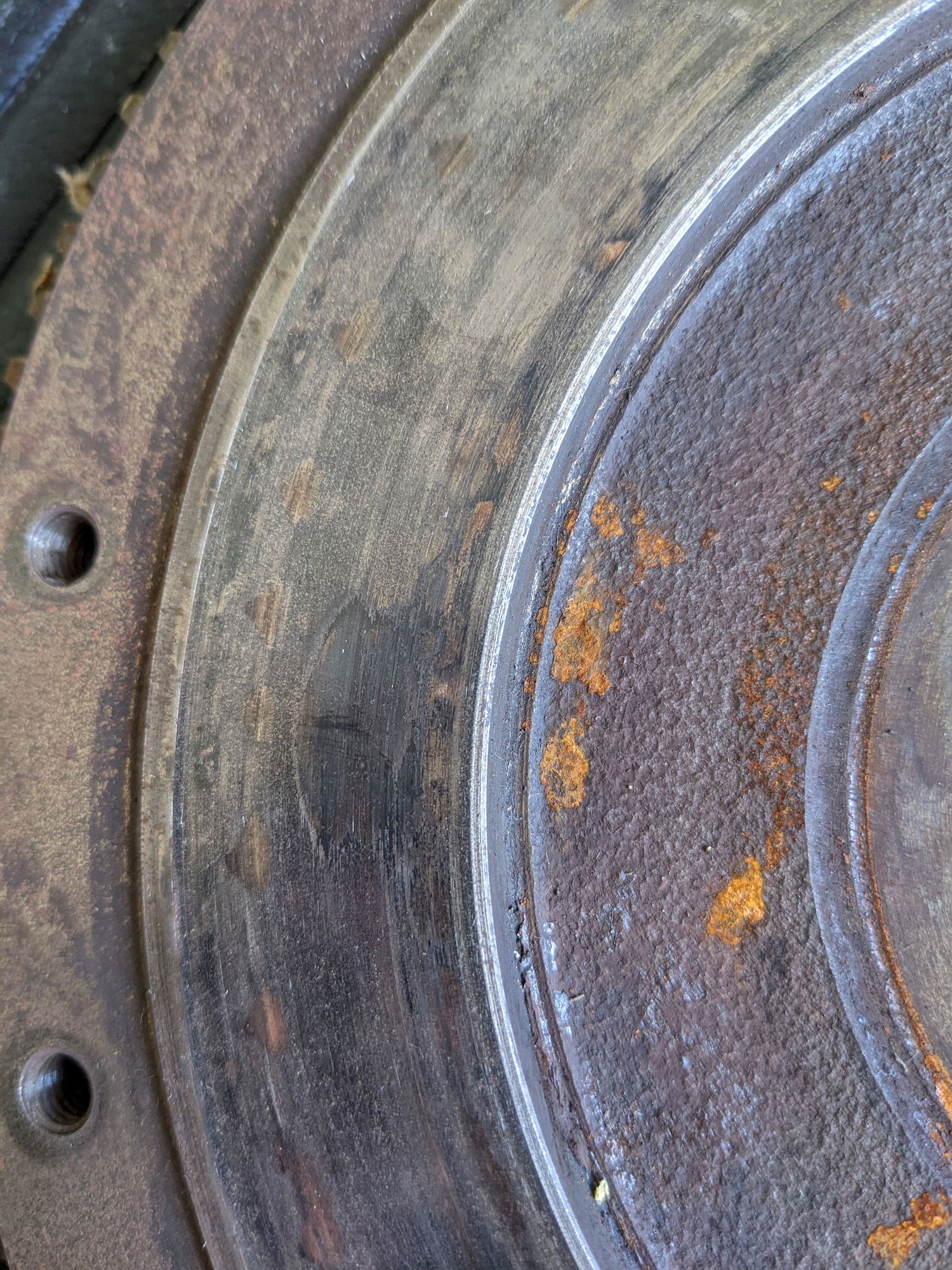

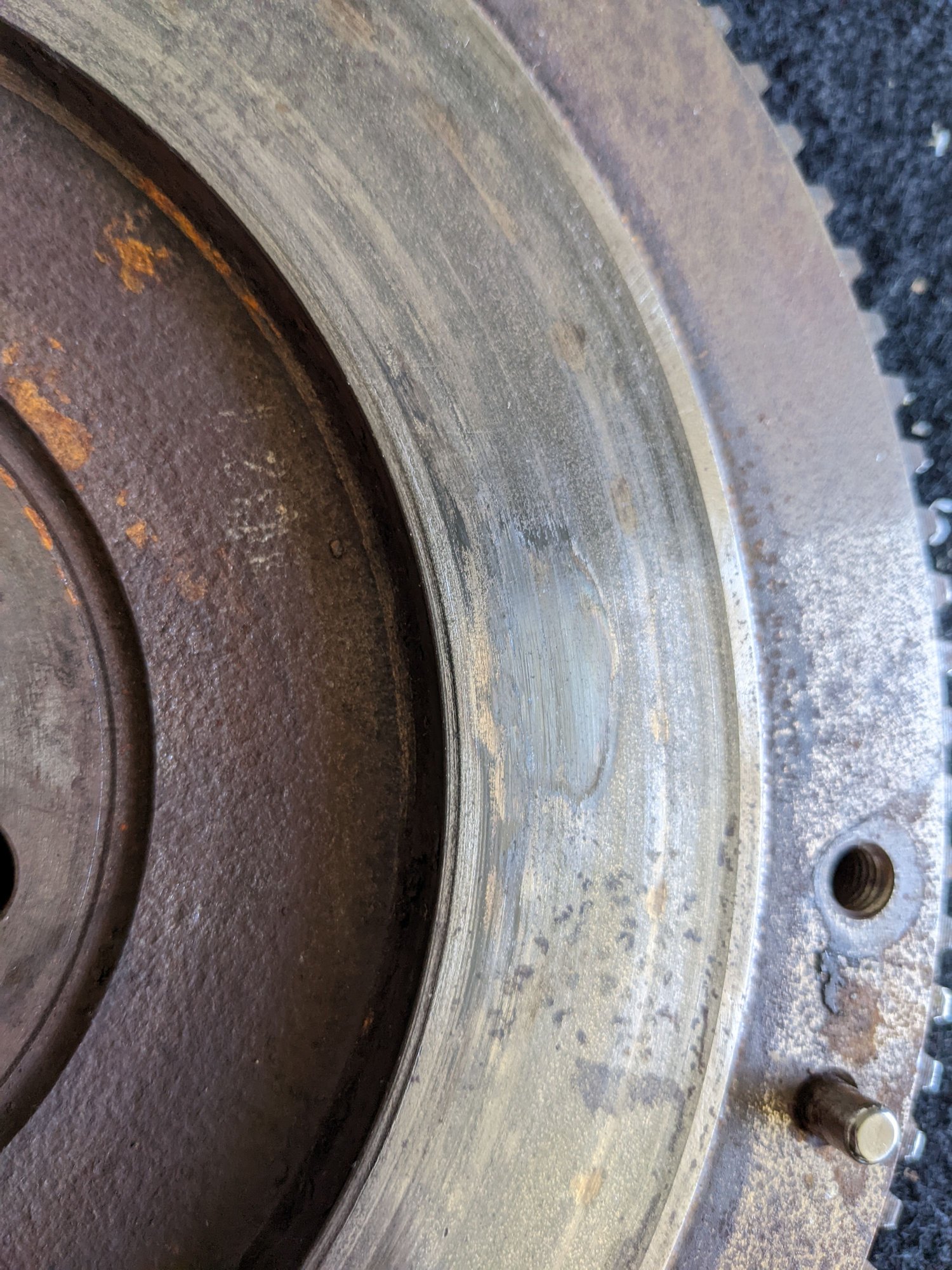

Hey guys. just want to get some opinions on if I can resurface this flywheel. what's concerning me is the lip that's been created around the edge. thanks.

Yes but with the caveat at that depth I'd have the whole face skimmed and the shoulder set back down again

They're going to have to match the shoulder (where everything bolts to) down to the same depth as the flywheel
The clutch PP bolts are going to protrude more than they should.
Idk. I would just let this one go. Buy a new flywheel
It looks like you used a metallic friction disc? That makes the PP and flywheel a 1 time use item.

I vote for a new OEM one and be done with it. Might as well go OEM on the rest of re-build.replacement.

I've took more than that off before....
