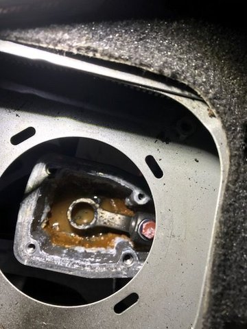

So, backstory was that I got transmission fluid changed at a shop here in San Jose, and the next few days afterward I noticed that the shifter wasn't locking reverse out while trying to shift to 5th. Noticed that when warm, the shifter wouldn't pop up without me having to pull on it. Wasn't too bad, so I erroneously left it alone because.... my wife had our first baby the next week!
After things had settled down, I looked up the shifter regrease DIY and felt it'd be a good opportunity for me-time, so I set out to get it done instead of calling Blacktrax about getting it fixed.
Fast forward to today, I removed the 3 bolts holding the shifter down, and the shifter didn't pop up like it should have. As hard as I pulled straight up, even with the shift knob back on, the shifter just won't budge.
Any ideas???

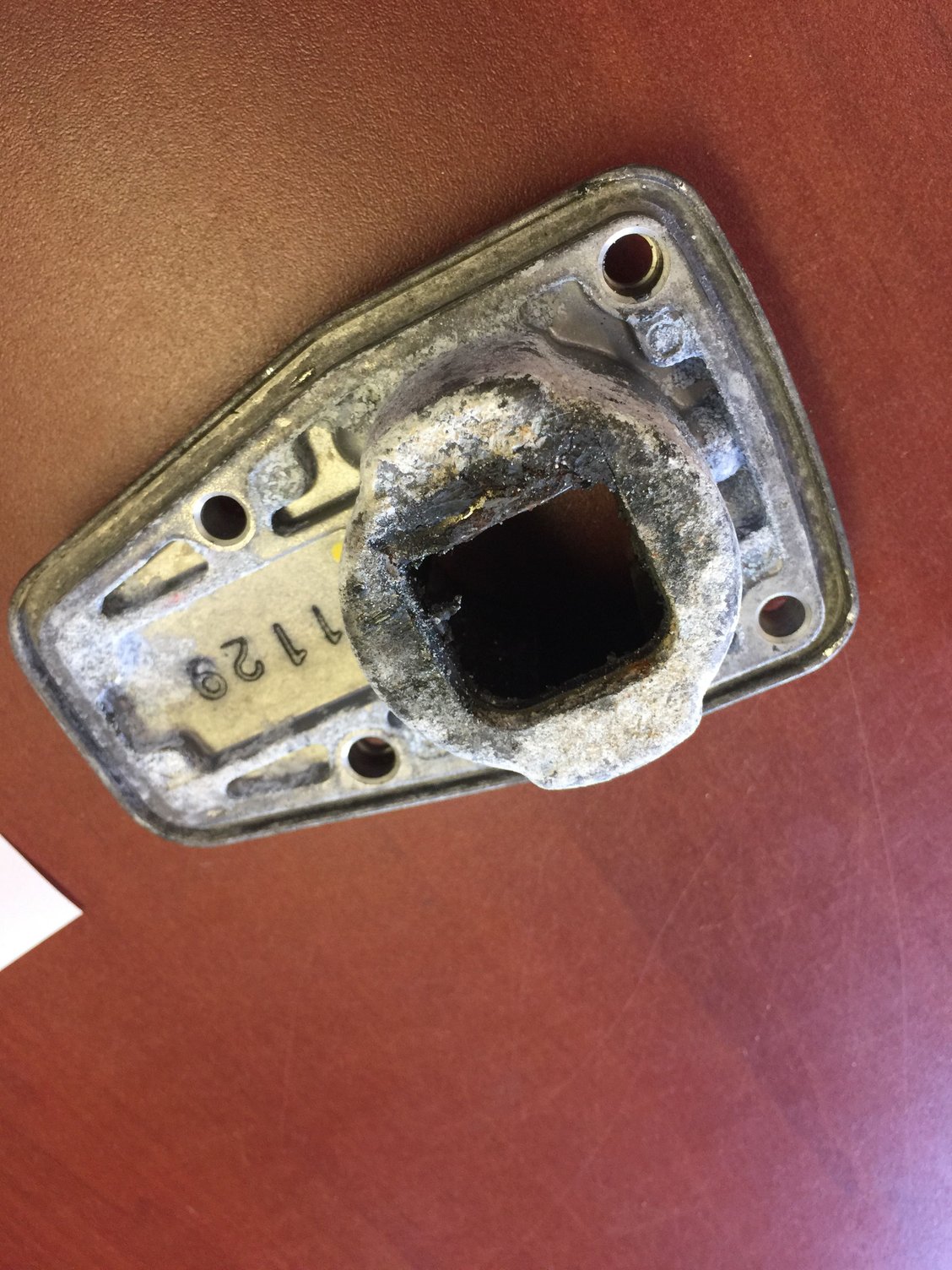

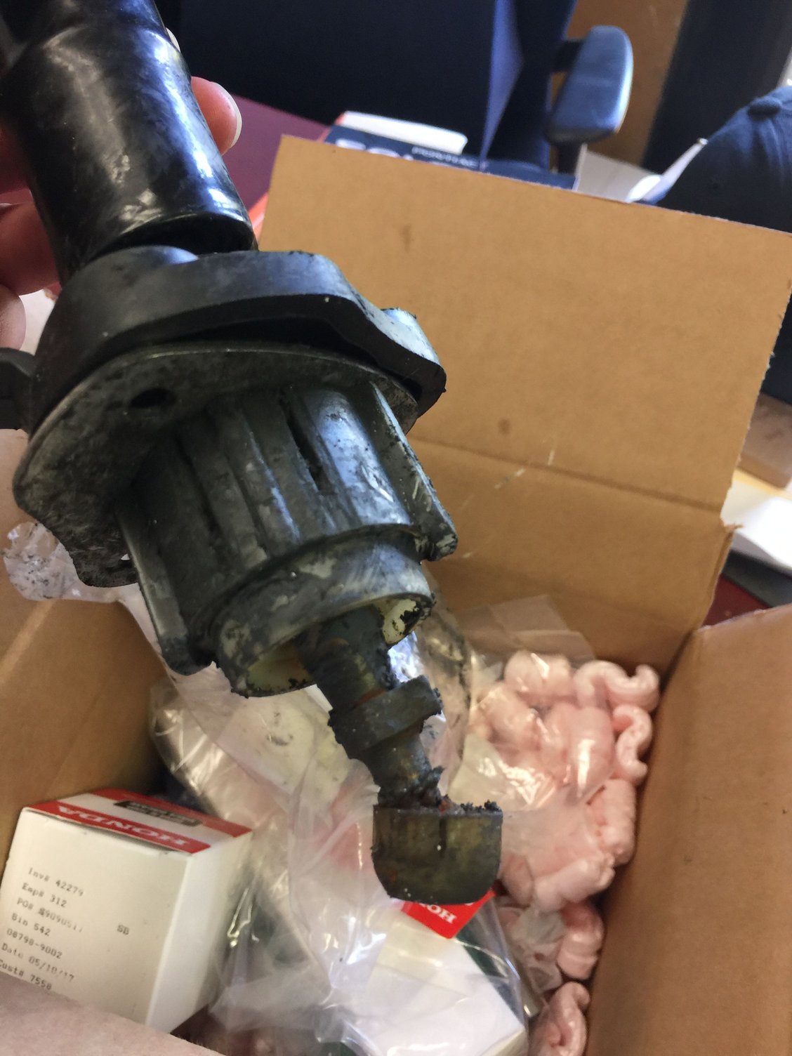

Ok, so I took the car back to the folks at Blacktrax, as I still couldn't take the shifter out, regardless of how hard I pulled. They called me back later in the day, and got the info on how bad it was: they had to lower the housing to get it out. There was no way I could have taken it out myself.
The culprit... water damage!
My hardtop was stolen over christmas break in the rain, and had been driven in heavy rain around that time as well, so water somehow got in the shifter box (there's no gasket). So imagine the gunk soup that was made from the hot water and grease. The tolerance gap between the fork and the shifter's ball assembly had rusted a bit, which made it so difficult to take out. They cleaned it up as much as they could, changed the parts with those I provided, and even threw in a new shifter.
Felt good as new, but still gets stuck in when depressed after getting hot, though it pops back up when cooled.
Be careful driving in heavy rain, y'all.
