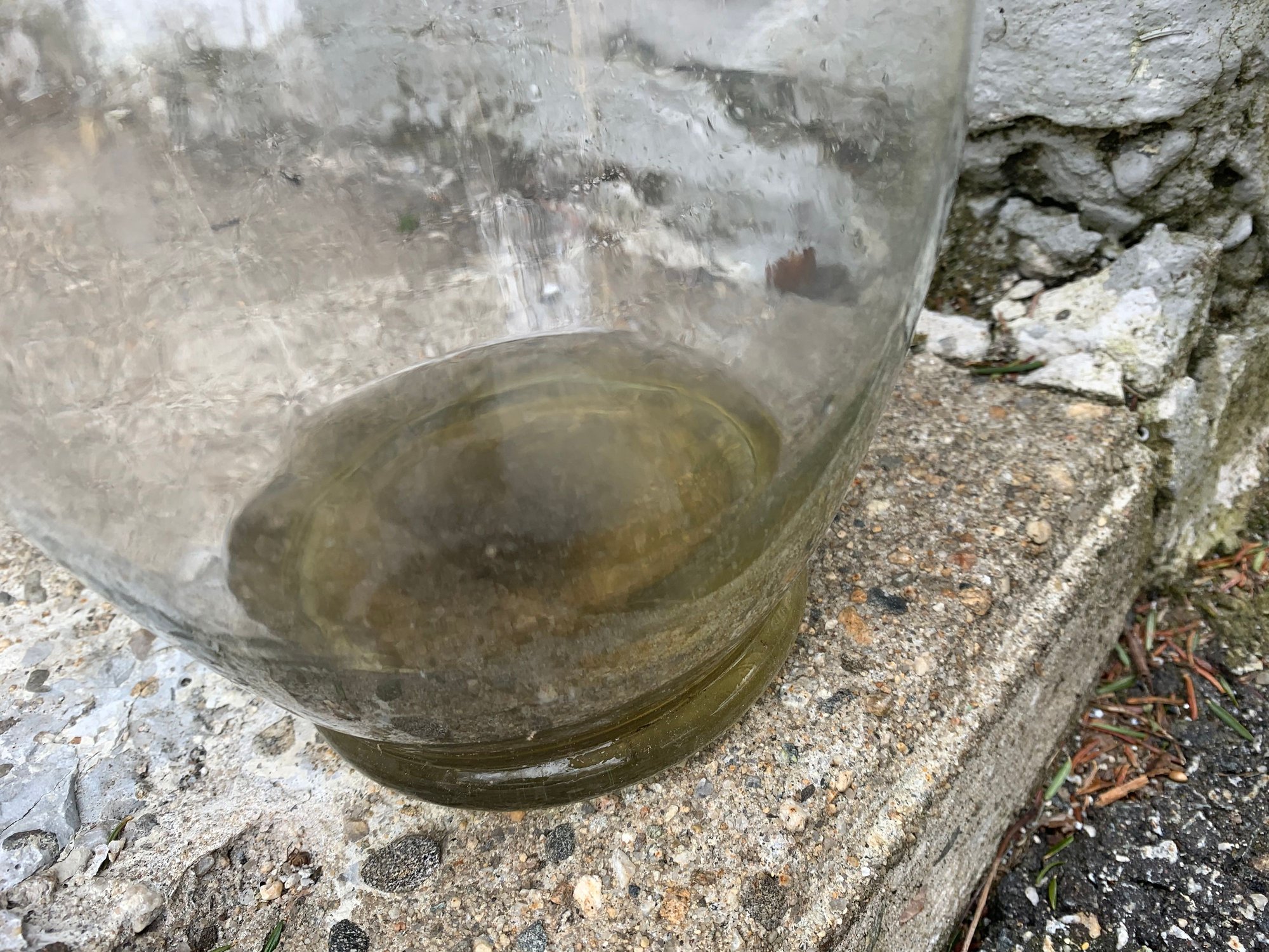

update: flushing clutch (brake) fluid 4 times with turkey baster method and topping off to correct level appears to have fixed the problem. shifted effortlessly into reverse and other gears afterwards. used ate typ200 (DOT4)
can anyone explain to me why this system can lose fluid simply because the fluid is dirty —have seen credible folks mention this
low and dirty fluid before flush
dirty fluid

I don't think it is fluid loss that effects the pedal movement, when the fluid is dirty. The dirty fluid changes the smoothness of the action of the seals traveling through it. Makes the action "stickier."

The black stuff is seal material wearing away. That's why you lose fluid some times. The worn but not yet failed seal allows some fluid past.
