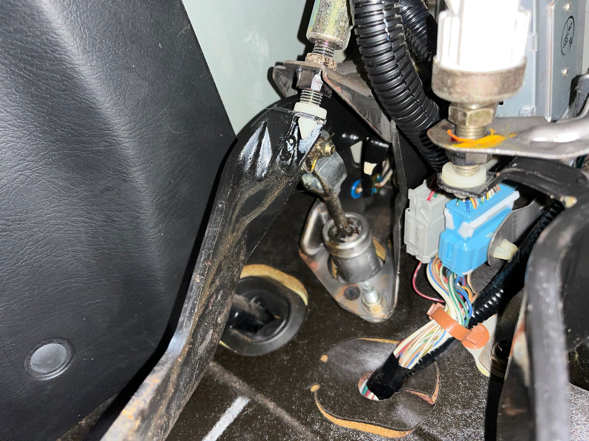

Good news. Turns out my clutch isn't as bad as I thought. It's my clutch master cylinder that started to go bad, that was causing the engagement to feel bad. I checked the reservoir and it was almost completely empty. So I topped it off, cleaned out the crud, and bled the slave. I inspected the interior side and there is evidence of fluid leaking from the plunger. It's performing good enough for now. I may just return the clutch kit to Rock Auto and get a new CMC for now. That'll save $1100+ for now, money I can put towards driver training.

Easy to see, that seal is gone

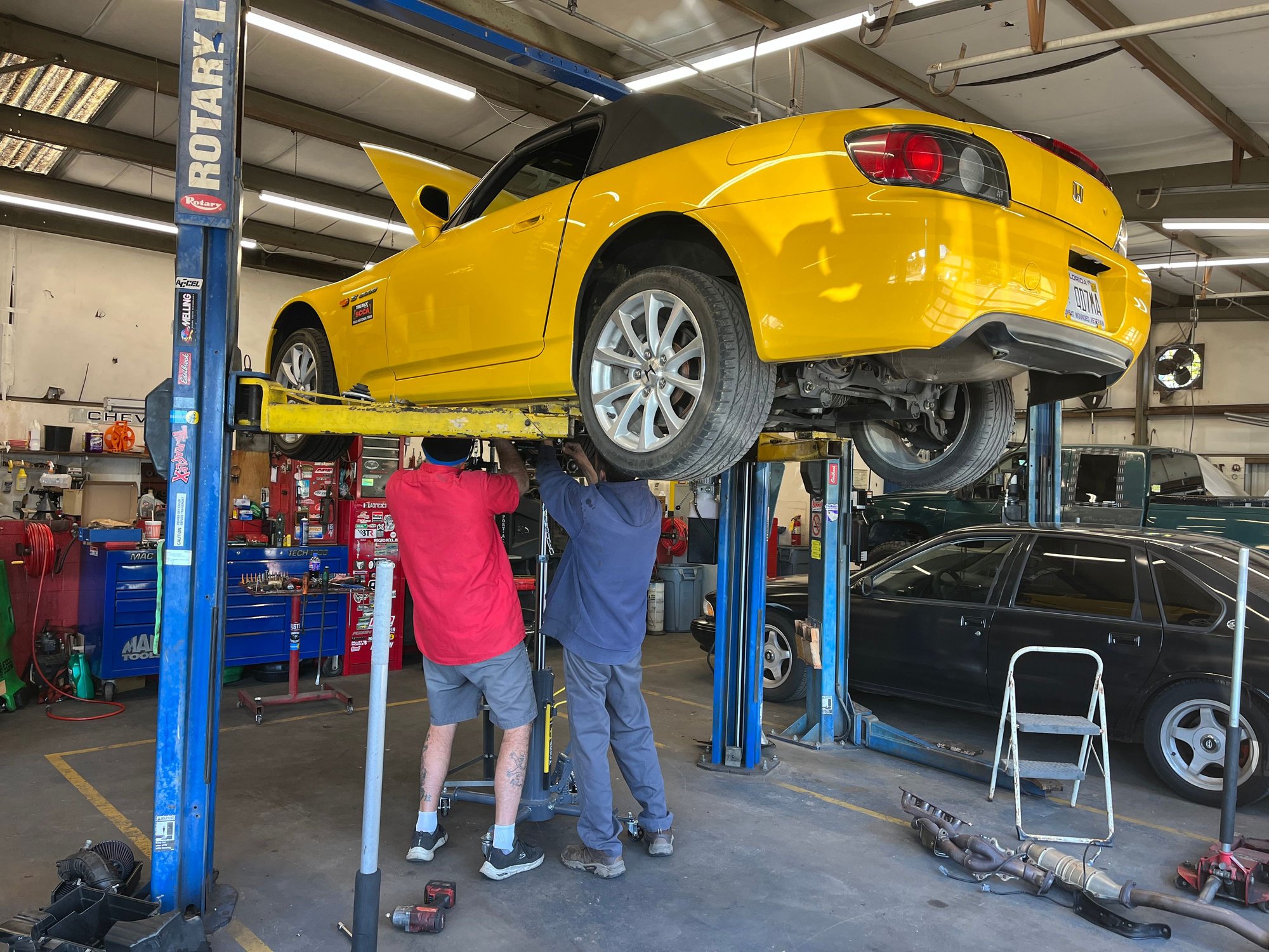

Default Old clutch coming out

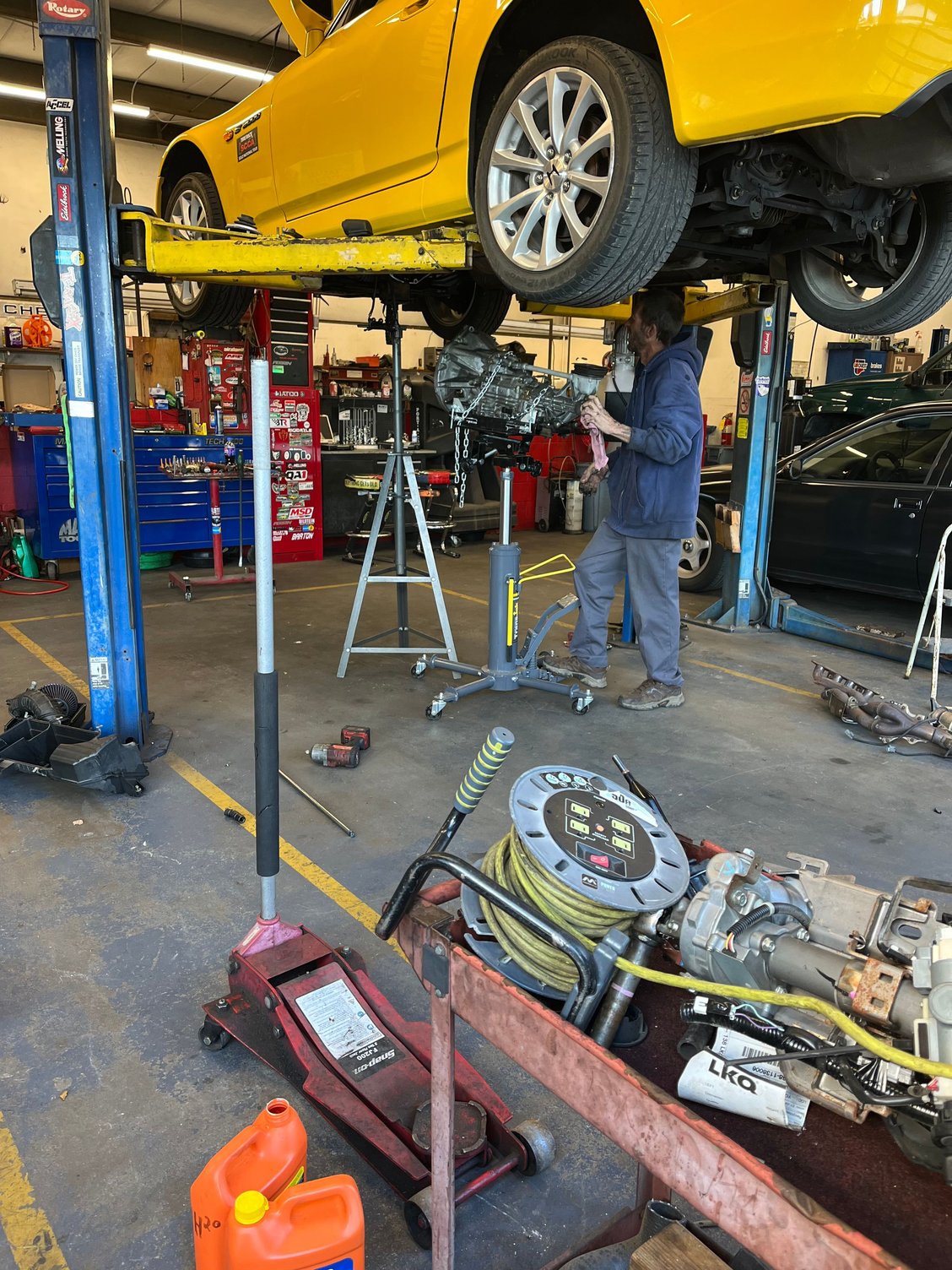

it took Chris the morning to get to here. Only thing that broke was the plastic retaining clip for the rubber shift boot. New one was $4, should be here next week.
Chad and Chris working on getting the trans separated.
Got a little hung up on the tunnel but Chris got it out eventually.

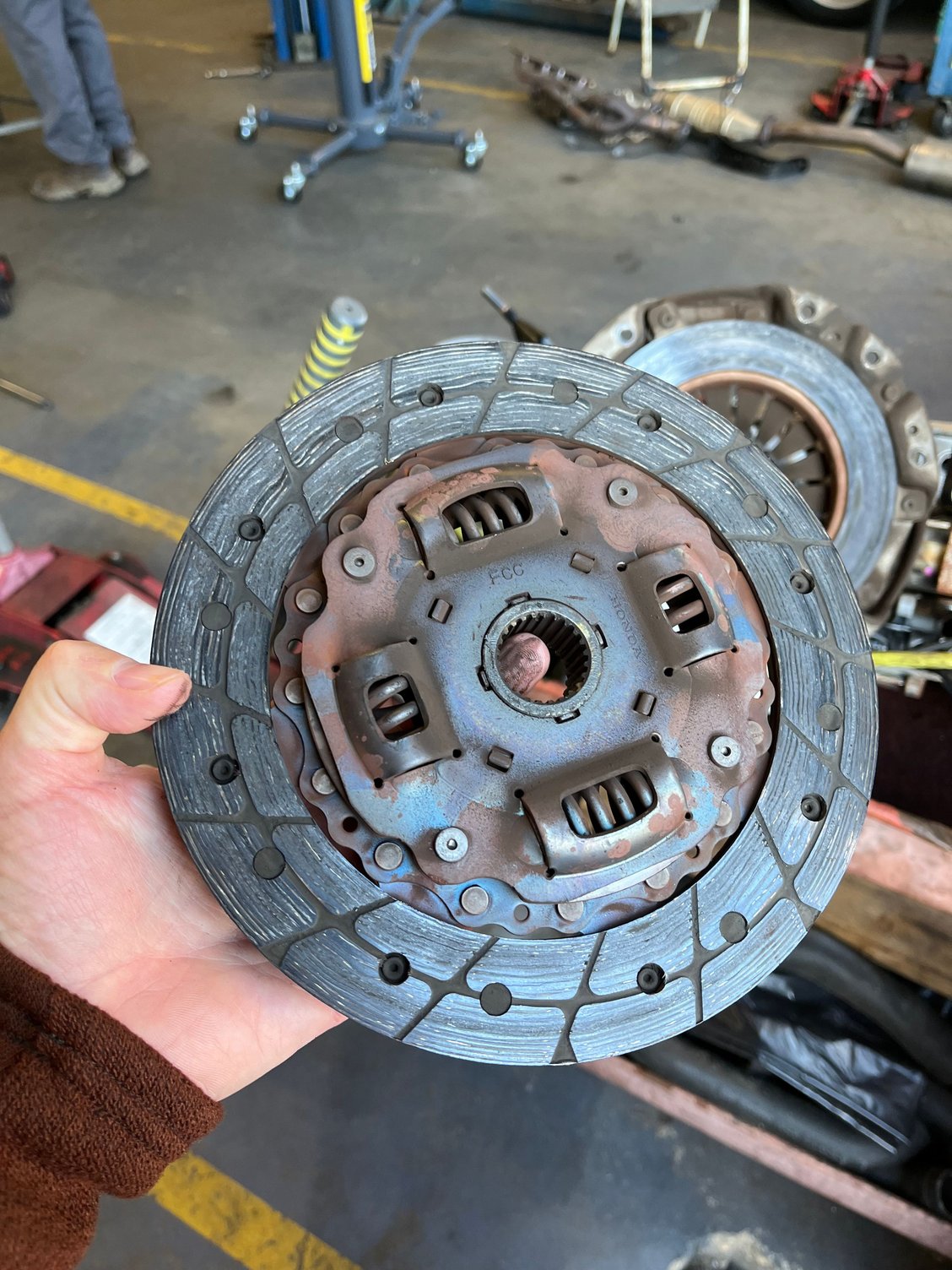

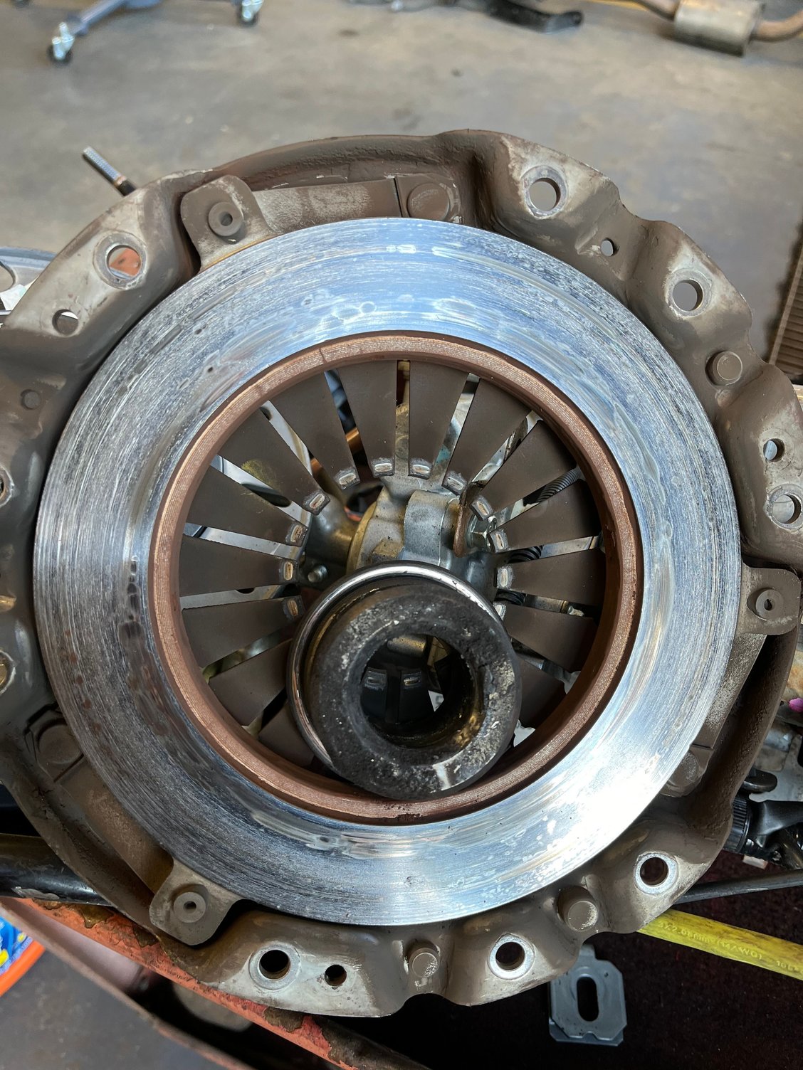

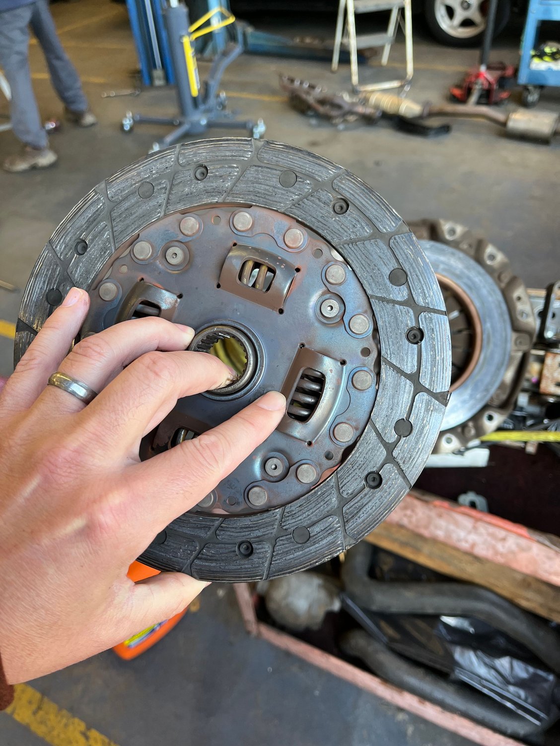

Old pressure plate and throw out bearing
I’d say this disc could have lasted another 10-20k of gentle driving but that ain’t how she gets run these days.
Flywheel side of the friction disc

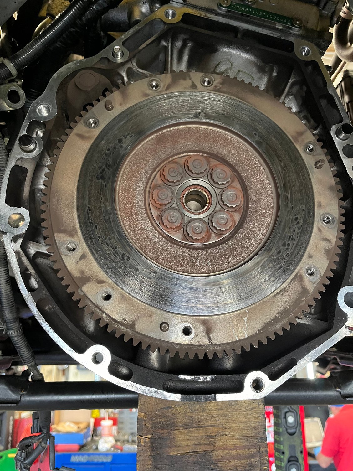

Unfortunately I don’t have a machine shop in town that can resurface the flywheel. It’s flat so we are going to scuff it up for the new disc.

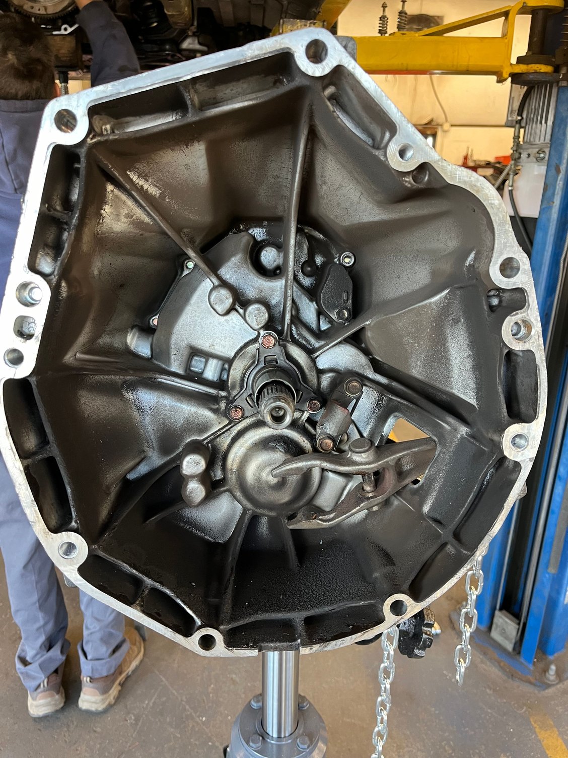

Dirty but no chunks. Trans will get cleaned and regreased. Should be feeling good as new once it’s all buttoned up. Ready for another 100k miles.

This was the original disc, right? How many miles?
You putting on another exhaust system, too?
Thanks!
Old Dec 29, 2023 | 05:43 PM
Dibsen's Avatar
Joined: Aug 2023
Posts: 800
Likes: 277
Thanks!
yes, 123k miles. Car had two mature (read old) drivers before I got my hands on it. I haven’t decided on an exhaust system yet
