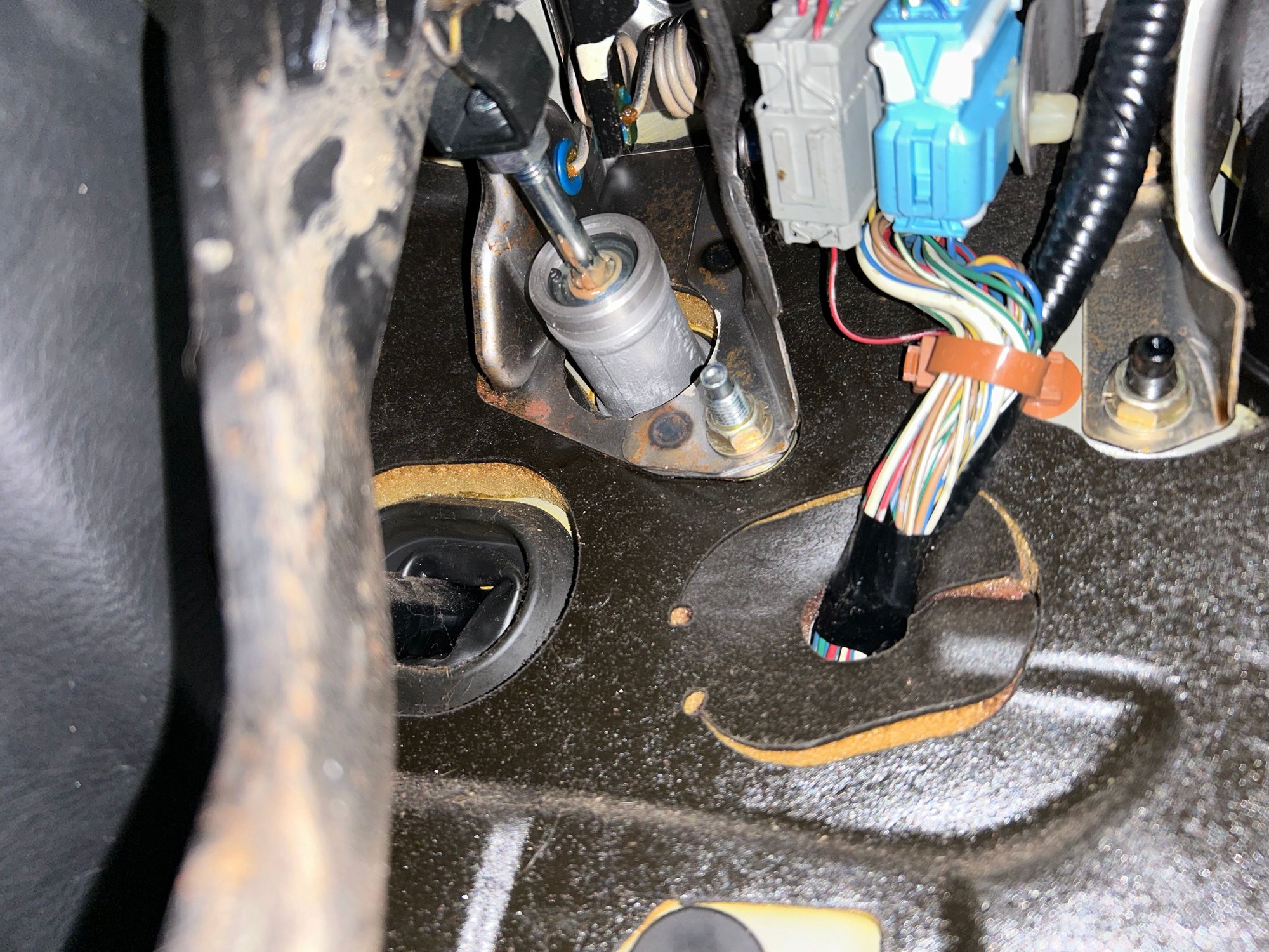

Well. Take a look…
This was a brand new, oem, nissin CMC. I’m shocked but it appears to be leaking.
You can see evidence on the clutch pedal but, I didn’t clean it off previously. Now the seal doesn’t look as cruddy as the old one but, it looks to me like it leaking.
Where else would the fluid have gone?
pretty sure I saved the stocker but, should I see about getting my new one replaced for prematurely seal failure?
I didn’t think I’d be dealing with this again. Not for another 100k miles anyway. It’s been like 3k
any suggestions?

Is there a possibility that the plunger needs adjusting?
Could it be coming too far out causing the leak?
there is some play in the clutch but doesn’t seem excessive to me.

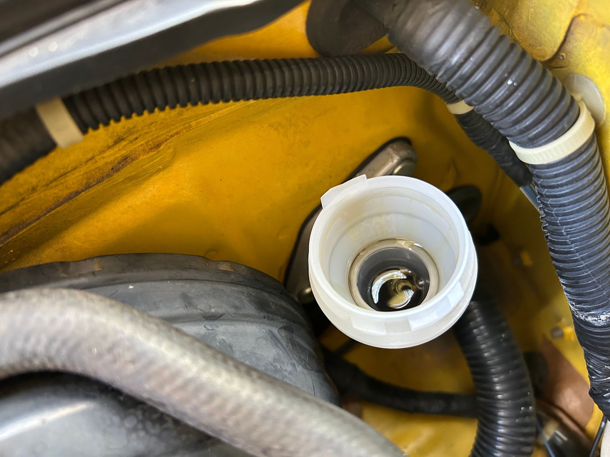

I would flush the reservoir a few times, until clear. Refill it and closely watch the level.
Do you see any leaks on the floor near the slave cylinder or on the footwell by where the master fits into the firewall?

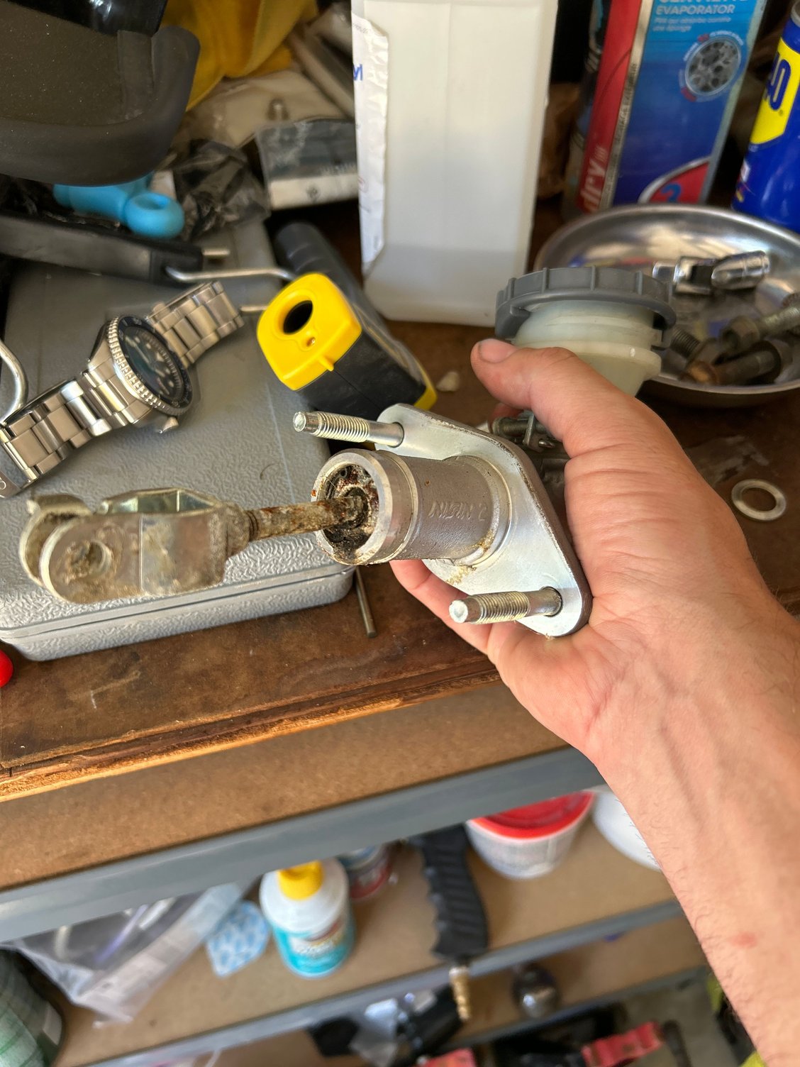

Probably your slave cylinder. I blew my slave after changing out my master, it just went out like a light switch.

It’s the slave.
here was the factory CMC that I replaced.
Here was the stocker. If anyone has a link to the parts/seals to rebuild, please send.
I ordered the CMC from HPN.

Take it apart to check size and condition of bore first
it’s probably corroded but I’ll give it a looksee
