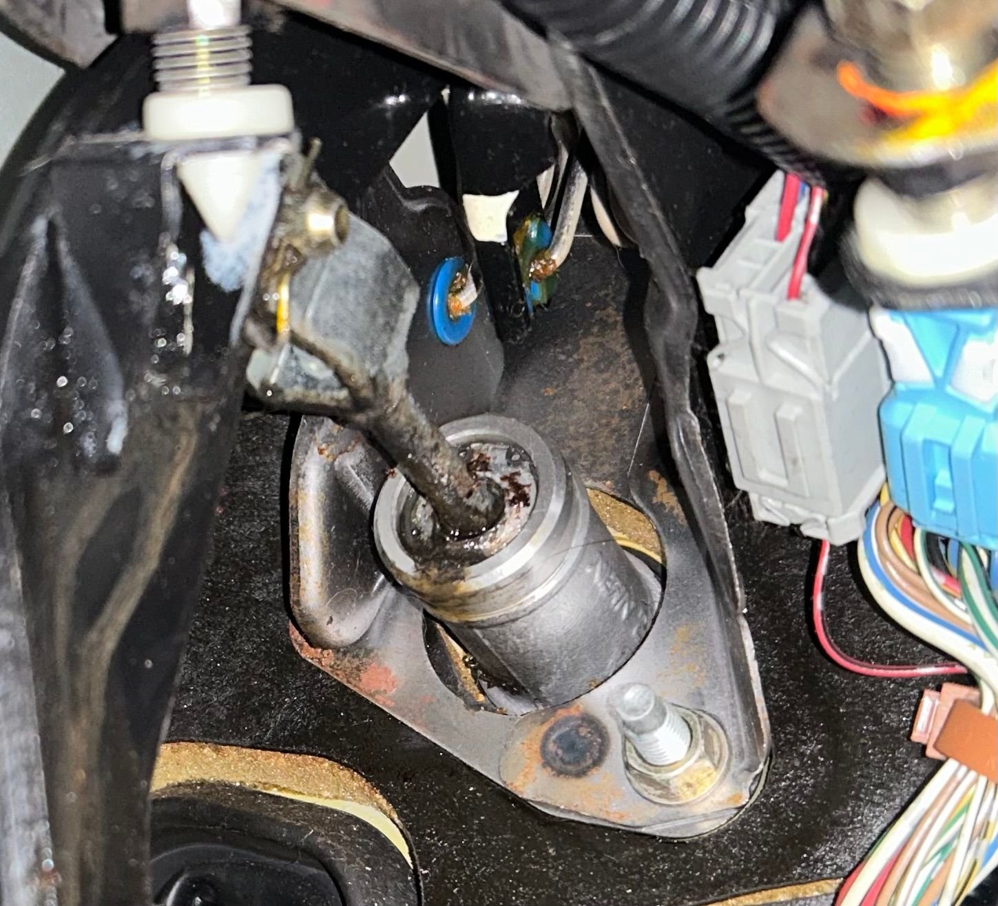

Got my CMC tonight. I’ll see if I can swap it out tomorrow morning.

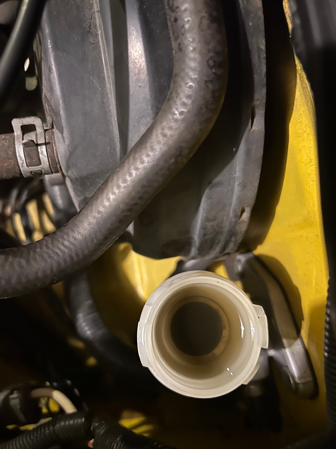

That was new fluid just a few weeks ago. It’s not too bad but you can’t really see the bottom.
By the looks of it, this seal has had it!
