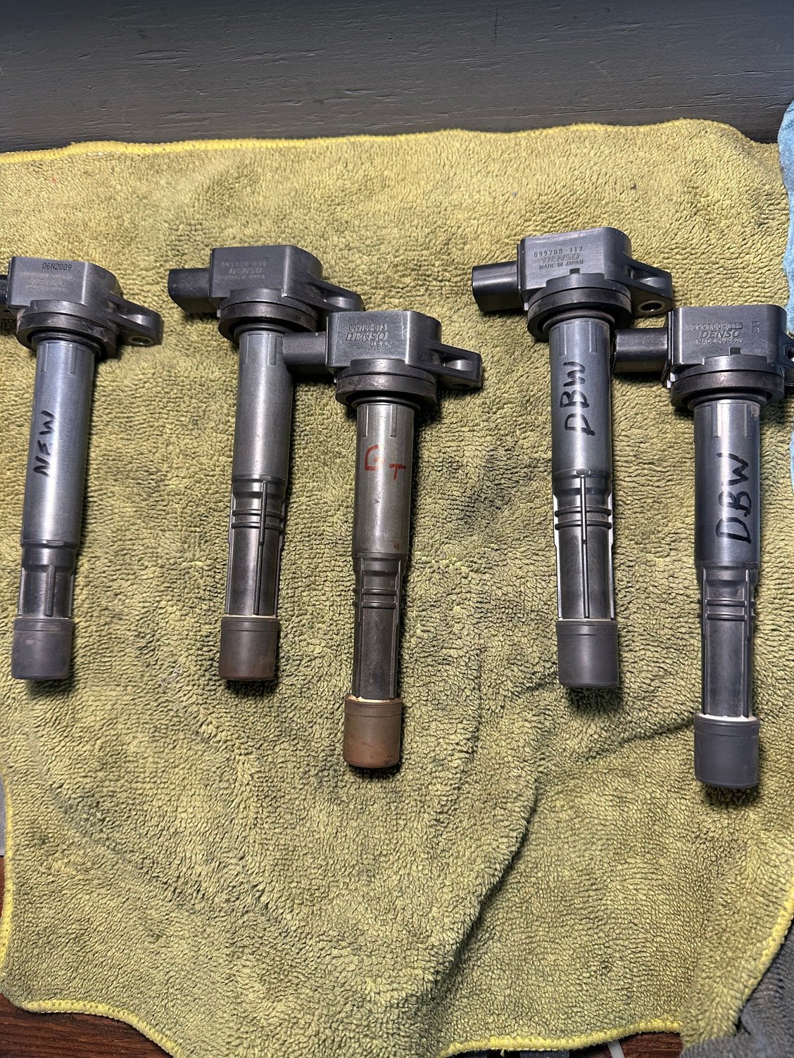

I have about 40 S2000 coils here. NOTE their physical appearance. This is everything:
1- 099700-430 AP1, all coils have this number
2- 099700-070 AP2 (04-05) All coils have this number
3- 099700-073 AP2 (04-05) “Rogue part”, only one I have
4- 099700-117 AP2 (06-09) all coils have this number
5- 099700-115 R AP2 (06-09) “Rogue part”, only one I have

Originally Posted by 9KCanuck
So it looks like OP got the -115R coils when ordering Denso part #2301.
If this follows Billmans observation, he has an 06-09 coil and will experience damage by running them.
@9KCanuck have you installed these already?
@Billman250 are you aware of any multimeter testing that would verify presence or absence of the resistor?
Next week I will OHM them out and let you know.
I've installed one and ordered 3 more after I saw that it fit and the car started up and idled fine. I didn't drive it.
From what I can tell, this is not an error or mislabel. Denso 2301 = -115R coils = '04-'05 part. Maybe in the past this wasn't the case, I have no idea. It would be good to see an 'old' Denso 673-2301 to compare with what I received. But every site and post/comment/etc. I have found confirms that these coils are meant for the '04-05 S2000 and that has always been the case.
If you're an owner of an '00-03 S2000 and need to buy new ignition coils, your options are limited. Anything that is explicitly for an '00-'03 is very expensive, whether that's the original -2300 Densos or the NGK equivalent. I don't know of any other brand folks here would consider.
Denso product pages:
673-2300 '00-'03 -- https://www.densoproducts.com/denso-...-ignition-coil (Discontinued)
673-2301 '04-'05 -- https://www.densoproducts.com/denso-...-ignition-coil
673-2304 '06-'08 -- https://www.densoproducts.com/denso-...-ignition-coil
