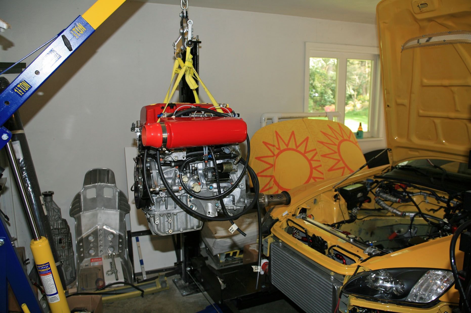

Another way is to use a couple of strong nylon tie down straps and wrap them arround the botton of the engine. I used this method a few weeks ago to put my engine back in the car with the intake manifold and exhaust manifold with turbo attached.
are those straps on the bottom of the engine or around the intake and exhaust manifolds?
Old Mar 18, 2010 | 12:49 PM
Stratocaster's Avatar
Posts: 11,399
Likes: 19
By the looks of that pictures, each strap goes around each manifold.
Old Mar 18, 2010 | 01:11 PM
fperra's Avatar
Posts: 3,178
From: Washington State
That is correct.
