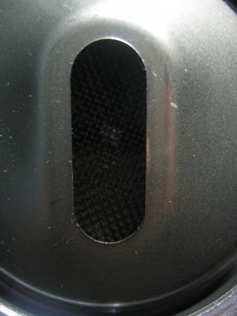

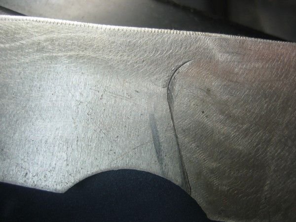

It looks like I forgot to post the pics here from the TCDesign thread over in Racing & Competition.
I matched the markings on the broken pan baffle with the oil pickup:

the oil sump sucks hard enough to leave marks like that?

Yup.. WOT Oil pressure is over 120psi on a healthy engine. The aluminum baffle dents easily compared to the steel pickup tube.

so you were right, there it is. and it didnt block it completly, just enough to starve it. damn. time for a rebuild. lots of goodies can go in now.
