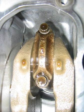

I finally made time to crawl back under the car last night. Here are pics of the rod caps:
the oil pump pickup made removing the #1 rod cap more trouble than I wanted to deal with, so I just pulled 2-4.
#2 rod bearing
#3 rod bearing
#4 rod bearing
I considered removing the lower portion of the block with it in the car, but it seems that requires removing the oil pump, which requires removing the timing chain. I think I'll wait until I get the motor out of the car for that. I'm shopping around for a lift to make the job a bit less painful, so it will be a while before I make any further progress.

the bearings dont look bad...could it be more serious like your main bearings?

yeah, those pics are interesting, i dont see enough damage for you to lose 20+ psi of oil pressure all at once. def wanna see pics of the mains, and then if all is well, prob bad oil pump as you suspected.
if that lil trap door floated up, or was sucked onto the pickup, id say youd have a noticeable "during event" massive oil pressure loss, and within seconds catastrophic failure. those bearings look like they should at 80k. weirdness. then again, the pics are decent, but none of us can diagnos without being there to see the whole picture. still i hope all goes well and your baby is running again soon. later dave
note: popped into my head after i posted, usually struggling to rev, equals thrashed rod bearings, and thats where your at as of now, yet you havent even worn through the babit yet. pull off your vtec solenoid real quick and look for debris there. that will be a good indicator. last set of s2k rod bearings i saw go away, vtec solenoid screen was full of copper shavings.
