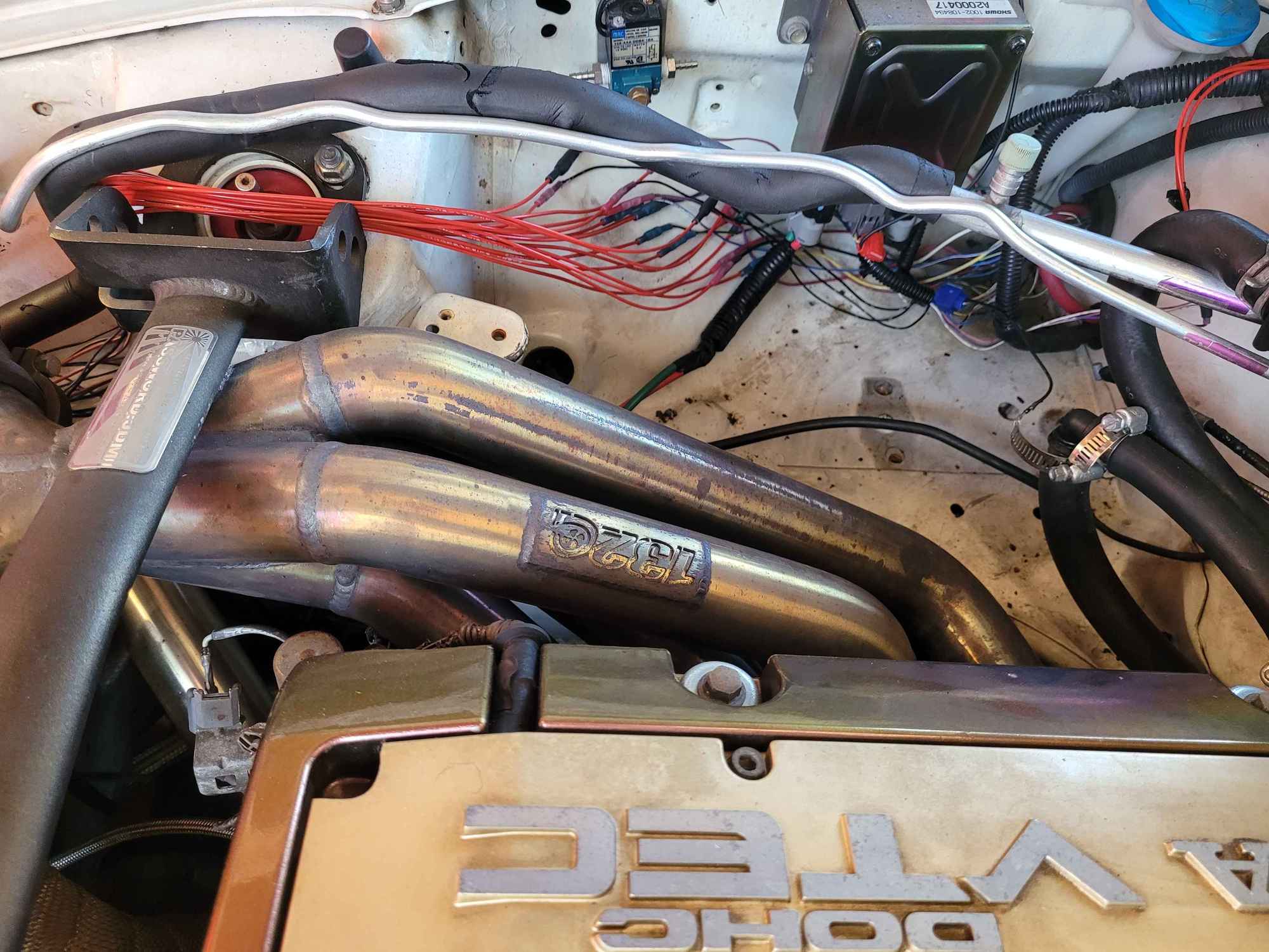

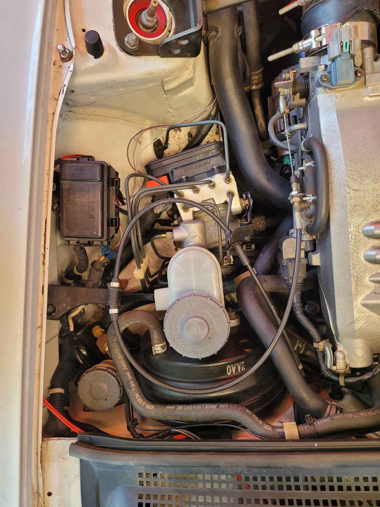

So yesterday and today I finally got around to cutting out all the wires that were stuck together. I rerouted the FR/FL headlights and fan assembly up over the passenger side strut tower, and then the torque sensor wiring up and behind the fire wall and then came by the brake booster.(see pictures red wires).
All connections were done right and one at a time. I then reset the EPS module with pin 9 and so on. I had power steering, so I was gonna go take it on a test drive and as soon as I backed out and started turning the EPS turned off and EPS light came back on. I did notice that i could turn right but not left for some weird reason. I then tried to reset once more, and the light turned off but as soon as i touched the steering wheel EPS turned off. SO I said F this thing and took off the torque sensor because that was what everyone was telling me to do. I followed this guys instructions, https://docs.google.com/document/u/0...YE/mobilebasic .
After finally getting it pulled out and took apart, I see that it's not too bad, it moves freely up and down and does rebound. I will clean it though and regrease just in-case but it will have to be done tomorrow.
PLEASE I'll take any info I can get. Just a reminder wires were melted together and were defiantly shorting out. Maybe EPS computer fried? Sensor fried? I have no clue and I am really tempted to either drive without power steering or see if I can use the steering assist from a toyota prius (I've seen it done in a miata and doesn't look too hard.) I really hate the idea of the car steering by itself at high speeds. I want to be safe hahaha. Thank you to everyone and anyone that responds! May God bless.
