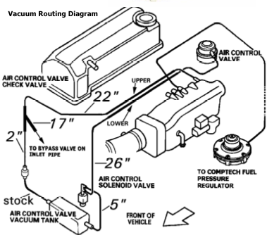

The little solenoid with two vacuum connections?
My guess is it's connected up wrong. It's the air control solenoid and your car will misbehave if it's not connected properly.
If you can still download the Comptech SC install instructions they have a great diagram of the proper connections.

actually now that i looked at the diagram, i broke the air control valve vacuum tank. i just jb welded the outside around the crack. if it isnt sealed then would that make my car seem like the timing was off?
