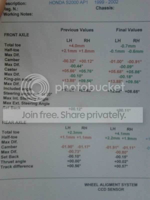

Ok so im just back from alignment and as Billman suspected the front castor adjuster was seized solid. also, one of the rear adjusters on the lower wishbone was not too good either..
they had a new alignment computer installed less than a yeaar ago, but it seemed to have the orignal factory settings , thats in the workshop manual, in the computer. I asked him to set the suspension to the Honda UK Recommended Settings updated January 2002.
Here is a printout of the final settings, have a look and let me know if it looks acceptable. I have a track day next Sunday and would like the car to be at its best..

Generally speaking you're fine....except the rear camber. Not enough on the right. In fact, they made it worse than when you brought it in!
Yeah the back lower camber bolt was seized and the front castor adjustment was seized. He thinks its a hammer out and destroy the bushing to get it free'd up then go through the alignment again.
