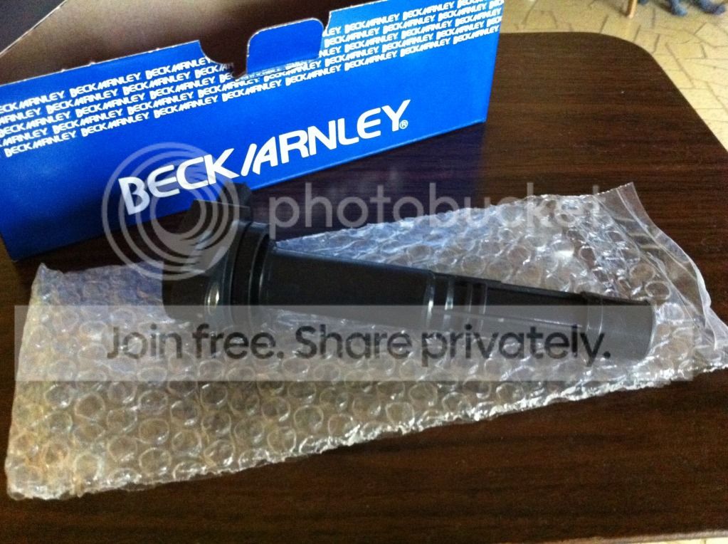

hey guys any thoughts on this coil packs? BECK/ARNLEY Part # 1788427 ordered from RockAutoParts $192.31 set shipped i just got it delivered here today but didn't open yet due to my CEL not coming back yet.(misfire issue)
EDIT: I opened the box just to see what the coil packs looks like, and it looks like ap2 coils.. but the catalog says its for HONDA S2000(2000 - 2003)
from Billman250's photo comparing ap1 and ap2 coils...
Originally Posted by Billman250' timestamp='1311104597' post='20794440
On left, AP1 coil.........................................on right, 2004-2005 coil. Note visual difference.
There are some chinese made coils hitting the market now - surprise surprise - at least one member had misfires on his car from using those coils and he had to purchase Japanese made Honda coils to correct the issue. Hopefully your's aren't the same.
