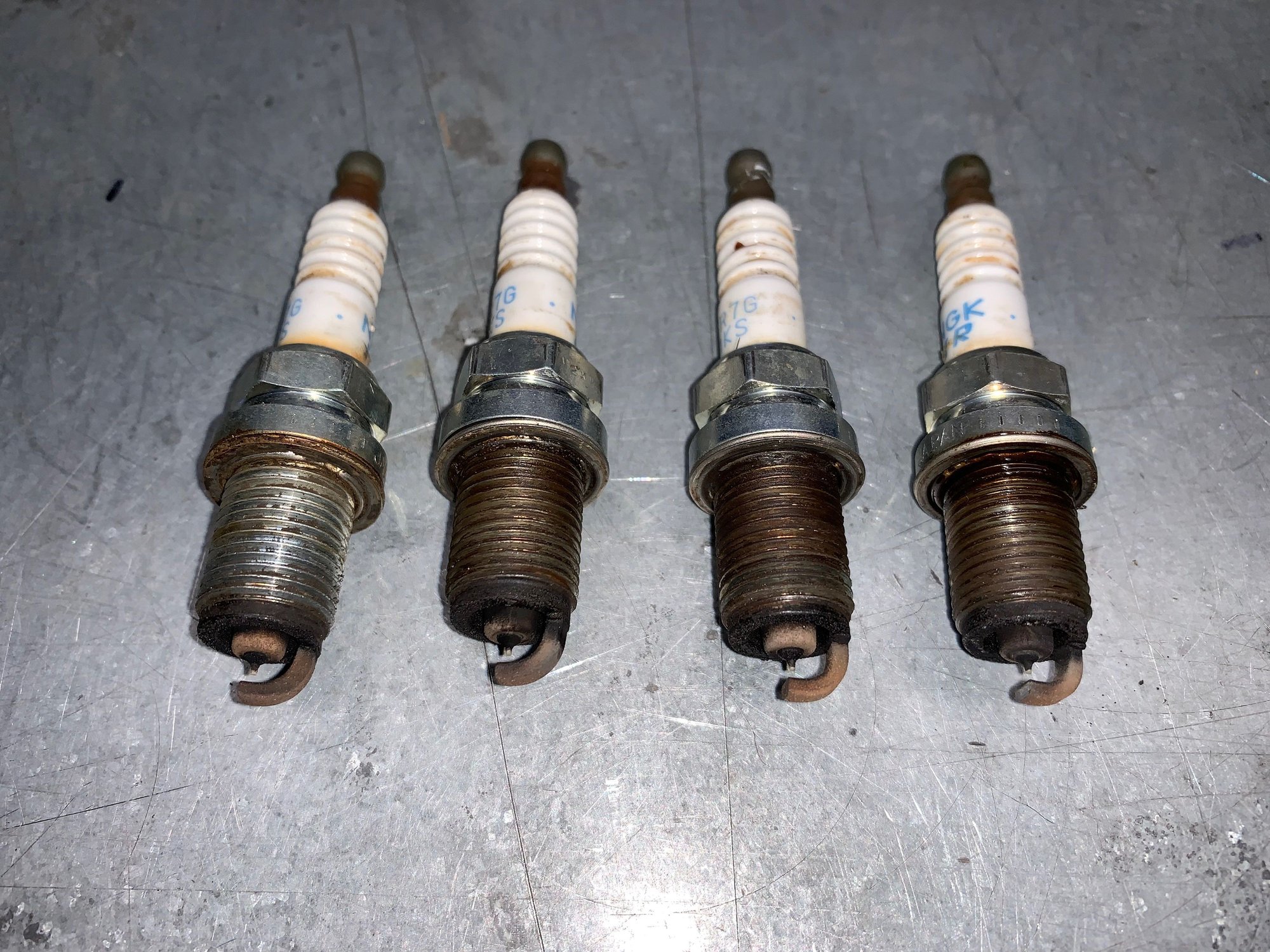

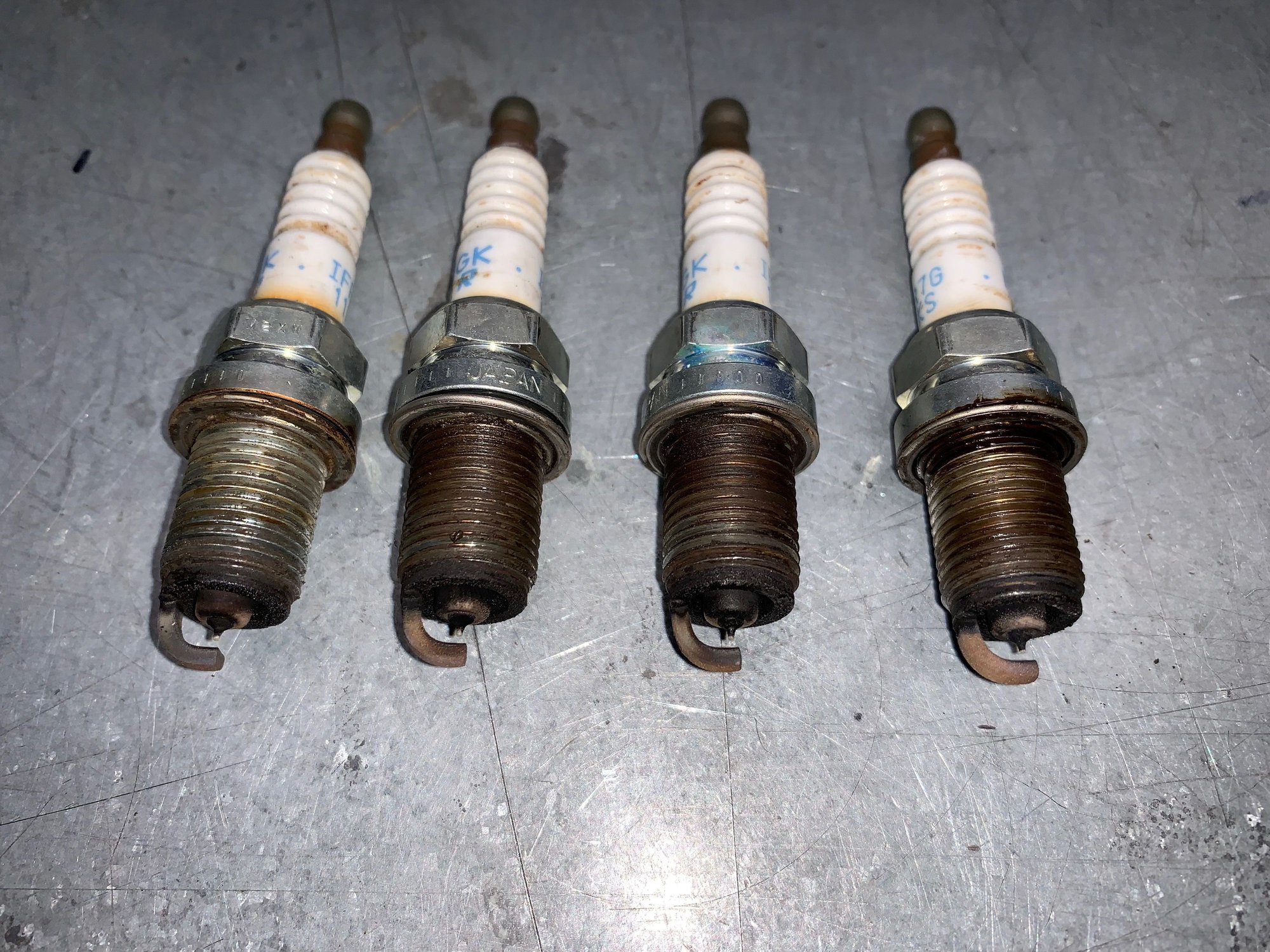

Here are pics of the plugs. From left to right cylinder 4-3-2-1. #1 has some oil up by the sealing washer due to that seal leaking a small amount of oil through the valve cover. I have new seals for that.
I'll get videos uploaded of the cylinder walls using a bore scope.

Yes dependent on how bad they are bent/not seating, but after looking at your plugs there is a substantial amount of oil fouling around the base of electrode which is from combustion not tube seals - though you still may have some tube seal issue as well. Id say you more likely have ring and valve guide/seal issues after looking at your plugs and that's where the air is escaping. But to better pinpoint this, you really should have the spark plugs in the cylinders you are not testing, this way it forces air through more concise pathways to tell you where the likely fault is, such as the front breather/crank meaning rings, or out the intake manifold meaning intake valves/guides, or valves on the exhaust side. You should be able to hear where the air is escaping.
