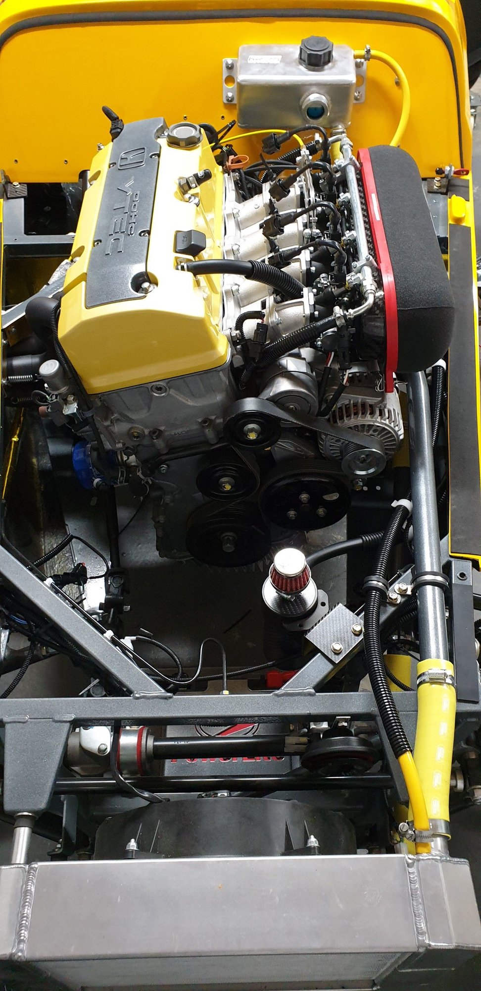

Just wanted your opinion on my Catch Can set up, have I done it right as im having my doubts now.
Iv got the PCV capped off & the VC vent running to the "In" section on the can & on the "Out" port, put a filter.

My understanding is there should be more vapor coming out of the PCV port (thus needs a catch can) more than the VC vent.

Route the PCV to another catch tank, you can remove the valve since that wont do any good except restrict flow.
PCV port is M14x1.5mm thread, same as oil pan drain plug if you want to get a straight through fitting.
