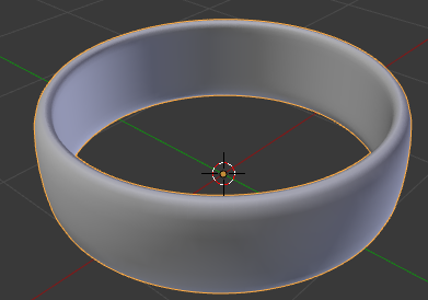

My old o-ring wasn't ripped but instead of looking like a torus, it looked like a flattened torus which surely wasn't applying enough compression against its mating surfaces, hence a slow leak. It was also much more rigid and not nearly as pliable as a new one. Billman, Soviet, and MP2K to the rescue!
Torus (Good)
Flattened Torus (Bad)
I hope MP2K won't mind for stealing his picture, but this picture really helped me understand how to do this procedure. This is as far as the bolt needs to be backed out to do this job. Then replace o-ring and torque to 36 ft-lb or 432 in-lb. I use a smaller torque wrench that reads in in-lb for jobs like these to get better torque accuracy.
