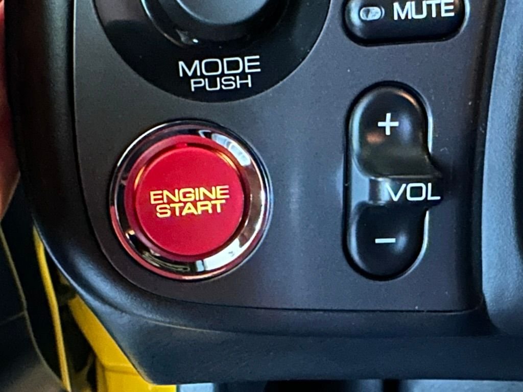

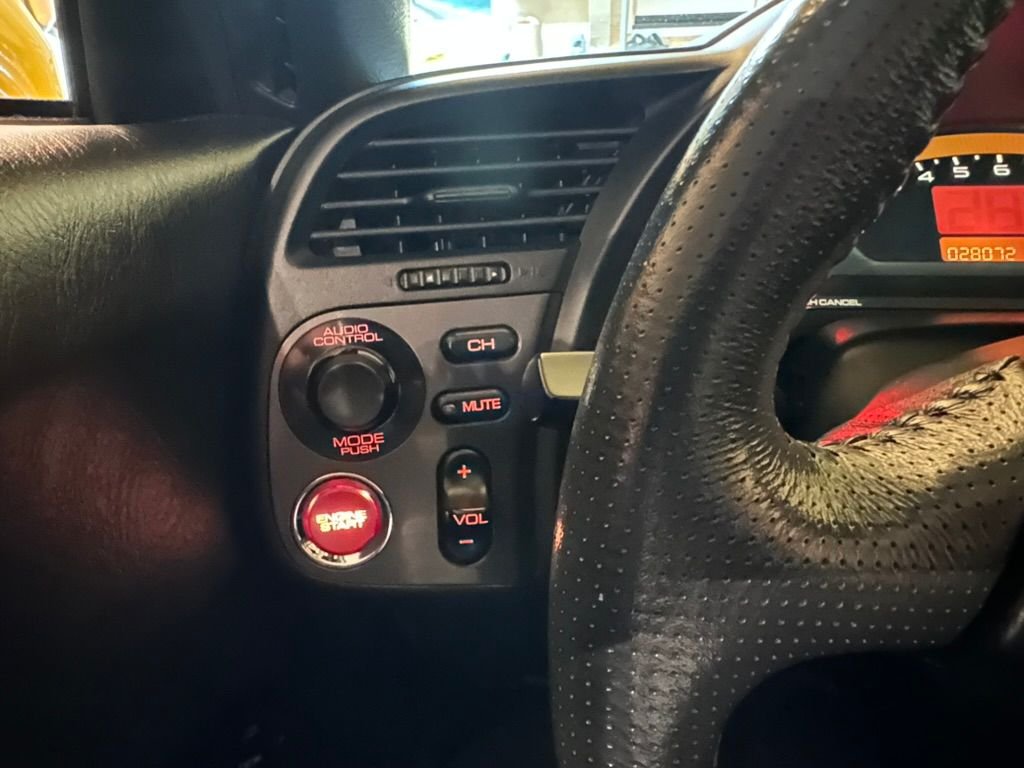

Noticed that my the engine "Start" button light burned out (AP1's and AP2's should have it illuminated).
Most thread say you have to take out the dash to remove the button and to service the light.
I was able to remove the button just by unclipping it from under the dash.
You'll have to contort yourself to get a good view but the goal to the squeeze the metal, gold-ish colored table on the side of the button. You can see it just peeking out from the fascia. You can either squeeze it hard or put a thin plastic tool into the tab. It is the only thing keeping the Start button connected to the dash.
You'll have to contort yourself to get a good view but the goal to the squeeze the metal, gold-ish colored tab on the side of the button. You can see it just peeking out from the fascia. You can either squeeze it hard or put a thin plastic tool into the tab. It is the only thing keeping the Start button connected to the dash.

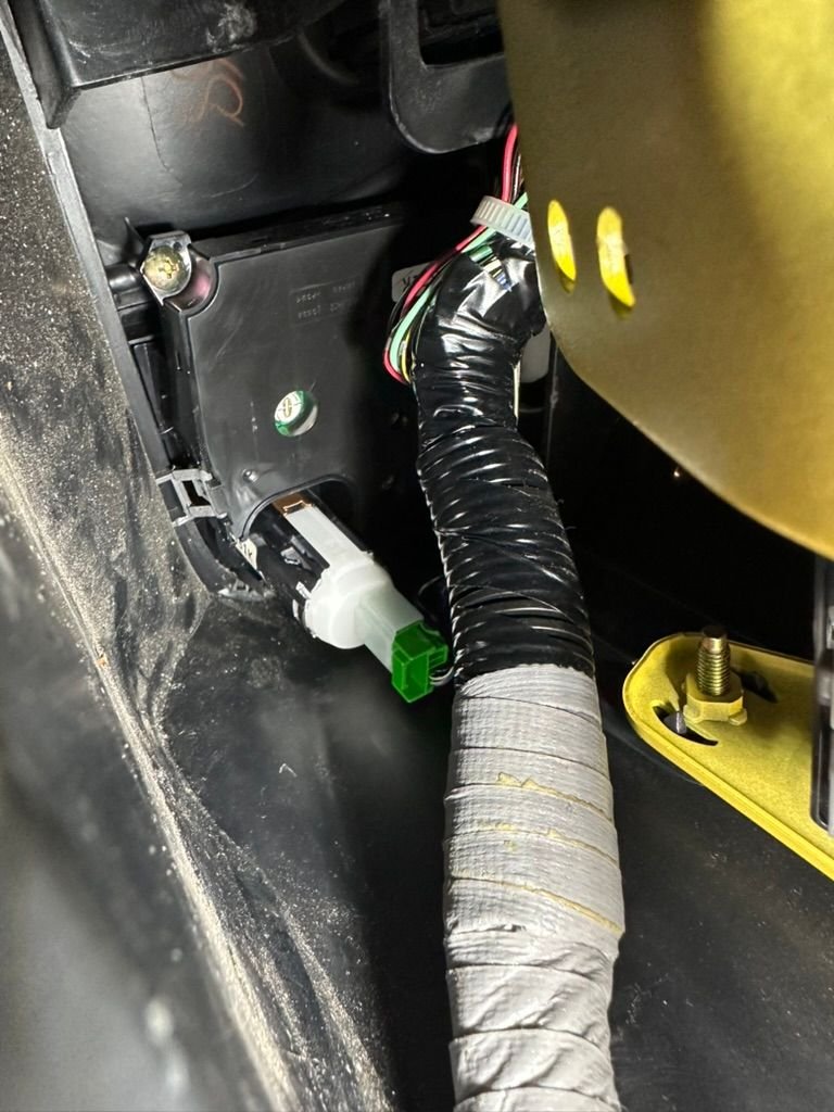

[img alt="This is the tab you need to push. There is a bump on the other side of the housing that help to align the button but you do not need to squeeze it.
Well pushing the button out, it helps to angle it slightly towards the door."]https://cimg2.ibsrv.net/gimg/www.s2ki.com-vbulletin/768x1024/6a0281d2_38c5_46e3_808b_c24f360469e9_1_105_c_3c81f 46ddf423178eebb7e83d280a2fc8fc57501.jpeg[/img]
This is the tab you need to push. There is a bump on the other side of the housing that helps align the button but you do not need to squeeze it. While pushing the button out, it helps to angle it slightly towards the driver's door.

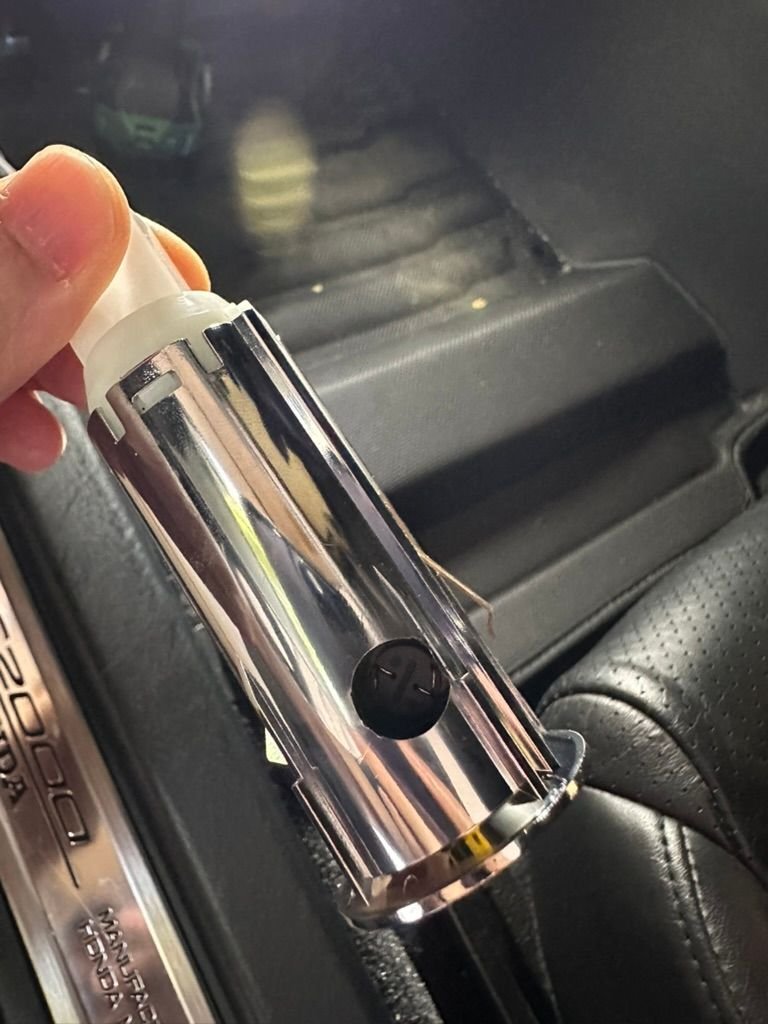

Next to the service hold to replace the bulb is the housing tab. You don't need to mess with it.
Next to the service hole used to replace the bulb is the housing tab. You don't need to mess with it.

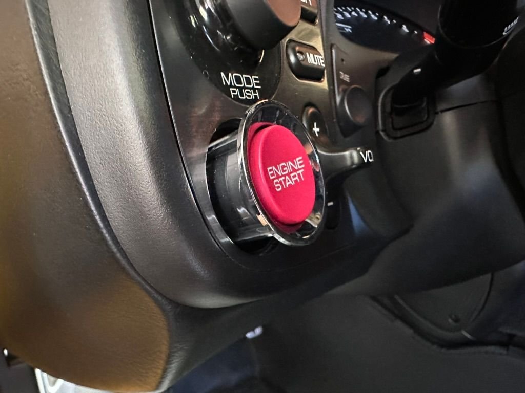

While holding down that metal tab pretty hard, the button popped out without much pressure.

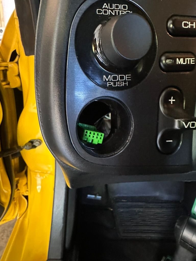

All that's left is to disconnect the cable.

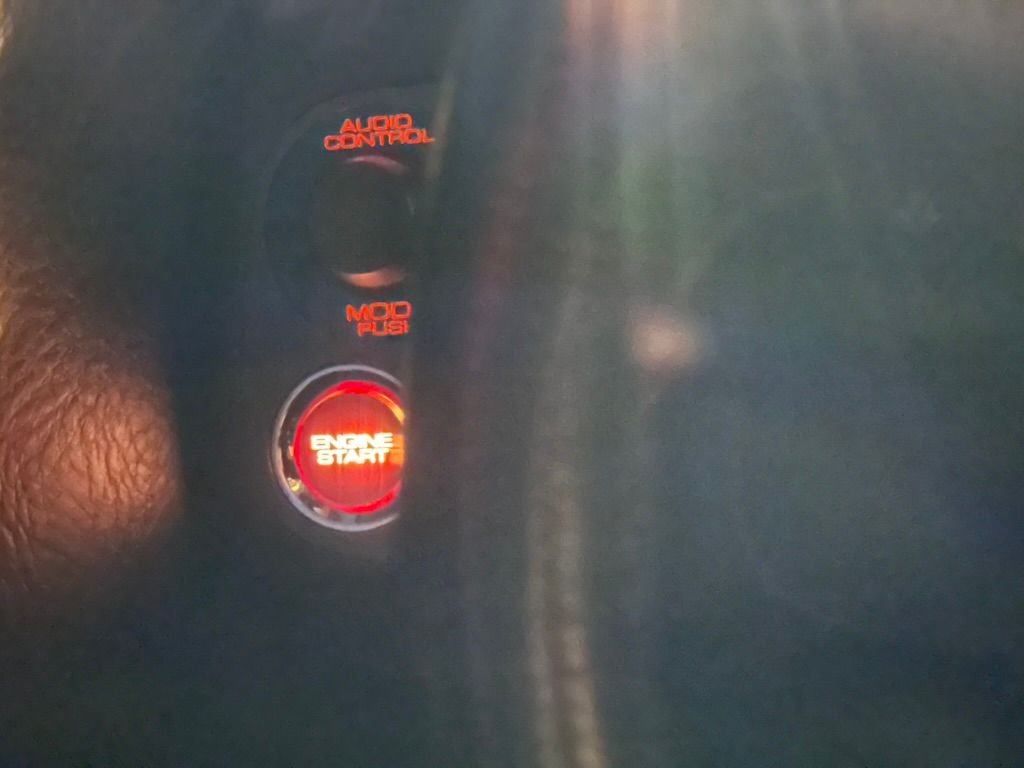

There's a rubber coating over the bulb that tints the light. Easy to remove. I took it off, makes it brighter.
