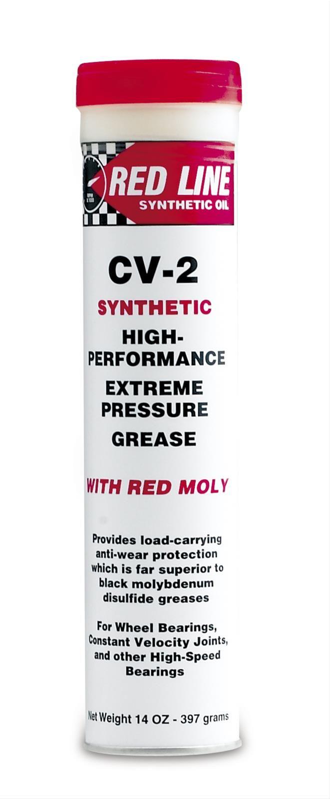

If you guys say so, I'll go ahead and find the right urea grease to buy.
But I have a lot of this stuff laying around... will this work?
