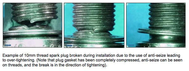

For the record, I did a torque test on a stock head and stock plug. Starting at 15 ft-lbs, I increased the torque by 5 ft-lbs each time to see what the threads could handle.
I reached 80 ft-lbs, and the spark plug threaded portion broken off the spark plug. The head suffered no damage at all.
This makes 24 ft-lbs a solid number you can take to the bank.
End quote
Quote from an article:
The Loctite people recommend reducing applied torque by 20 percent from dry values when using their liquid thread-locking compounds on threaded fasteners. You can find tables of wet-vs.-dry fastener torques in places like Thomas J. Glover's "The Pocket Ref" (inexpensive, used, on Amazon), but judging from the values given, a fair estimate would be a 25 percent reduction in torque when tightening an oiled or anti-seize-treated fastener.
Some other articles on this. First one mentions "anti-seize" as a lubricant.
https://www.hextechnology.com/articl...ricant-torque/
http://www.antiseize.com/PDFs/torque_specifications.pdf
Here is a video by NGK 2 minutes long why you should NOT use anti_seize unless you have a black oxide finish on the plug. (Not ours). They warn against everything Billman is warning about.
