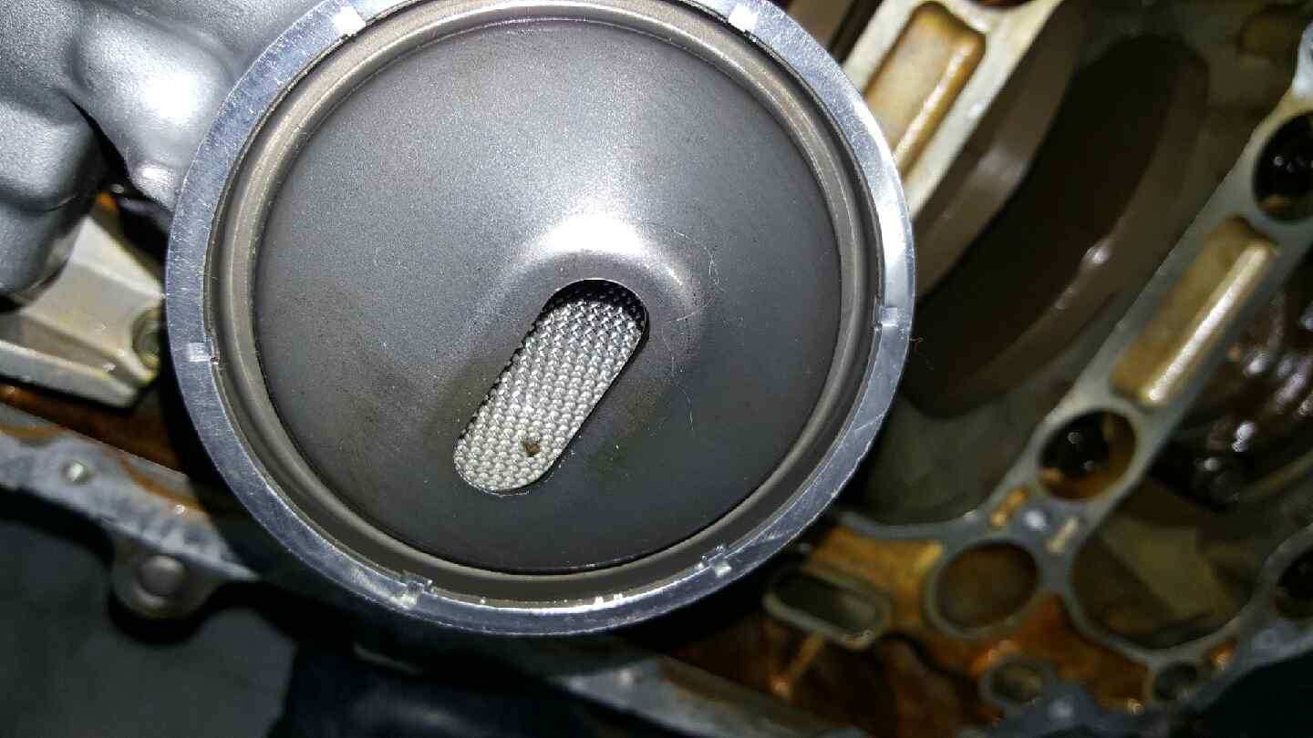

I doubt it, large/heavier particles tend to sink and collect to bottom of pan rather then get picked up by the pump pickup which hovers a bit off the bottom of the pan. But to confirm engine circulation of the shavings, remove the vtec unit and check for them in the screen. Easy to do.

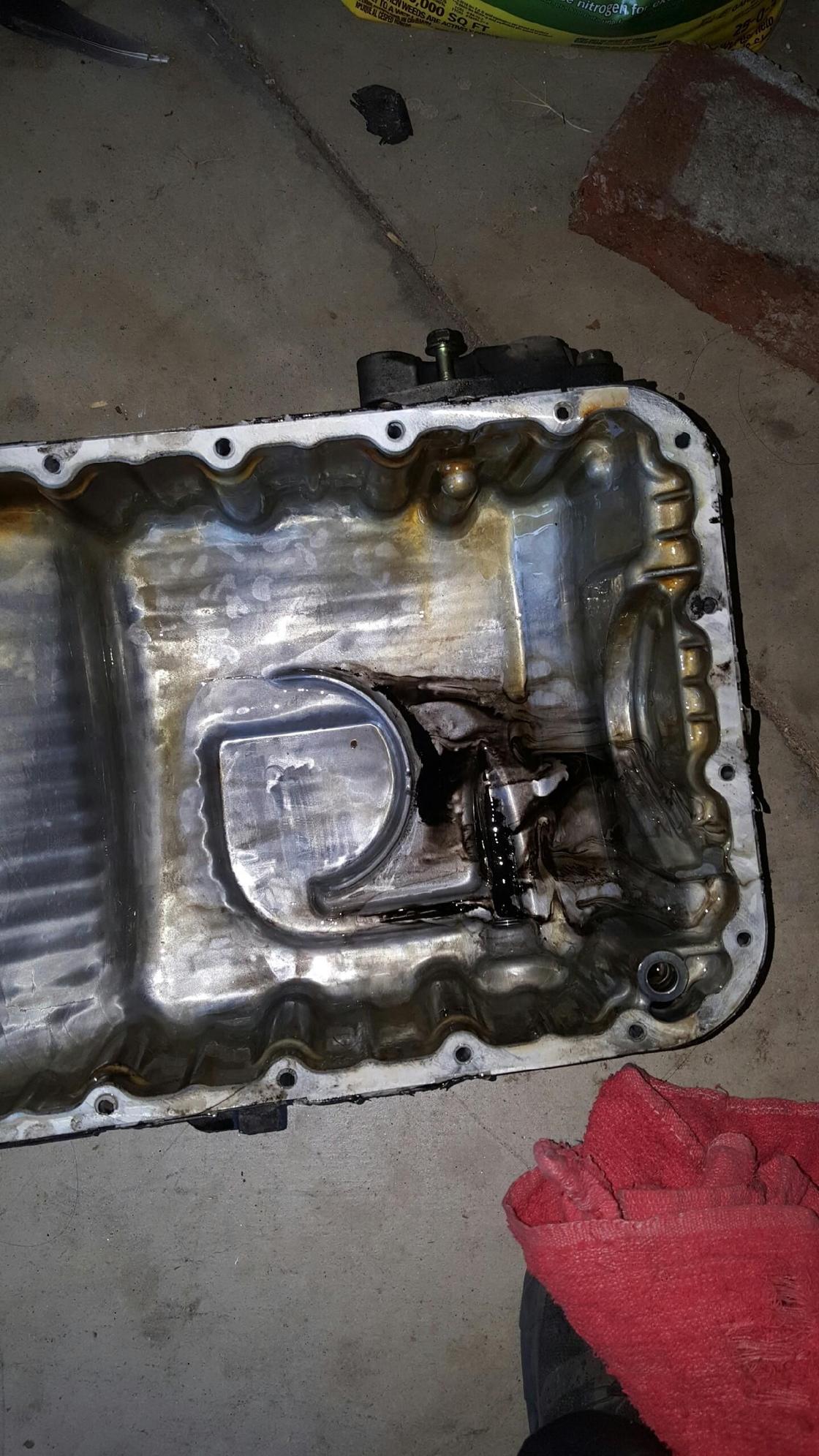

Old Apr 15, 2017 | 09:13 PM
Mexs2k's Avatar
Joined: Jul 2014
Posts: 110
Well I took off oil pan guys. The oil pick up tube has no metal shavings and the oil pan had very little to
none on the very bottom. Just that black sediment at bottom
