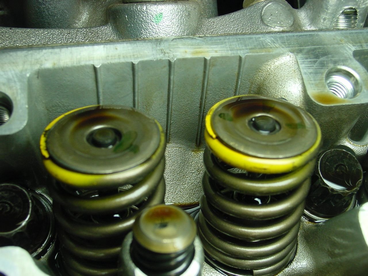

Lost motion springs are the springs that keep the middle VTEC rocker in contact with the cam during non-VTEC use.
Guides are #1 and #2, pressed into the head.
a lost motion spring can be seen here:
