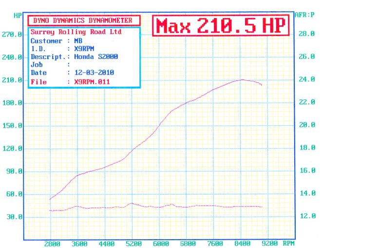

Interesting day today, as Mase did the mapping on the AEM
I managed to get the Berk decat on this morning (thanks to Triton - and to Moto-Dynamics who also offered to help) and got the J's manifold and intake on a few weeks back so it was all ready to go
I was told stock S2000's dyno about 180-185 whp on Surrey RR, and I got 210.5 (yes i'm counting the 0.5 ) after mapping which was very good.
The AFR with the standard ECU was dangerously lean from 3-5k and I would not have liked to run like that for more than a couple of days really. AFR was about 14-14.5 which is not good. Just shows how good the breathing mods I have are!

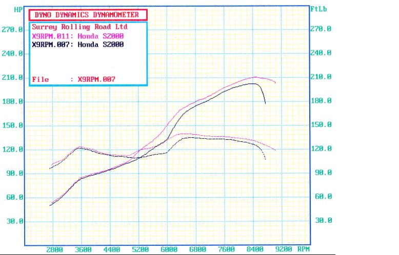

You can see the before and after dyno plot below. Note the J's mods made a good difference on their own, and the AEM is the icing on the cake.
Lower VTEC point, very smooth AFR, good chunk of midrange power and also a good bit up top.
Great day, and thanks very much to Mase and nice to meet you. Also nice to meet Lucky, Phil, Gaspode and Mans Best (with accomplice - apologies didn't catch your name)
Car drives great now Just got to get the Modifry thing for the coolant temp.

Nice, very nice.
How does it feel on the road?

Good stuff Mark, whats the vtec set at now 5000 rpm?
Who said around >20BHP at the wheel wasnt achievable on an S
Good job you didnt go with the mugen bits on this DD dyno.

Very good figures.
If I'd of thought/known I could of got figures like that with the addition of an AEM I would of booked mine today aswell!
Get yourself to cadwell in a couple of weeks and test it out!

Good results and a nice looking AFR at the end. How glad are you that you fitted the intake now?
Are you still on a stock exhaust, so things may change a little if you upgrade?
