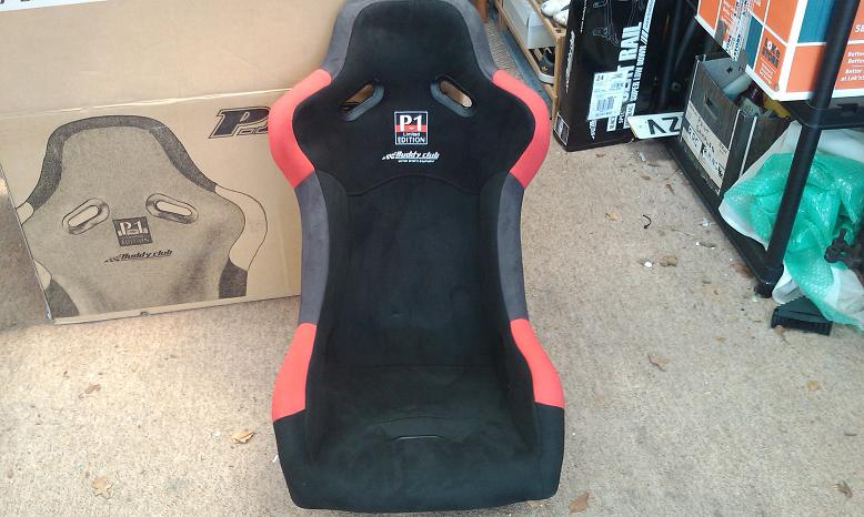

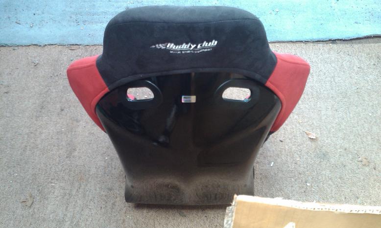

Ok so I chose in the end.
It wasn't easy as every seat seems to have some sort of issue, and you just don't know what will or will nto work.

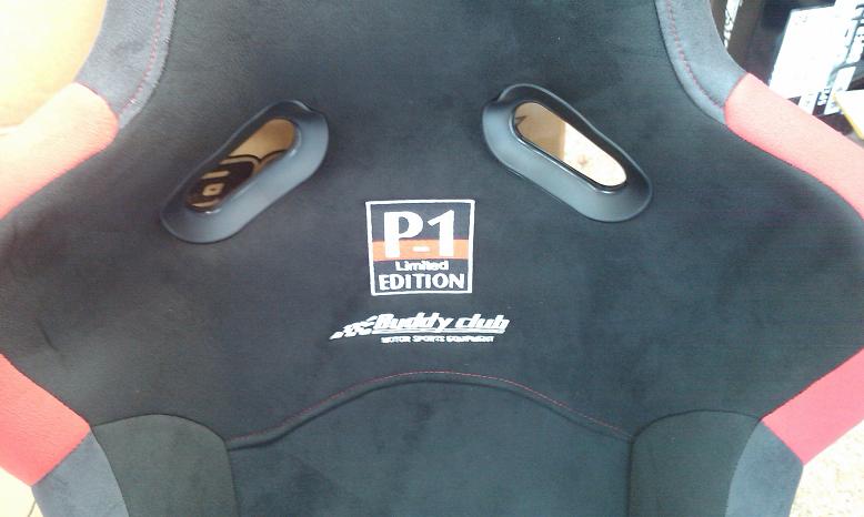

Thanks to advice from Redun, Polemecist and J8mie, I decided on the Buddy Club P1 seat. I wanted a Recaro SPG but I susepct it's too narrow for me. The Pole Position seemed to have a big issue with blocking access to to the seat belt clip too.
The Buddy Club P1 I went for is the larger size, so it's going to be a tight fit in the car (although a few people on here have managed it!)
I will detail the installation as usual, as it seems to be a very fiddly job.
Some pics...
Some pics...

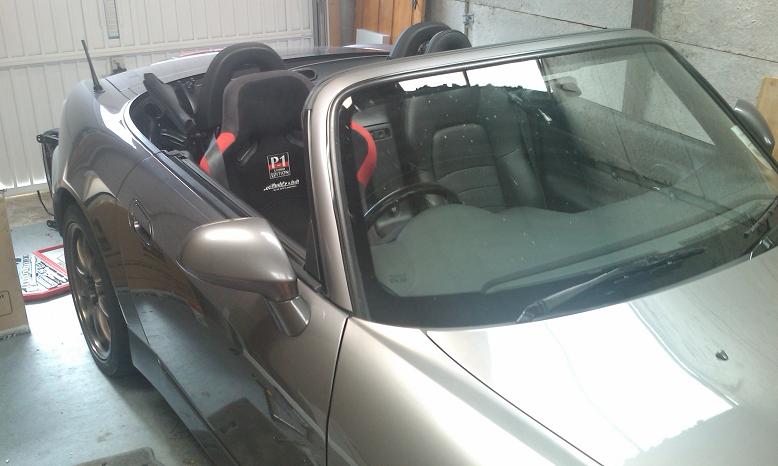

Ta Jay. All fitted now.

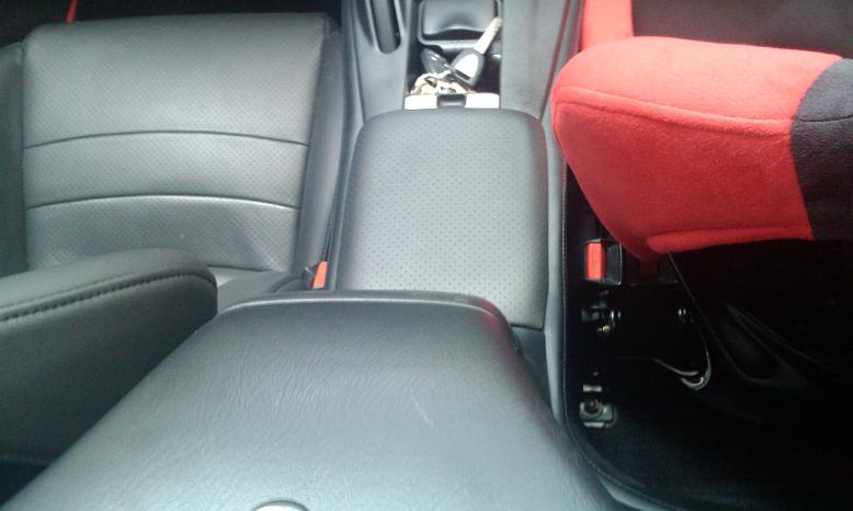

It's probably a 3 hour job fist time. The end result is very good overall, although I do feel that this seat is probably a bit too big for the S2000. You can see in the pics how it just touches the door, and it gives it a little nudge when you close it. The other issue is that where the left hand bolster is hard up against the centre tunnel, the seat won't adjust forwards now. Not a problem for me as it's in an optimum position and will adjust back, but the Doris can't drive the car now
I'm going to see if I can get some sideways adjustment on it but that will cause further issue on door closing no doubt!

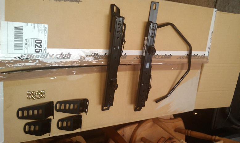

Here's what you get with the BC seat rail kit. 2 rails, 4 brackets and the bolts.

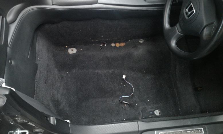

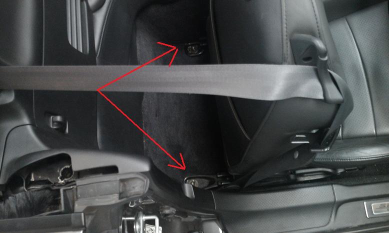

First step is to unbolt the OEM seat, there are 4 bolts, 2 front and 2 back. Loosen these off, then unclip the electical connector under the seat for the seat belt alarm.
Seat removed, look at all the loose change

Now after a lot of dicking about, I found the best method was to install the rails to the new seat, suss out what height it needs to be, then remove the rails and loosely bolt them into the car. I don't think there is any way you can install the seat and rails together, as there was always one bolt hole which wouldn't line up - especially the front left one. It's important to leave all bolts loose as you can actually get to them all with the seat in.
Also fit the seat belt clip which was removed earlier. This just bolts straight onto the rail.
In the above pic you can't see the side mounts fitted. The short ones go on the front and the longer ones at the back.
