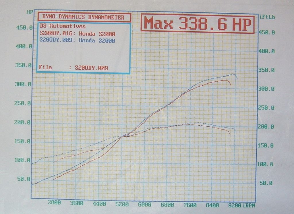

If you look at dyno graphs of SC'd cars, they make peak power at 9k+ rpms. They don't make much out of VTEC, then they surge to redline. I just don't know where one could drive on public roads to utilise the power.
My car hits VTEC at 4250 revs and I have never had a problem using the power
HTH

Indeed: that the SC is fighting against the limitations of the VTEC system means the car does have useful extra torque right down the range.
Lowering the VTEC point allows the SC to work far more effectively and avoids the almost dangerous surge & 6000 RPM.
Either Turbo or SC; it's the VTEC which causes the limitations to the tuning, not the FI itself.
Although I'm still prejudiced in favour of NA for throttle response, it can be pretty good on either FI if correctly set up.
Still a lot better than many a 'production' car with FI though...

Can some enlighten me?, I cant understand why so low with vtec engagement on the supercharger (esem's) unless you have a tubular manifold too?, is it to stop the surge of power when vtec engages???- I know too low on N/A and you'll lose power swapping over to the other cam too early.
My car is obviously N/A but my vtec is set at 5200rpm (was the best point i tired on my car for power and smoothness no vtec jump ) but i have a aftermarket tracysports manifold etc.
Punchdrunk, your statement doesnt make any sense unless I'm reading it wrong for your reason of fitting 4.77 gears.

This might give you an idea about the vtec effect on Rotrex supercharged cars. There's more than enough boost below normal vtec. So if you bring the vtec down the powers there if you want it. If you stay off boost you stay on the low cam at whatever revs.
[media]http://www.youtube.com/watch?v=G_WfFLJ2Gz4 [/media]
