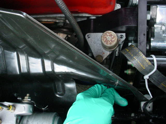

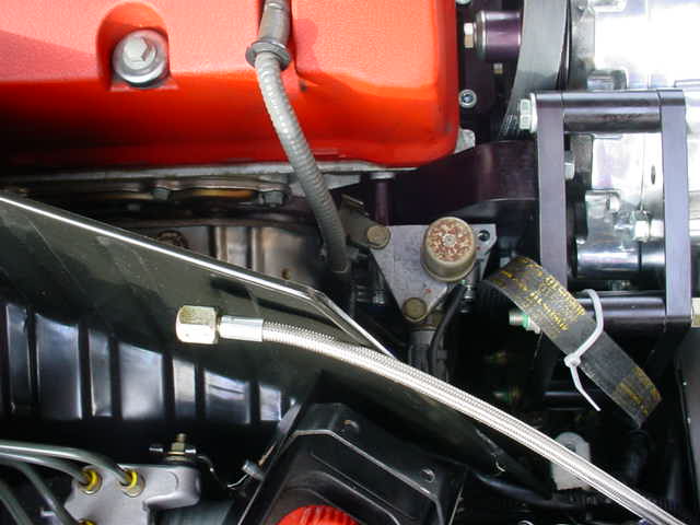

See here from my SC install:
Best to remove 3 bolts on the heatshield and tilt it upwards, that allows you to get onto the 2 allen bolts. You need an allen key with a head on it that allows you to unbolt at an angle, or you will be there all day Unclip the sensors from the VTEC assembly.

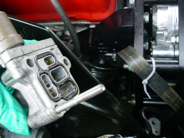

VTEC assemblt removed, you can see the rubber O ring which seals up against the SC support bracket. Underneath the support bracket is the oil pressure sensor, which is threaded into the block. Removed with a 15/16 socket.
