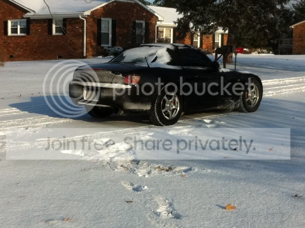

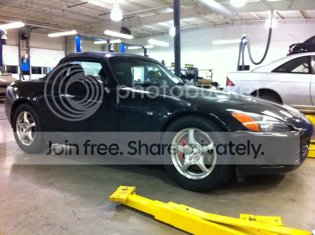

Originally Posted by josh7owens
I love the topic of snow tires. It amazes me every winter at how freaking well my car does in the snow. I've climbed up hill that two seconds prior trucks got stuck on and had to back down and drive a different root. I've yet to get the car stuck and trust me I've tried very hard.
Love these two pictures! It even looks like a tank!
225/60/16 square bro!
Any problems with ABS at this tire size all around?
What wheels were used with these tires?
Is that with stock springs/shocks?
