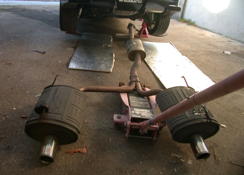

So just finished remounting the exhaust.
amazing how easy this gets the more you do it

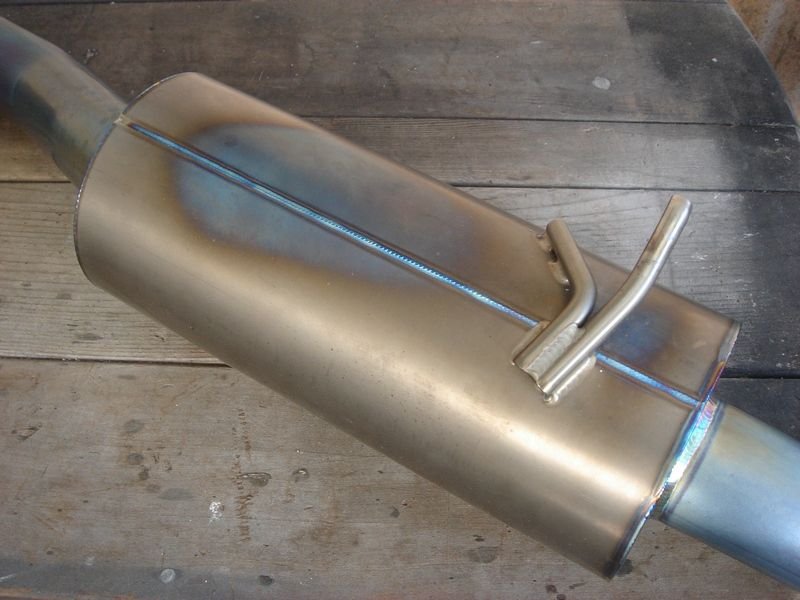

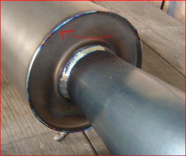

Here's a couple shots of the re-welds:
first one he ground the edge down and pulled the guts out - then welded the edge back together
nice welds

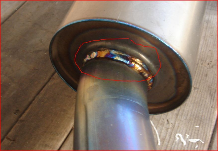

that didn't get everything , so he had to cut the other side open at the pipe
again beautiful welding.
this hot spot was caused by the bad packing that wasn't held inplace very well...
the gap was wide enough for the exhaust to get through to the surface
Chris replace the crappy packing with some nice stuff and tied it in place with ti wire.
he really over did it - he's a pro

--- not shipping packaging...
e-glass exhaust packing... the stuff inside the muffler.
J's doesn't use high quality fiberglass so it burns up pretty quickly.
plus (unlike the picture above) they don't over lap the seam so the exhaust pushes through the gap and burns the canister (like the hot spot picture earlier)
