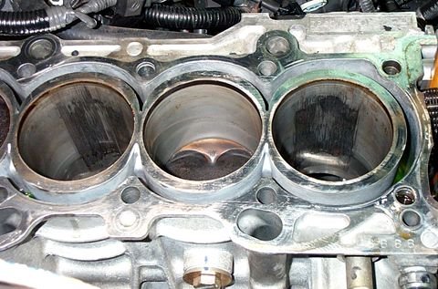

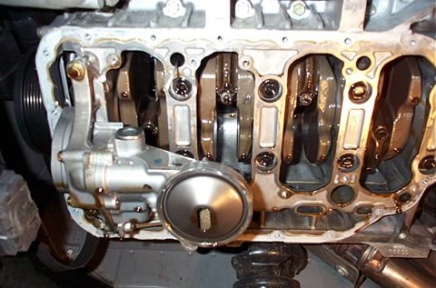

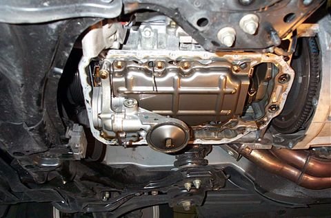

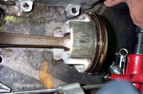

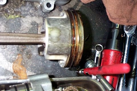

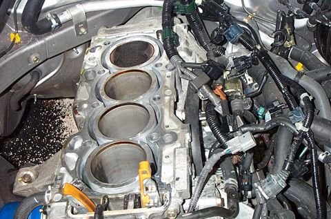

I have some photos that I took today and will be posting it tomorrow when I get a chance. Basically they jack up the car and open up the oil pan area then work their way upwards. They took out parts of the connecting rod and found nothing wrong majorly. They slightly check out the engine wall and found nothing. Tomorrow they are going to take the whole engine out and tear it apart. They told me it seems like #3 cylinder have the most sound coming out of. However #2 cylinder seem to be the most badly scratch of all 4. When they open it up there was this burning smell coming out from the engine. The service Manager Stacey is currently on a vacation and won't be back until next week. So far Honda Canada has promise to cover the expense of opening up the engine but not the damage itself. I am aiming for a final response by the end of the week since my insurance is still going on while they sit and try to figure out what they want to do. I have to wait at least another month for engine parts anyways so that's 1 and 1/2 month the car is out of service for me.

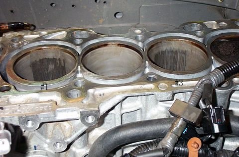

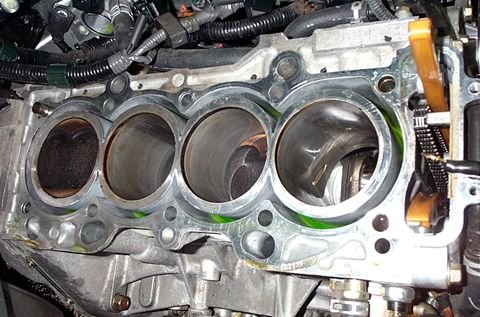

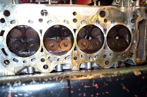

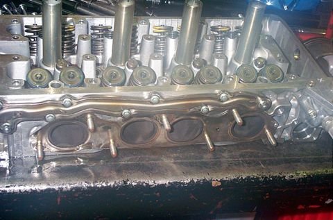

Just got back from Carter Honda. The mechanic says the 1st and 3rd cylinder is experiencing a condition call scoring. The head when they took it out appears to still be lubricated by engine oil. Everything check out fine says the mechanic. The mechanic says my engine could need a new short block and pistons. Carter Honda said they call the hotline and Honda Canada will be sending someone or will be calling the mechanic on either next Monday or Tuesday.

Here are the photos

More

More
