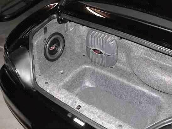

I tried a number of powered sub enclosures (bazooka, infinity, etc..) and was not happy with any. So I designed my own 8" enclosure and installed an amp. A single 8" sounded great - so I made an enclosure for the other side also.

btw, nice job on the custom sub enclosures - how'd you do it?

The enclosures are a fiberglass shell with MDF laminated to the front. The shape is an exact mold from the passenger and drivers side of the trunk.
I think you would be surprised at how well a good quality 8" sub with a good amp hit - even more so with a pair of 8's driven at 2 ohms by a mono-block amp

The picture looks so sweet and takes up so little space... I may have to bring the pic to an installer and see if they can duplicate it the install.
I was looking at the Kicker Solobaric L7 8" subs. They seem to handle a ton of power and require very little cubic volume to pump out bass.
Your amp and sub look like Rockfords. What are the exactly? HE sub? Punch HX2? Power HX2???

He has a damn good point. There is very little respect out there for 8" subwoofers. Most people seem to think that 10's and 12's are required to get a lot of bass...WRONG! But then again, it also depends on what results you want from a subwoofer. I have two 8" JL Audio 8w3 subs in my MR2 and would never go with a bigger sub accept maybe 10's in a different car! You set a pair of 8's up properly, and they will drop very low and give you a hell of a lot of bass...most people have no idea how much! Now if your goal is to rattle all your nuts and bolts loose as quickly as possible or to shake the car next to you, then you need a pair of 10's or bigger.
NICE INSTALL!!!
