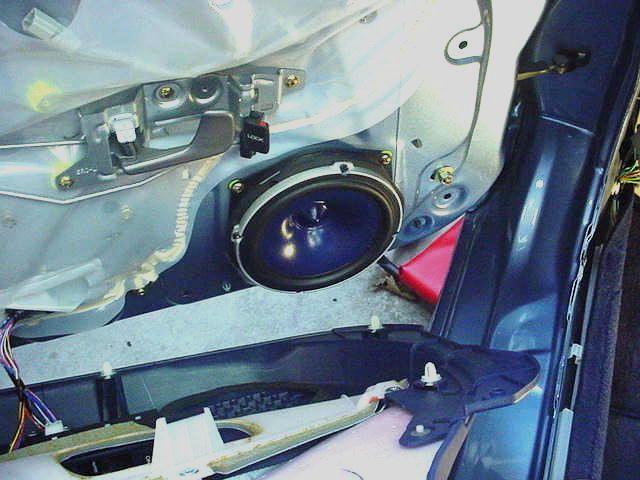

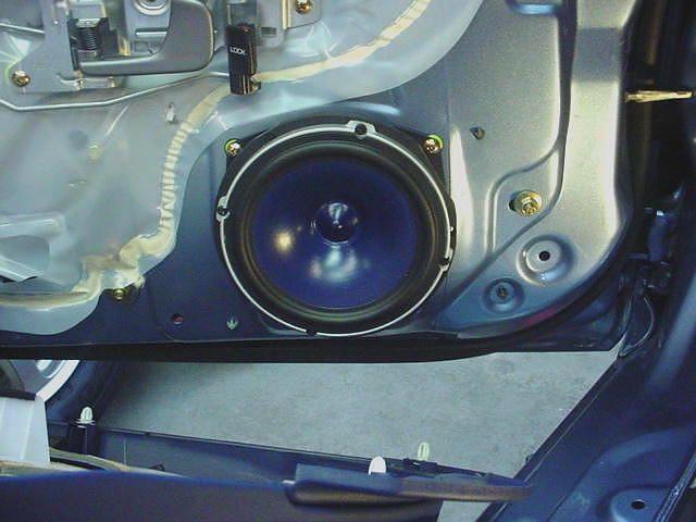

I have the Alpine type-x speakers. You will need to trim the back off the stock basket and if you use your car as a daily driver you should as Jawknee said protect them.
Old Nov 14, 2005 | 03:59 PM
darkknight1999's Avatar
Posts: 11,288
From: Hopedale, MA
BTW sorry the pictures are so bad... course those are about 3 years old with a camera I had just bought.

That's more information I need. I appreciate it alot because I was very concerned on the mounting depth and it doesn't look like a alot of room there. Those pics give me a great idea what I'm in for.
