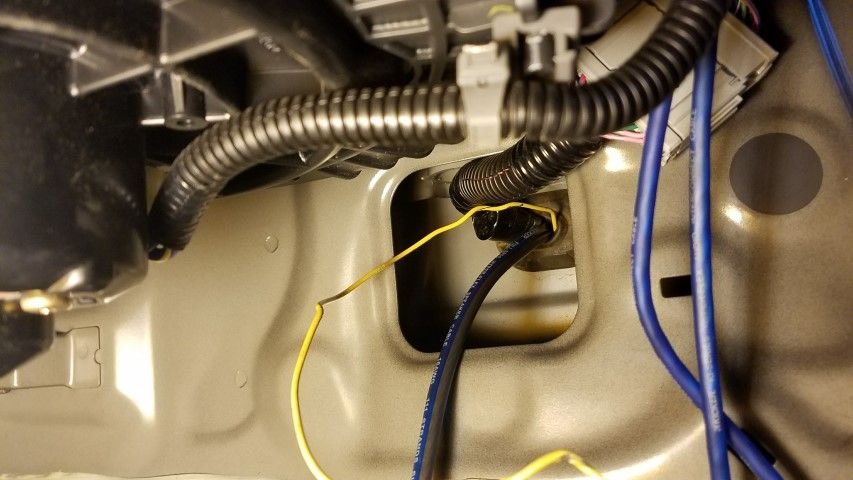

Ok, I just pulled the passenger-side speaker wire. Definitely use the blade/razor method, keeping the grommet intact. The pictures below are a little deceiving, as the area you have to work with is pretty small! Take the advice of @InsaneInNC and put the windows half-up so that you can get to the wire once it's pulled through. lucid mentioned to take the seats out which is a good recommendation. I didn't do that, but in hindsight, it would have made access a lot easier (especially if you're a big guy). There's not a lot of room to move around on the driver's side because of the steering wheel.
Passenger-Side

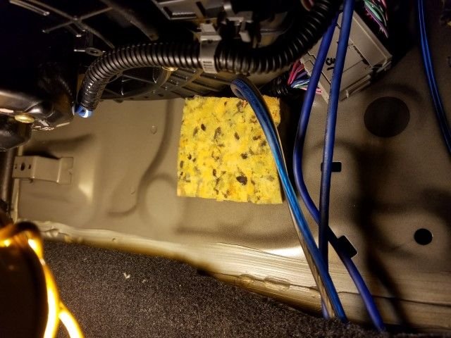

Remove the square foam insulation
I used the coat hanger method. I made a loop and tucked the 16 AWG wire under the loop. I used packing tape to keep it secure.
It's thinner and slides better than rubber electrical tape. Also, less messy. If I did it again, however, I would also use the wire lube stuff to pull it through.
Use an Exacto blade and make a thin cut. Be careful not to cut the existing wires! I gently kept cutting at it and used a needle-nose pliers to pull the grommet material apart. By the way, make sure your coat hanger is straight (I straightened it up after this pic)

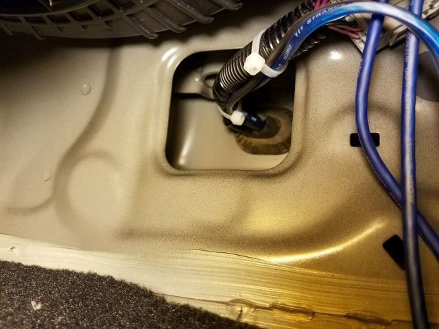

Here it is coming out on the other side. As others mentioned, watch those sharp edges!
On the side that you originally pulled it through, I zip-tied the speaker wire to the existing cable assembly. This will keep it in place and away from the edges of the opening.
Put the foam insulation square back in...half-way done!

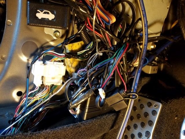

So, when we buy used cars, there's always "surprises" here and there....here's one of them. The previous owner(s) did a crap-job with installing an alarm in it. There's no less than 3 boxes in the wiring mess that are connected but not active. So yeah, I'll be careful down here.
Removing the foam insulation square

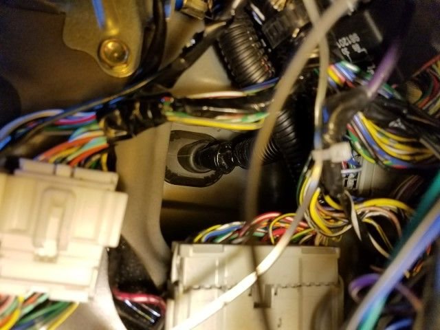

Use the same method as before. Here is the other side, in the doorwell, behind where the speaker basket was. Success! You can see the bent coat hanger and wire. Cut the tape, bend the hanger back straight, and pull it back through the other way.
